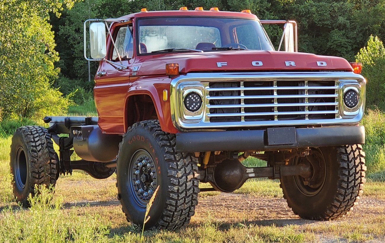

Here are some pics to fuel the fire. I believe they all have the same cab dimensions, between a F100 and F550. Now yes the DASH is different in F550 and up. And yes the complete front clip on the F550 and up is different. Plus the F550 doors have the thumb push button open instead of the lift handle like on 73-79 F100-F350. The guy to ask is Chris, https://www.ford-trucks.com/forums/member.php?u=517820 He is super nice guy and this is his truck below. And he has a 79 F250 SC.

cab mounts are in a different spot..you're not going to easily swap SD series cab onto 1 ton and lower frame
