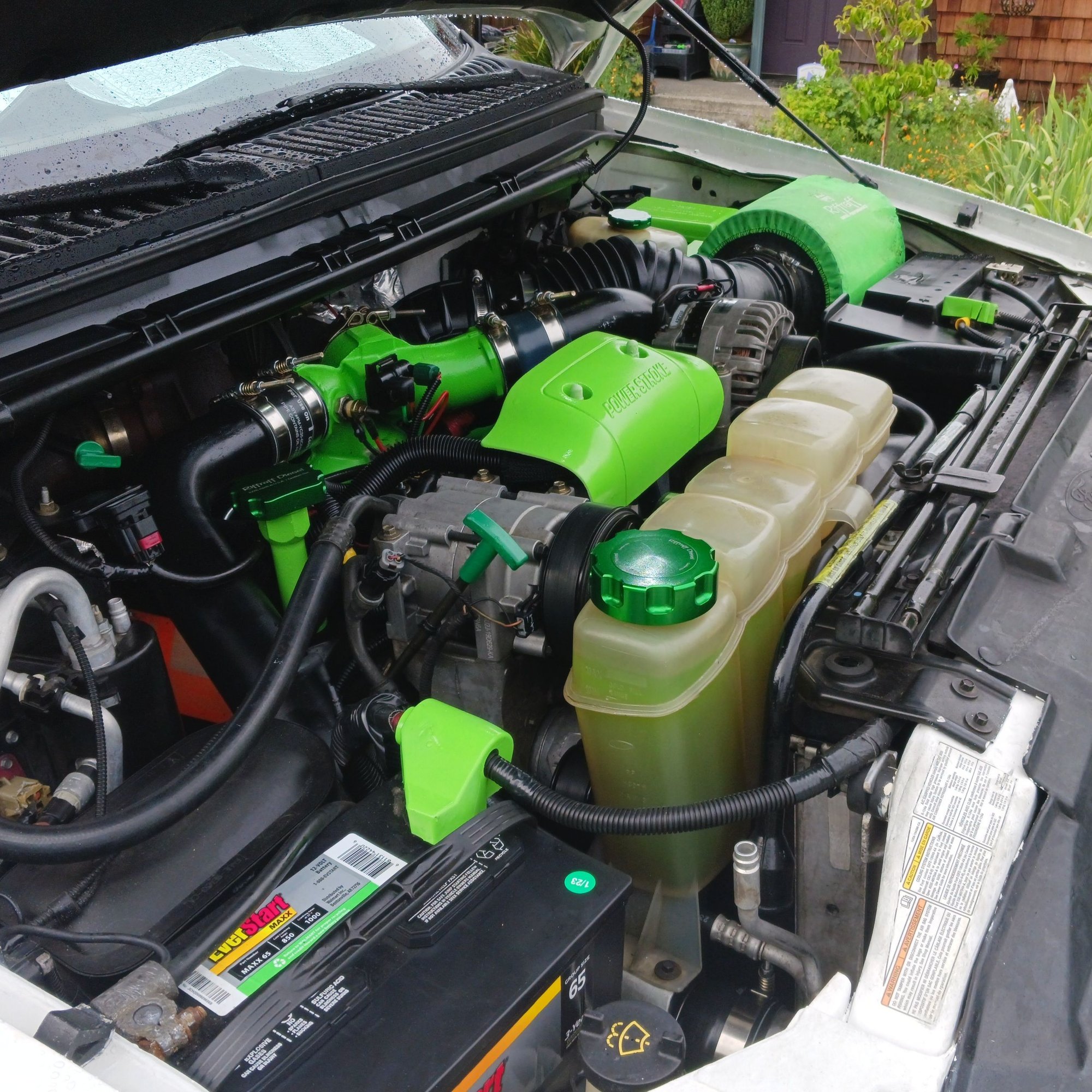

This sucker right here!

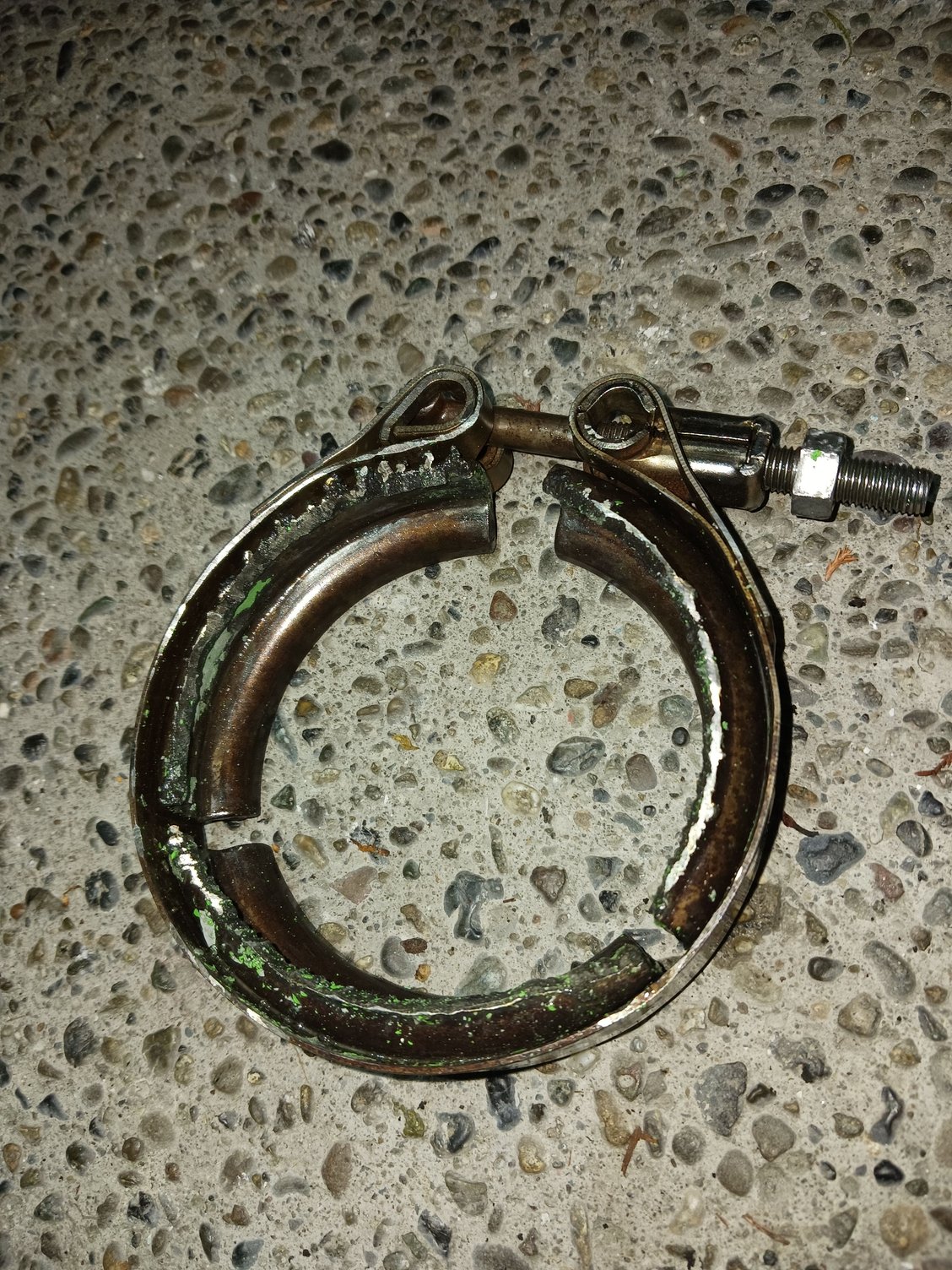

UPDATE

So I return hat in hand to you gentlemen... you were right. I'm not sure if it was just the placebo affect making me think that removing the eBay part would make it run better, but that wasn't the culprit. Fortunately I got all my ducks in a row!
Fuel Pressure is golden! 67 at idle and around 52 at WOT. No more fiddling with that damn regulator for me!
Oil Crossover IS installed! More embarrassment here... it wasn't where the fitting goes into the engine, it was where the crossover connects to the fitting that was causing my leak. The reason I couldn't see it is because it was only happening under acceleration and not while idling... I found this out by using my bore camera while I went for a drive. She was gushing up a storm!
Last but not least, the main issue I was having problems with, the lack of power... so it turns out that my V-Clamp (see pics) that was holding the spider to the turbine housing was absolutely shot and causing a massive boost leak. I got the proper one on there from RiffRaff now, and got my power back!
On a side note, I feel even more like a d**k cause a couple months back I was giving a guy a hard time for what I thought was just a standard wormtail clamp (like the stock ones around your orange plenums) he had holding spider/turbine housing together because my V Clamp didn't look like that, and the beginning part on the proper clamp does have the wormtail clamp appearance.
So if you're reading this, sorry guy!
Anyways, just wanted to follow up. Thank you gentlemen for all your patience & assistance! Until next time, keep on 'Strokin!
The old clamp all chewed to hell.
Yeah, that wasn't cutting it.
New clamp!
New clamp!
I think maybe you figured it out but the old clamp you’re showing is for the back of the turbo. What clamp do you have on the back?
Good question. I am guessing the PO got the clamps mixed up when he was gutting the EBPV, I'll bust out my mirror in a moment and see what the dillio is.
