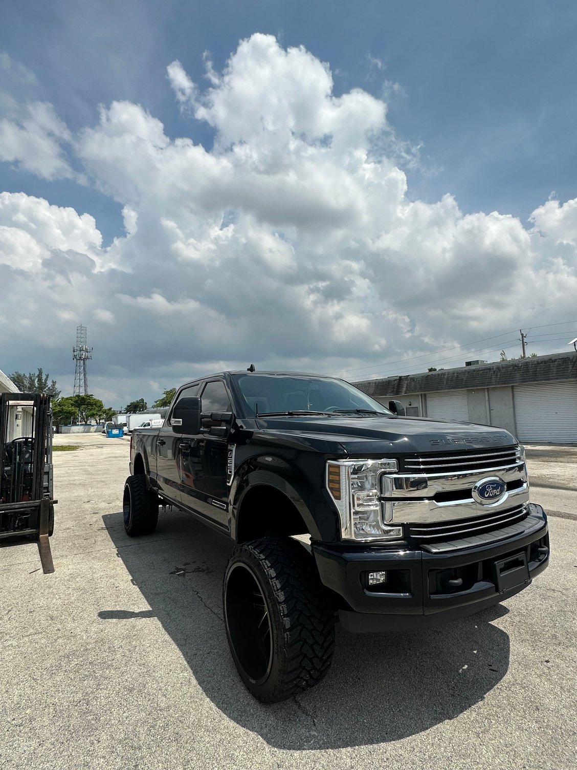

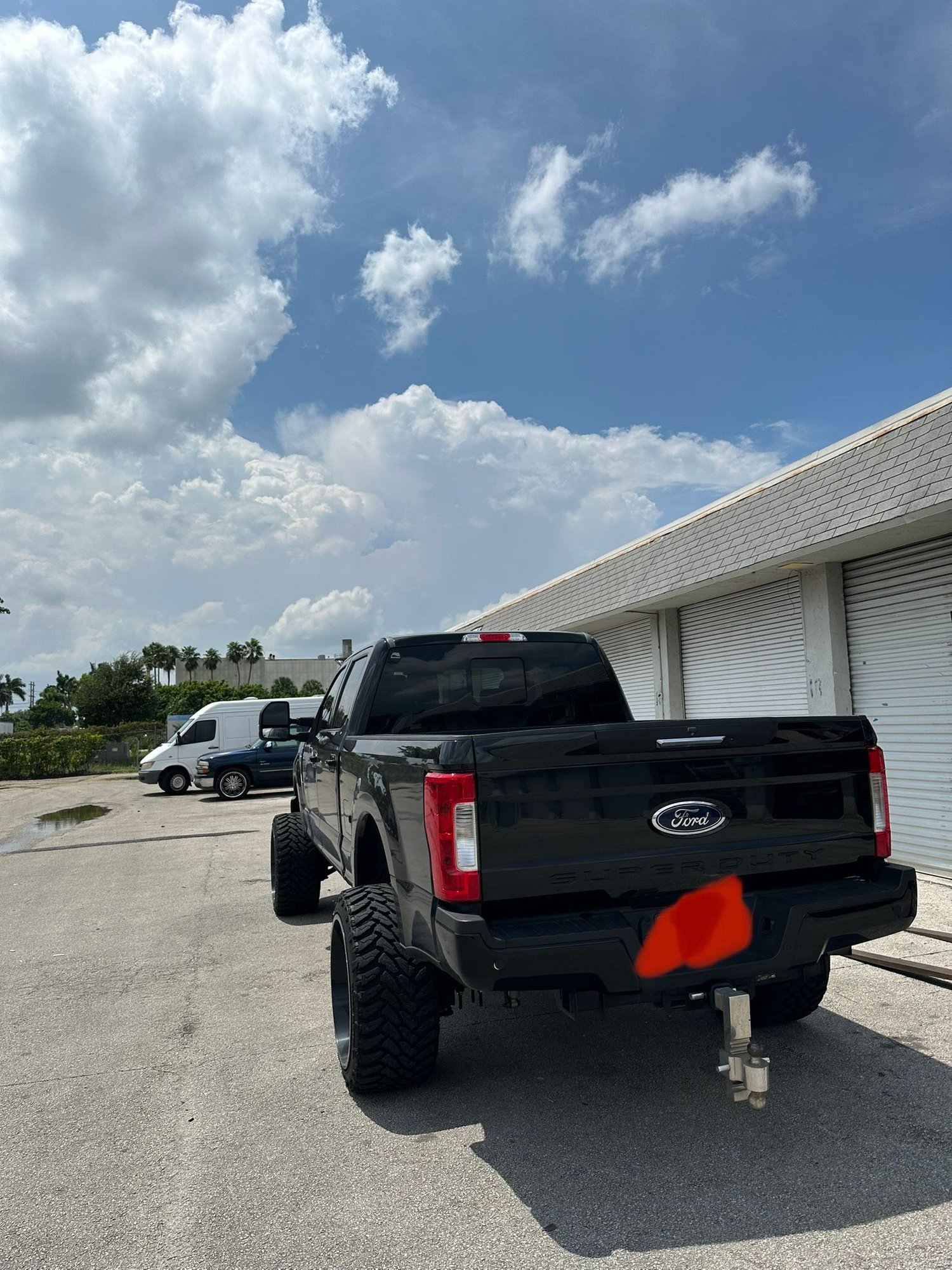

My trucks wheels are uneven due to rear axle being narrower. I’m wondering what size spacers will even the rear wheels with the front.

its hard to tell there is a difference

not the best angle, but you can tell. Maybe it’s just me looking to closely lol.

That is by design. Every vehicle I have owned has a wider front track width. There is a reason for it. If you don't care why it is like that and just want a certain look, there are slip on spacers you can buy. You probably can't go much over 1/2" without changing to a longer stud.
Ford lists front track width at 68.3, rear 67.2. So 1/2" each side in the rear should get you just about perfect.
