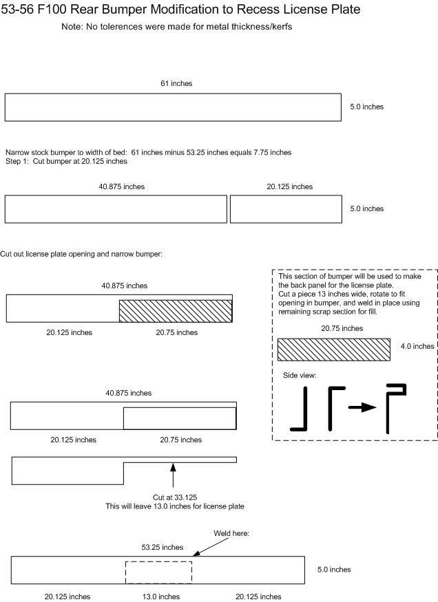

Sorry BJ, no pics but I am going to build another soon. That one I built previously caught the eye of the owner of a truck that I was painting so I sold it to him. I am going to make a drawing of the mod... my bumper looked exactly like the one in the photo except it was the width of the bed.

Here is a quick drawing I worked up showing how I modified a stainless bumper for my 56. I narrowed the bumper to the width of the bed and added a recess for the license plate. The metal on these SS bumpers is thick so care must be taken when welding.

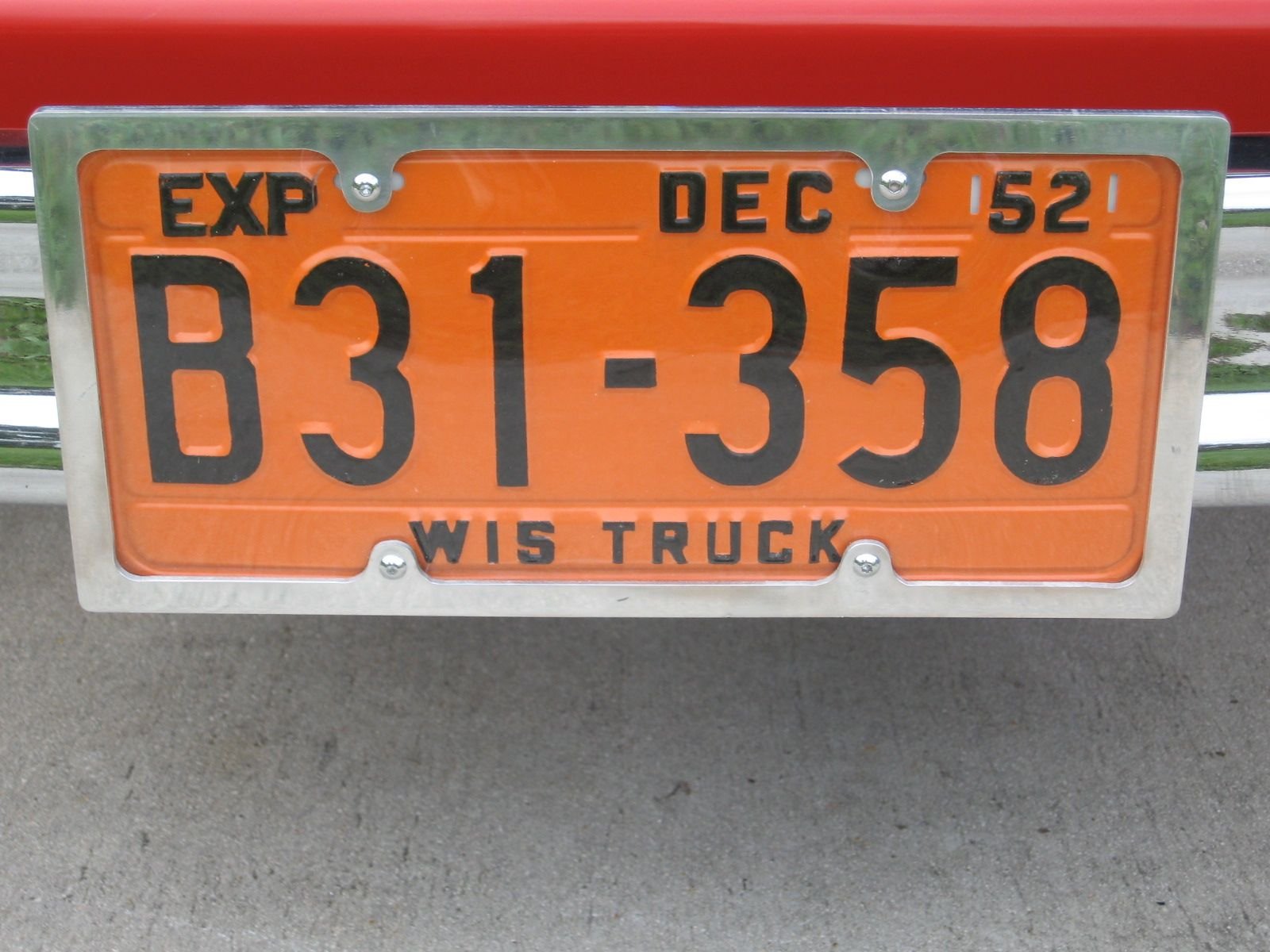

plate frame
Make one on the mill . Not 6 x 12 . Old plate is 6 1/4 x 13 5/8 . It was a manual mill , not a C & C .

plate frame

Good looking license frame.

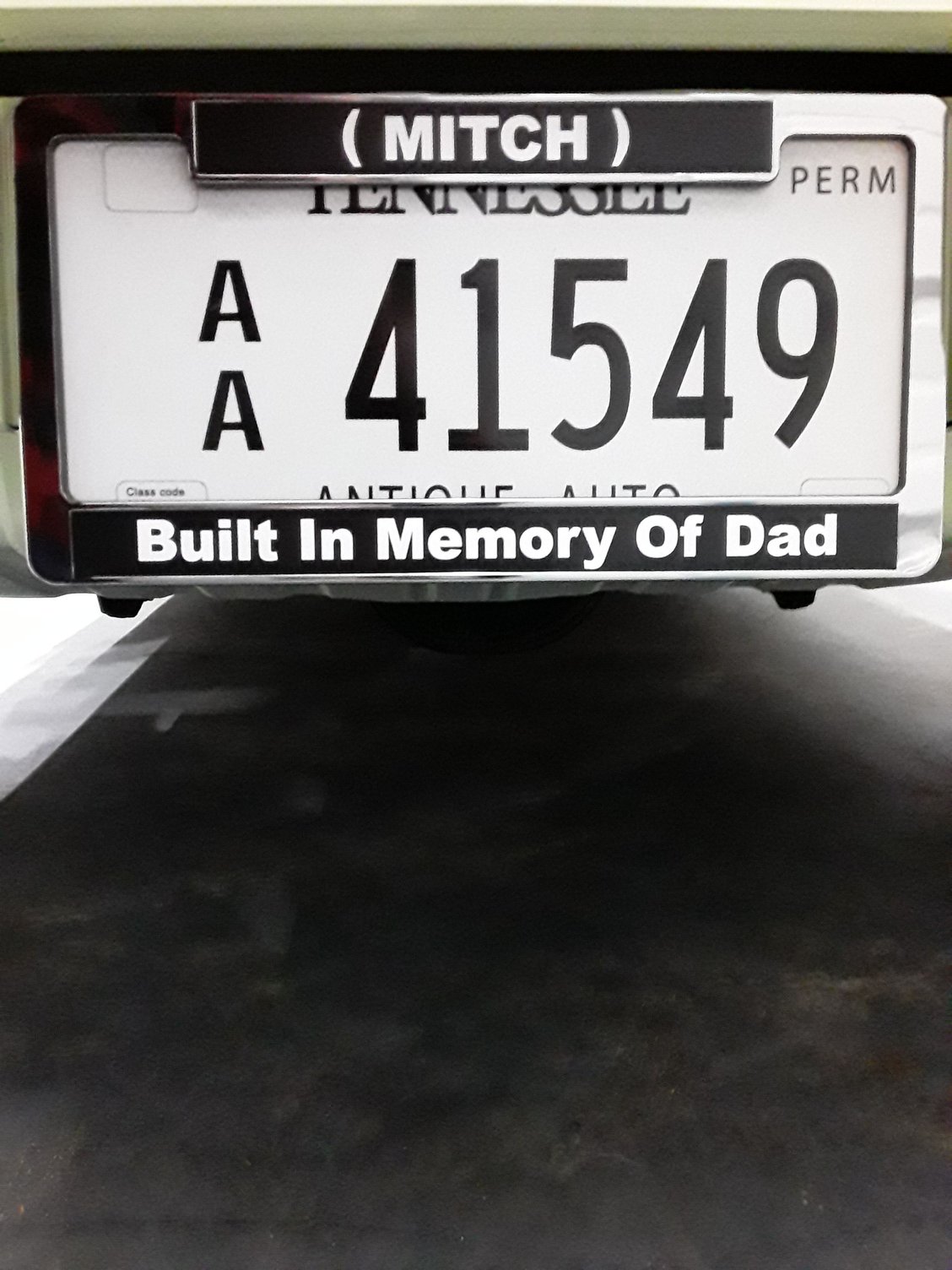

I found a place on the web that makes them with any wording you want.

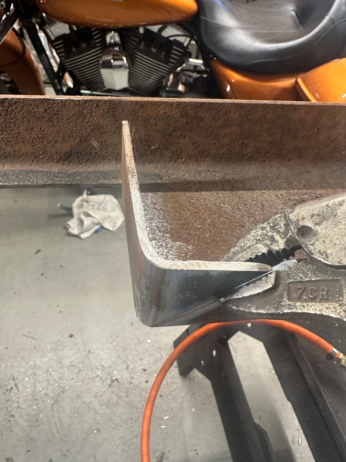

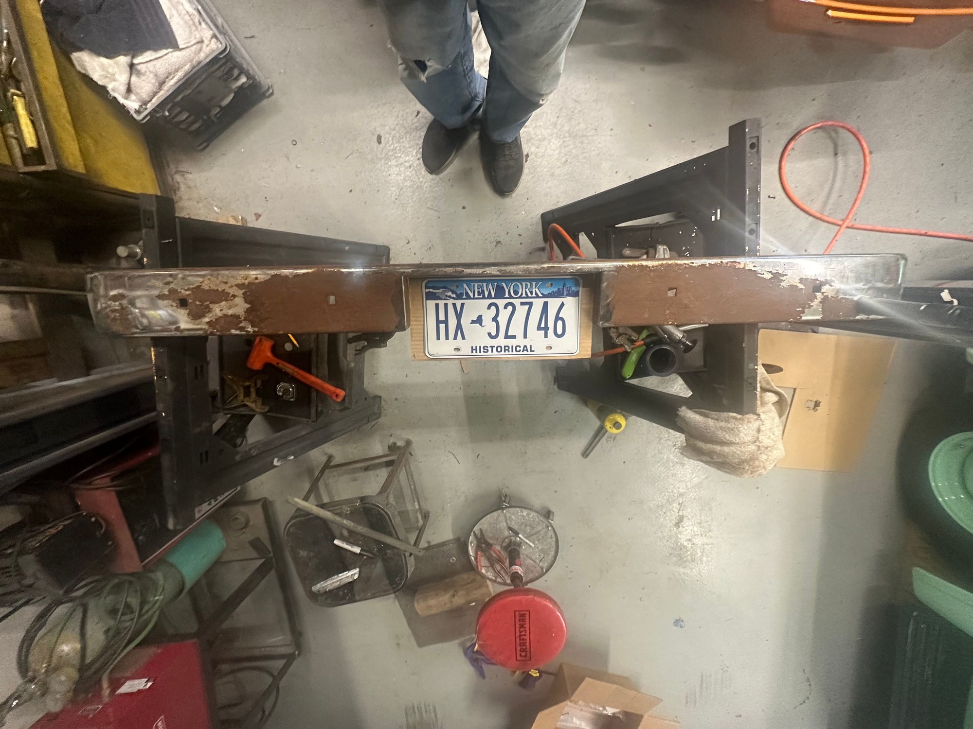

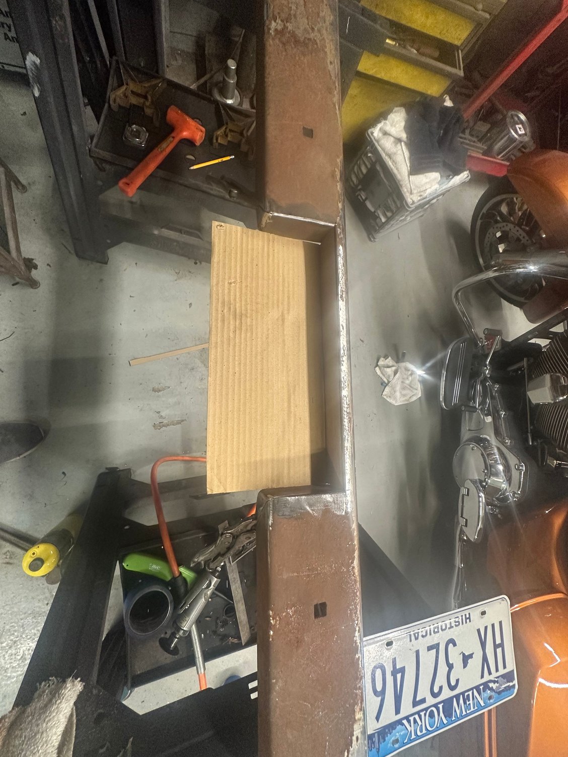

Got the old bumper and started mocking up a center license plate location, I cut 45 degrees in the returns to keep the lower bumper contour,after welding and grinding I’ll get the chrome sandblasted off and paint the satin black like I did with new one

Looking good.
It will look like new when you are finished.
What is the height of an original rear bumper?
My truck did not have one. I figure, from pictures, it is somewhere between 4 and 5 inches.
