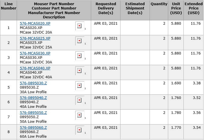

I bought my spare fuse set from Mouser.com.

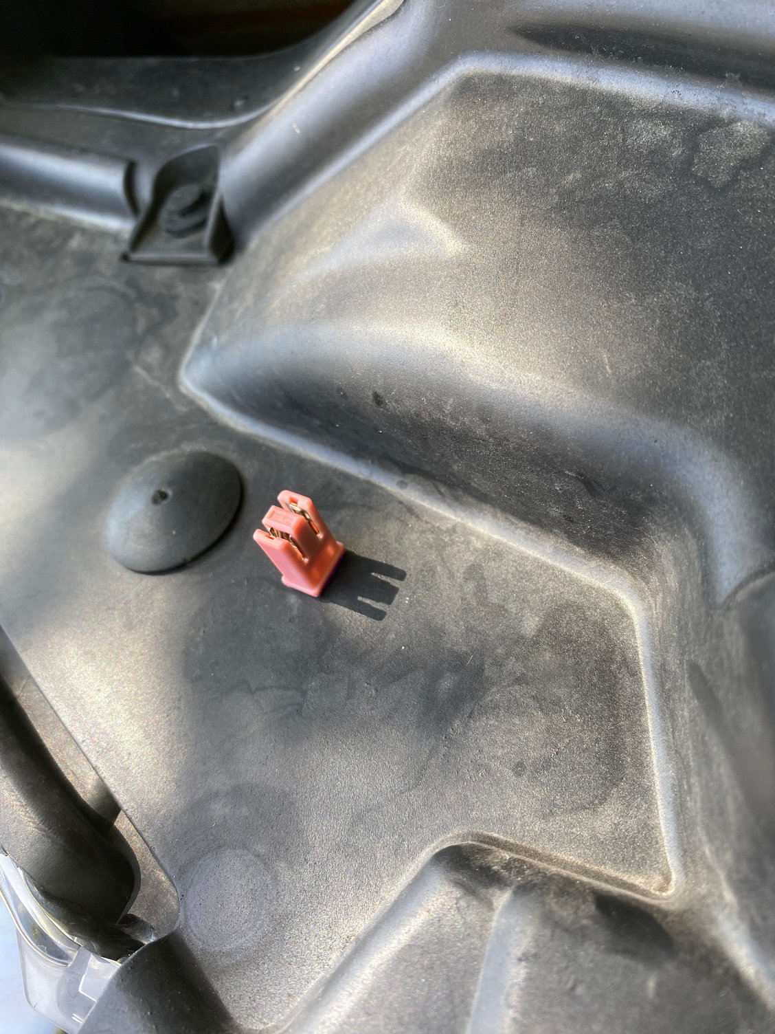

I just went to the truck to pull a fuse and show the similarities between OEM and the replacement I got on Amazon.
I know they are different amp ratings, but the 30 and 40 were the only ones I could pull with my fingers. The pink and green are OEM from the factory. The white one is from the link I posted above. No fit issues.
