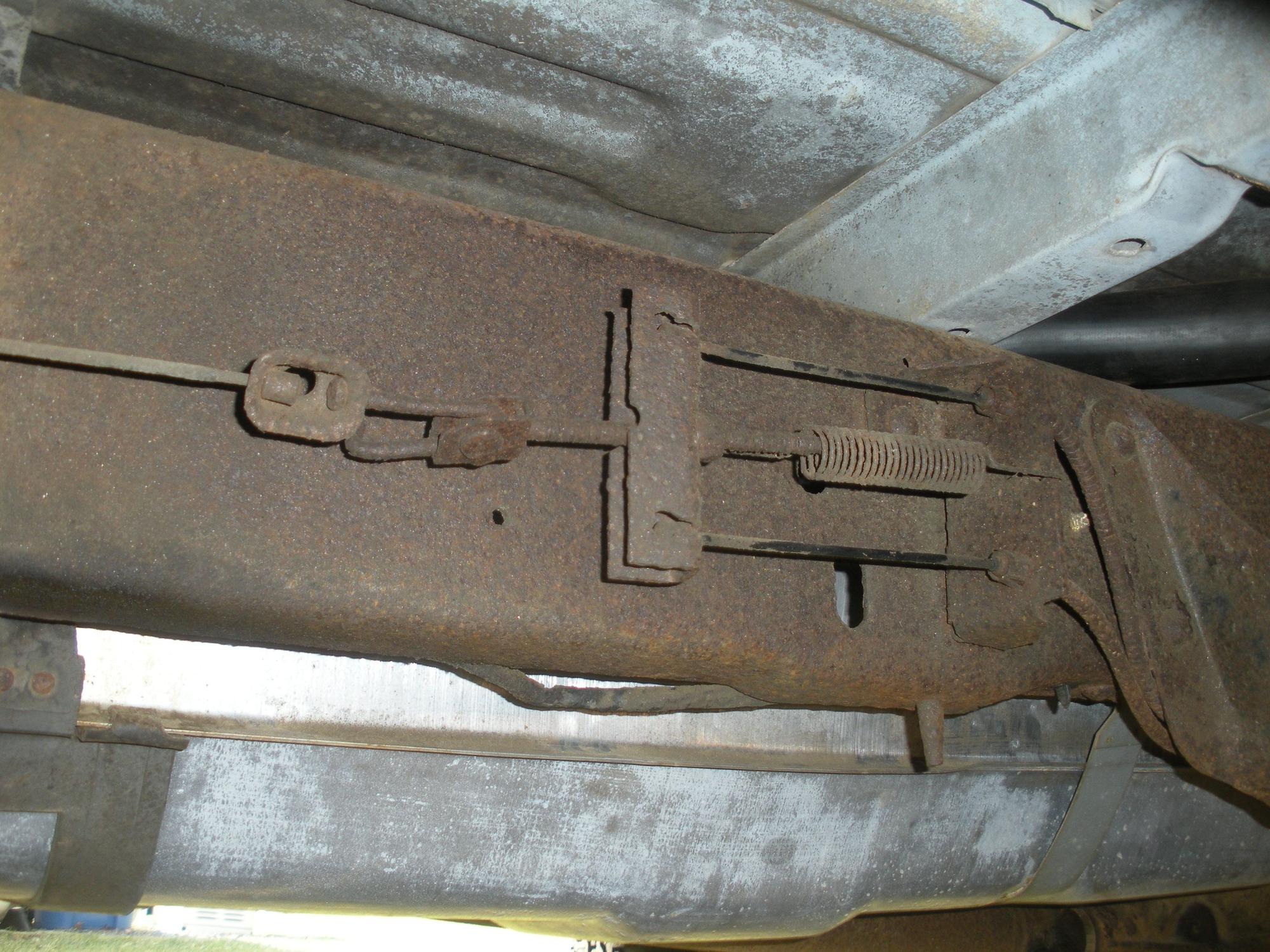

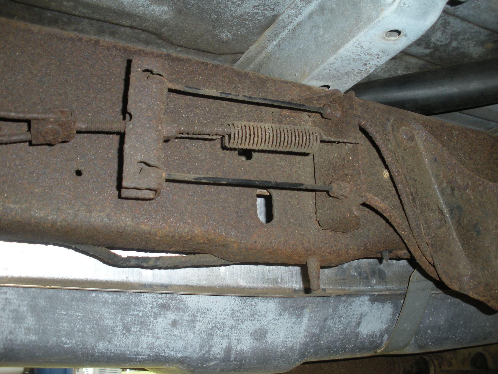

I see on Max's photos that even old originals have a slightly shorter right side, or top cable at the yoke.
