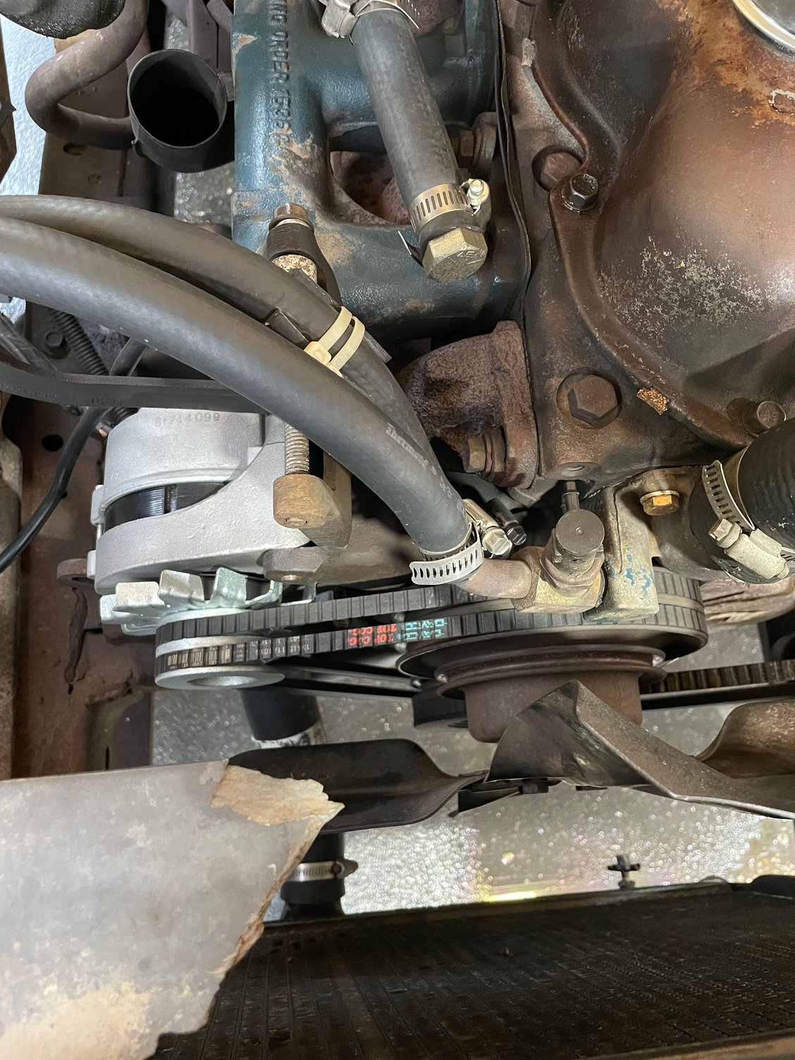

If y'all wanted to see a visual of what my dual belt setup looks like... here you go. It's a replacement, but it's identical to what went bad beforehand, and advance's computer's said it was the correct part. I believe its only the 60 amp.. but it's a stock replacement either way. Looks like I'll go ahead and pull the front belt so I can install the Saginaw setup.
