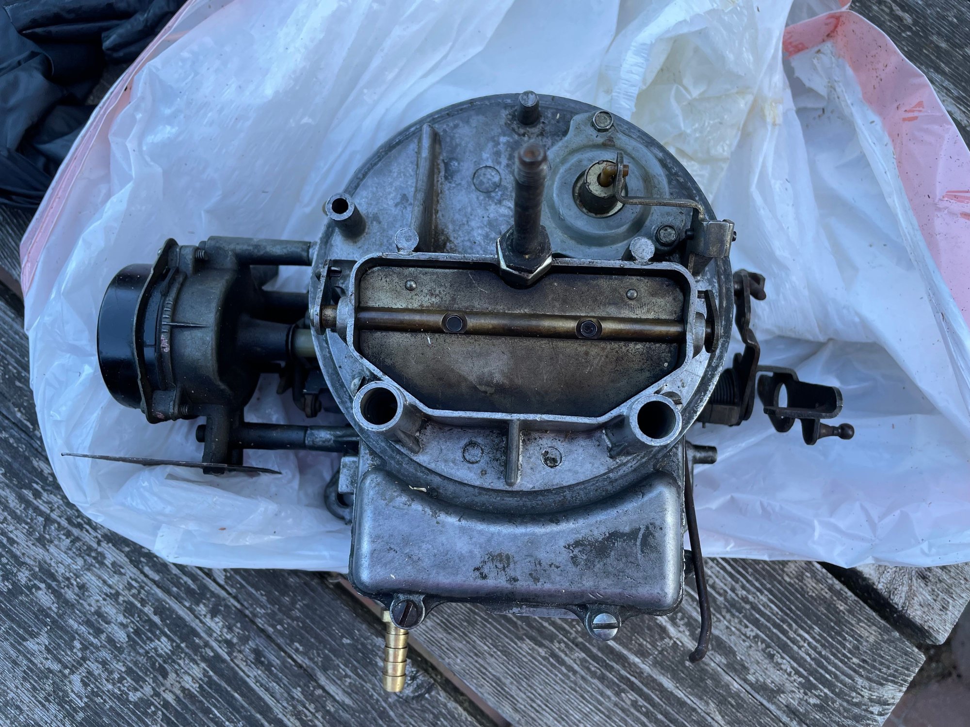

Where can I buy a new Motorcraft 2150 carburetor - made in America. Who sells them?
I have been through 2 rebuilds with terrible results. And I am not looking for a rebuild kit.

Stay away from the imported repops they're selling they're garbage. buy a new Holley 2V and never look back.

X2 on the Holley. Unless you need Venturi port for EGR. Then you can go with the Autoline reman which is as good as it gets.
1976 302 V8 right?
https://www.rockauto.com/en/catalog/...arburetor,5904
Autoline is Canadian BTW. Close enough.

1978 302 V8 Thanks for the info.

Ok you need a reman carb. thats fine, I can't help you as I have rebuilt the best one I could find and had good luck. A reman is a worn out core that has rebored rebushed throttle shaft bushings and who knows what else, your truck, your money. but is there a competent mechanic that may be able to rebuild a carb for you?

In my experience, the cost of rebuilding a carb using a professional is twice the cost of a new/reman 2150. Maybe more. Your money and decision. If you don’t have emissions, that Hollley 2V is the best carb you will find for your application. If you do have emissions, there are fewer choices - I recommend Autoline. Or get a new 4V intake and sky is the limit.

I just had a 2100 rebuilt by Wright's: https://www.wrightsfuelsystems.com/
Did an amazing job, imho

I just put a Holley 2V on my 360FE, Should have done it yrs ago, all I had to do once installed, wait for it to get to temp , set curb idle, and tune the idle mix just a tiny bit, runs so much better ... It can sit for over a week, 3-4 pumps, boom, fires up...
