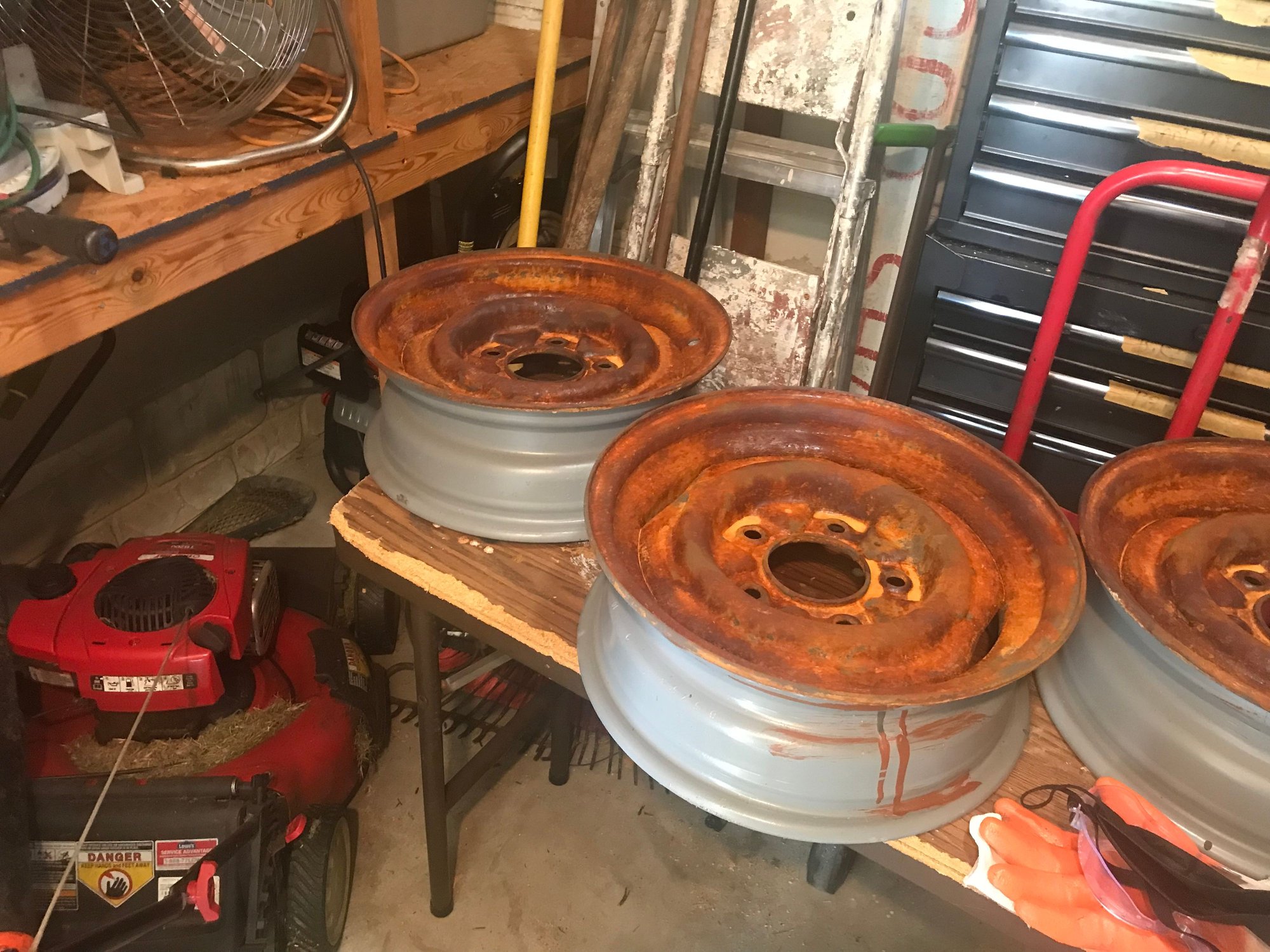

I had these media blasted and primed, just inspect what you buy.
of course then I rusted them myself for my 65 f 100 rat rod!

Those are outie wheels, though. I believe OP was wanting the original innie style? Maybe not.
