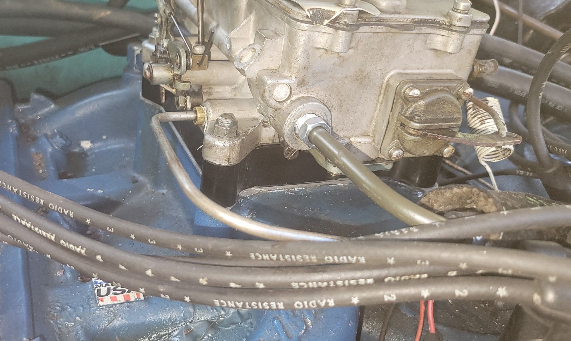

It's been a while since I've posted, hope everyone is doing well. For the most part the truck is working flawlessly, and I just get in and take off... once it starts that is.
There has been one small problem. The fuel evaporates after I shut the engine off and it has been running a while. Modern gas doesn't have the same blend of anti-evaporation additives as it did before the 90's. After shutting off the engine, the carb and fuel lines heat soak and after about 45 minutes to an hour, the gas will completely boil out. I've seen several you-tube videos on how others have attempted to solve this problem as it's common with carburetors across the board. I'm going to try 2 things:
1) an insulative carb spacer shown below. This is an original Ford piece I already had. I believe it came off of an 80's Ford truck, but I can't be sure.
The only downside is I will have to ditch the oil bath breather and use a shallower aftermarket type. The oil bath was already just touching the underside of the hood without adding the spacer.
2) The other addition is the generic "fire sleeve" from Amazon around the fuel line, also seen here. Below is another pic of the sleeve as it wraps around the distributor.
Unfortunately, when I put everything back together, the fuel line leaked at the carb. I swapped carbs thinking I cross threaded it and it leaked in the same place, so I must have distorted the mouth of the flare. It was an aluminum line, so most likely I simply overtightened it.
Has anyone else dealt with this issue? If so, what have you tried? How well did it work?

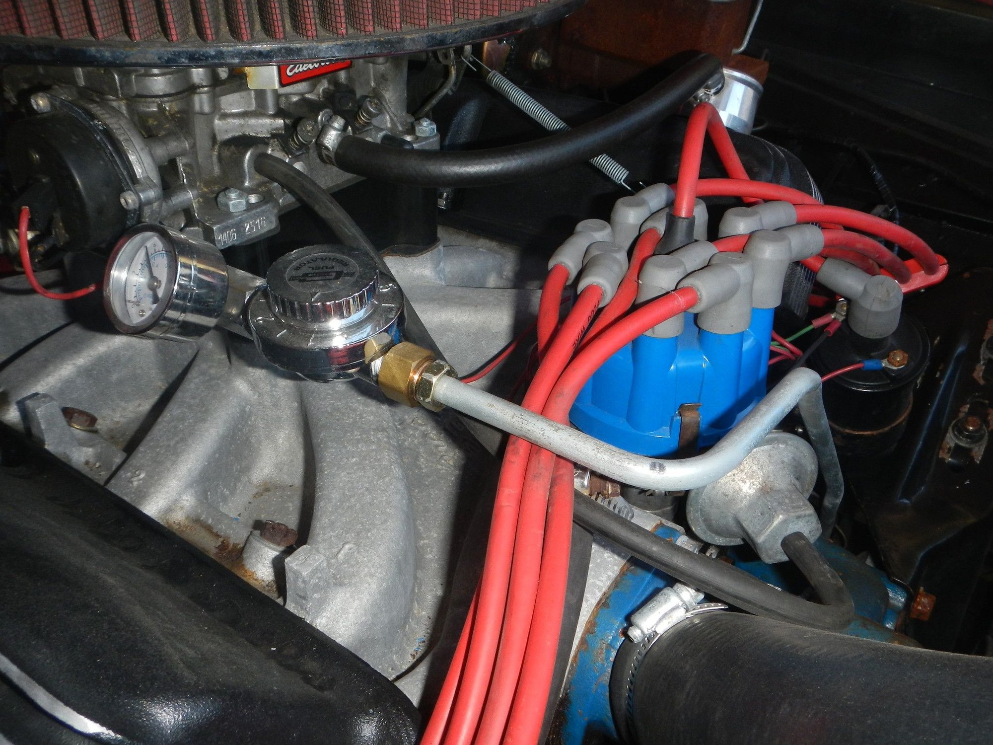

I'm using an Edelbrock Performer, not a stock cast iron intake (see pics below). I hated to lose the stock appearance of the oil bath, but I hadn't opened the hood in over a year. Drivability trumps looks at this point.
I decided to skip the 3/8 insulation gasket and go straight to the 1" phenolic spacer. At this point form follows function since I had to give up the oil bath anyway.
Not a fan of the 70's chrome look, but the drop base provides a lot of hood clearance. I could easily run a 4" filter (it's 3" now), but unless I install headers, there's not much point. Once I start going down the performance rabbit hole, it's hard to stop.
The good news is that I was able to dial in the "new" modified 4100 with manual choke fairly quickly as this requires swapping out the primary throttle shaft. The bad news is the gas now leaks out of the splice where I used a rubber hose to attach the two sections of fuel line. Before I can drive again, I'll have to make new lines with a bubble flare at the ends of each line, but that's for another day.
