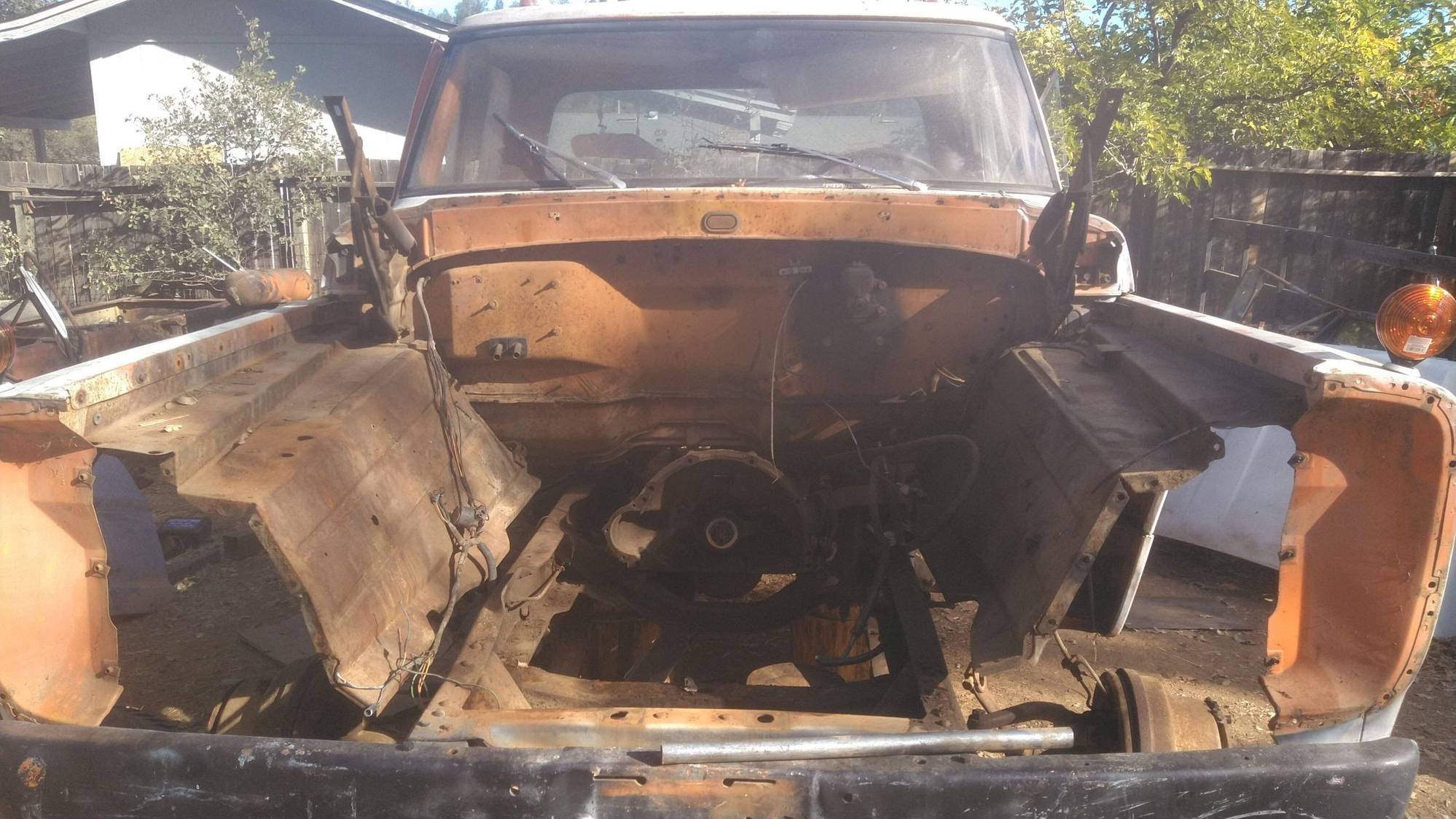

Bought this truck 3 years ago thanks to this site I got it to were it is today. I love seeing pics of everyones rigs so I thought I would share mine as well. 1970 F600 with a 330 HD. Went through entire brake system, new rubber lines, wheel cylinders, shoes and booster. New clutch, gaskets, seals and even found some 22.5 for it and all new tires. Just slapped a backyard paint job on it and put a new windshield in it. I intend to use this truck and wanted it to be as mechanically sounds as possible. I even rebuild the parking brake and the two speed motor and converted it to power steering. Really looking forward to using it and thanks again.
to everyone on this site.

Good looking truck. Like the short side dump bed.
