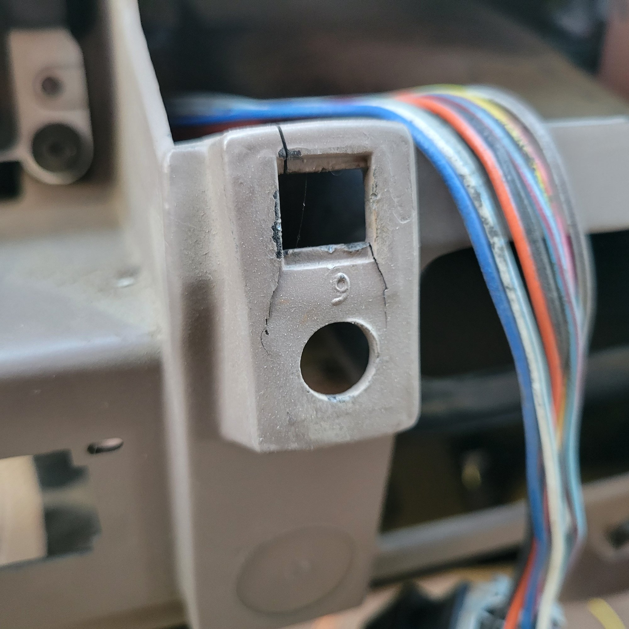

What is this clip called? Where can I get it?

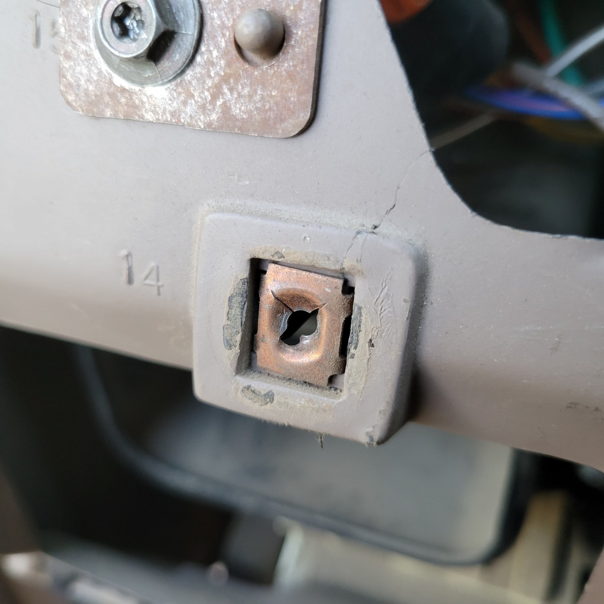

Close-up

Google "automotive snap in nut". What comes up looks pretty close. I don't know their official name.

Does not say Ford. But looks about right. IDK.
https://www.viperpartsrackamerica.co...nut-06507528aa

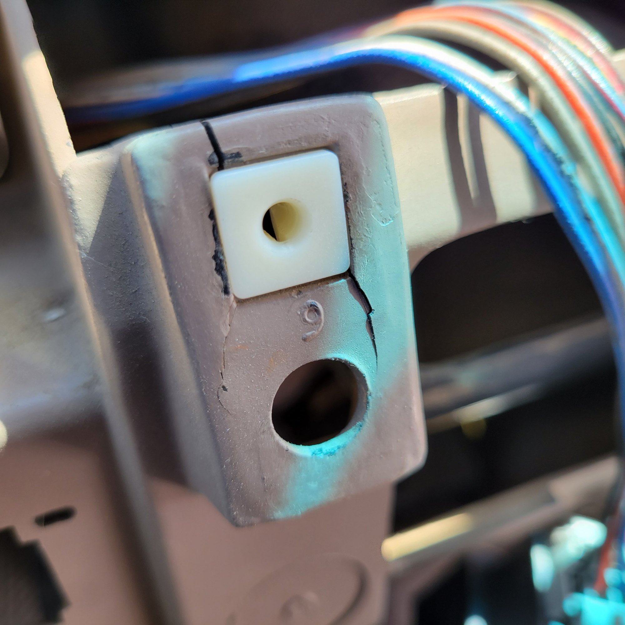

Got
Got these. You have to glue it in, but they fit perfectly. Using the same screw too.

Any
Any suggestions on what kind of glue to use to fix the broken plastic parts?

Glued up

I'd JB Weld Epoxy it

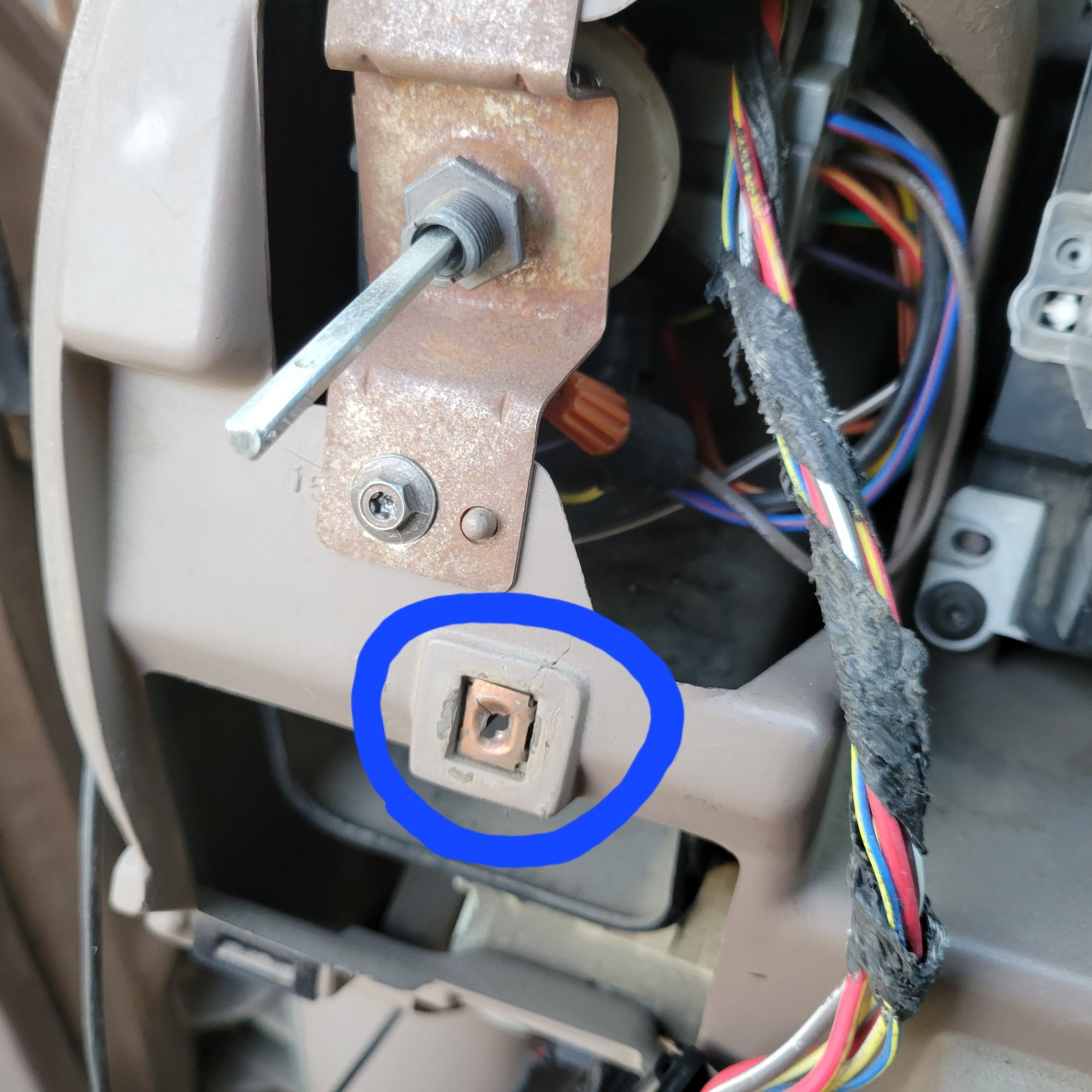

You didn't ask, but here's my advice- get rid of that wire nut. Those headlight switch harnesses are fire-prone enough even when properly terminated.
I've always been wary of how hot those get. Do you think the wire nuts are a danger? Shorting out or?

I've yet to have a need for it myself, but if that's ABS, and I think it is, plumber's glue should work.

I tried gorilla super glue. We'll see how that goes.
Yes, when subjected to vibration, they're known to either fall off or get toasty due to poor contact

It worked. Ended up using a pan head screw, maybe a #8, on the side with the plastic nut.
