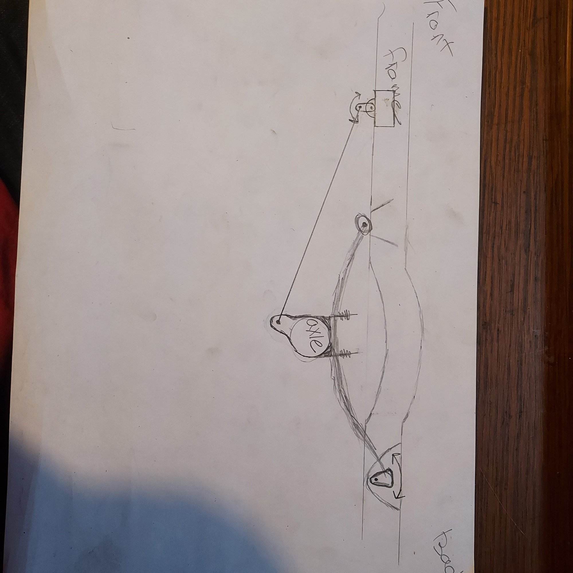

What if it were to run something like this? I'm sure someone has tried something like this. Is this the best of both worlds?

That's the shackle idea I was talking about. I know you want to build your own, and you can, but here's a store bought one. https://motobilt.com/products/tracti...ckle-mount-kit
Here's a bar that comes with the shackle. https://www.ruffstuffspecialties.com/AWKIT.html

Keep looking at the different bars offered by different companies. No use re-inventing the wheel when you make yours. One thing I think I am noticing, all the bars with the shackles are two bars per side, not just a single bar. There has to be a reason for that. If you find that is consistent with all the shackle type bars, I would copy that on yours.

Thanks for the sources. I would assume the reasoning for 2 bars per side is the it more pushes them up into the shackle rather pulling/pushing. Having 2 bars per will make it so you don't need stoppers on the shackles to help limit the twist. The axle would still be able to move up and down freely just not twist. Just my guess.

I was was wondering if with one bar and the shackle, the shackle would have a tendency to "flip" or "flop" when the axle tried to twist. Would two bars with that wide bracket on the rear axle stop that from happening?
With a single bar and one attachment point on the rearend, the one bar on the rear axle bracket would tend to pivot around as the axle twisted. But with two attached bars on the axle, one bar would tend to move forward while the other bar would tend to move back, making the front of the assembly move up rather than back, giving less tendency on flopping the shackle over on itself.
More guessing on my part also.

Yes, that was my guess. It would make sense, with the single bar it would be a push pull from the axle and with the dual bars it would be a more up down.
With the bit of reading and analyzing I've done do the arms that mount from the frame to the rear axle have to run parallel with the drive shaft?
Todays little project. This weekend I'm goingdraw out the shackles
