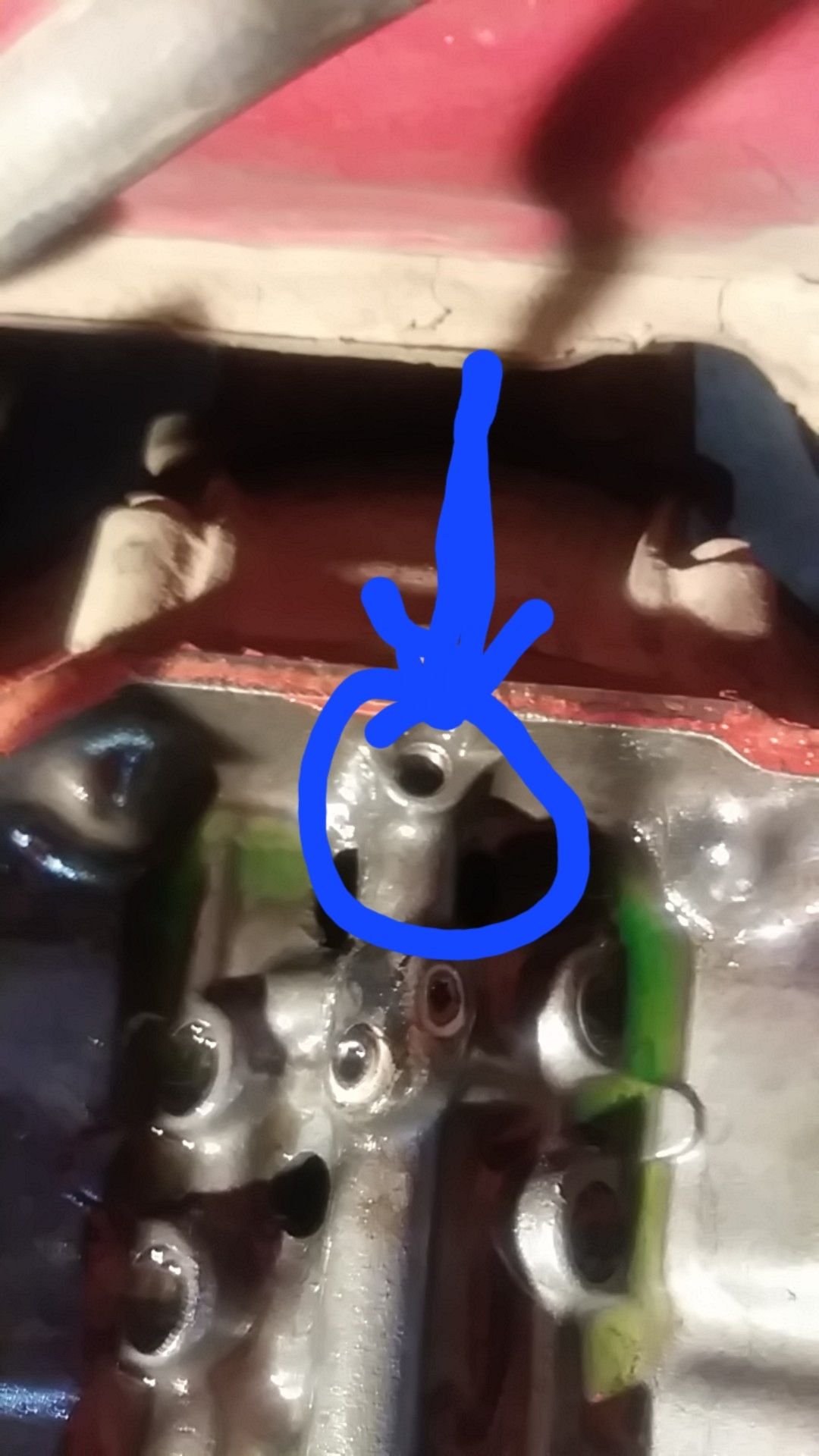

I had this exact same issue. In the valley under the intake make sure there's a plug in the hole on the back part of the valley. I rebuilt one and couldn't figure out why it was knocking. Turns out that plug was gone and the top end wasn't getting any oil pressure. If that cam and lifter is gone you're gonna have to rebuild it again. Those metal shavings had to go somewhere.

Thanks! It's due to go to the rebuilder on the 28th of this month. I'll post up what is found. I'm hoping for minimum damage, but knowing my luck with this damned truck, I expect the worst. Anyone want to buy a frame off restored 76 short box 4x4?
