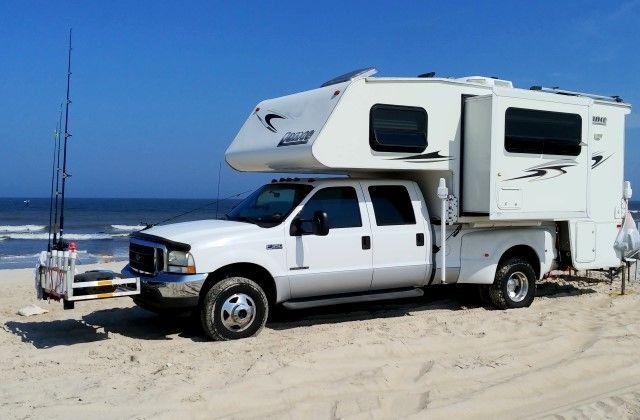

I am in sugar sand all the time with my dually running stock tires and a truck camper on the back, the key is to air down to around 20psi and take your time. I also have a bunch of recovery gear with me when on the beach. I run Nitto ridge grapplers on the front and a MT tire on the rear that I am not as happy with, but it works.
