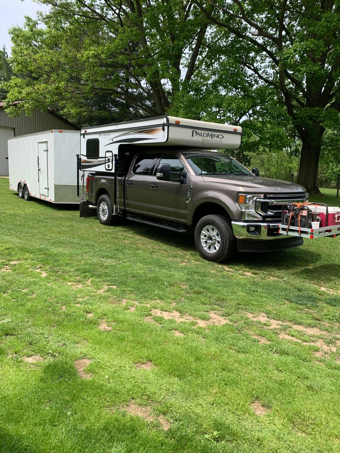

I opted for the camper certification on my 2022 F250. I haul a slide in camper. Empty the ride is fine, firm but fine, I also put a front hitch on my rig so I could put a front basket on to carry a cooler and my generator. I'm glad the package came with one up better front springs since I'm carrying the extra front weight

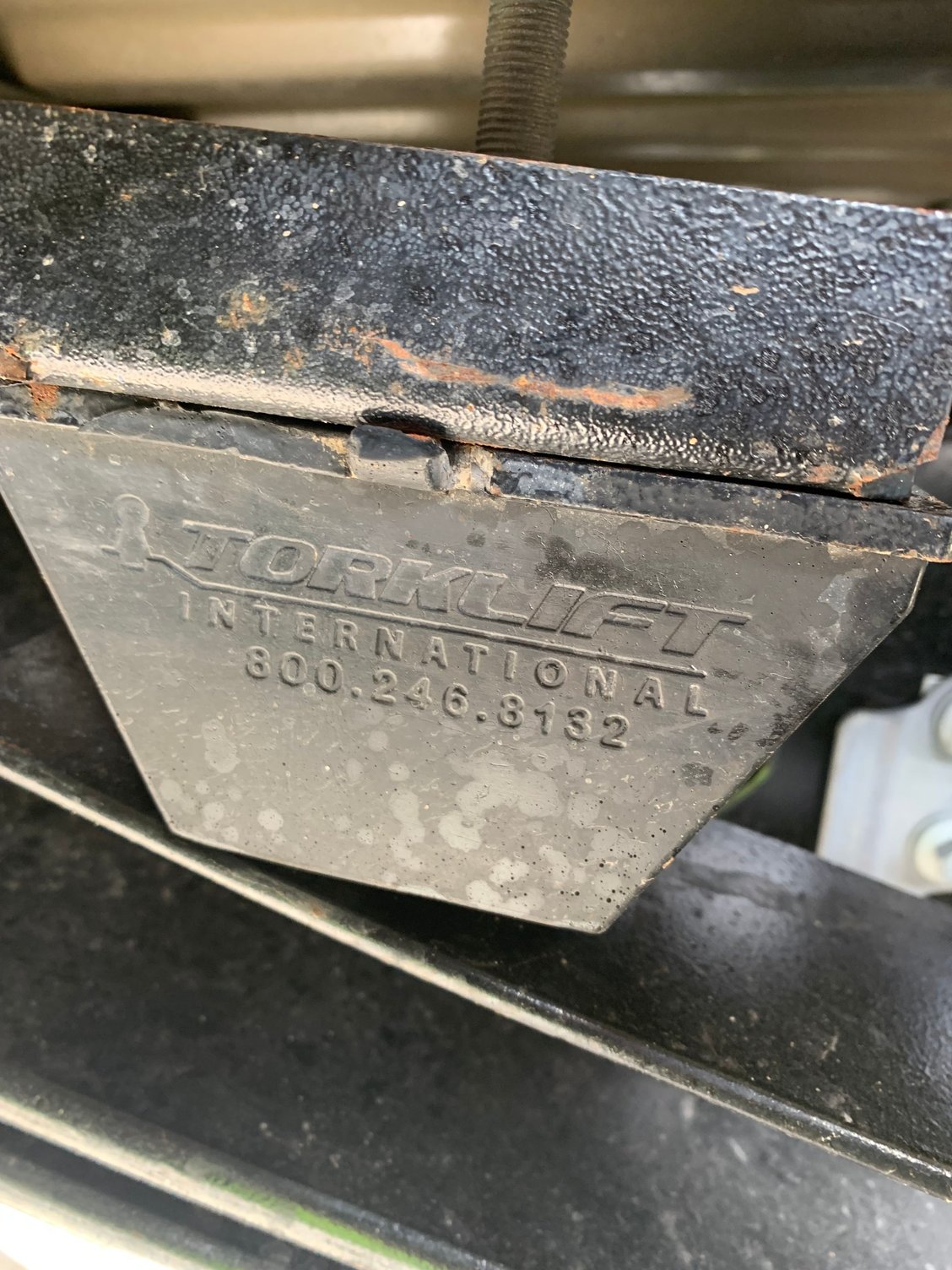

I also added the Torklift upper stabiloads that allow the overload spring to contact sooner. It's just a 2" spacer basically. Here is a pic
