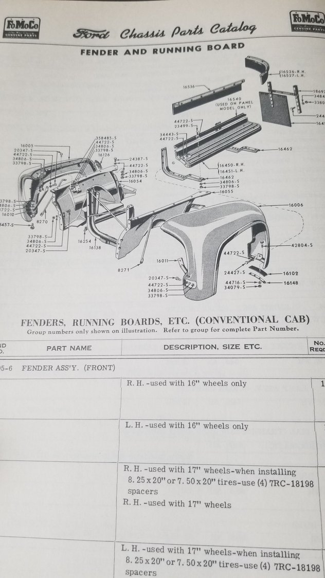

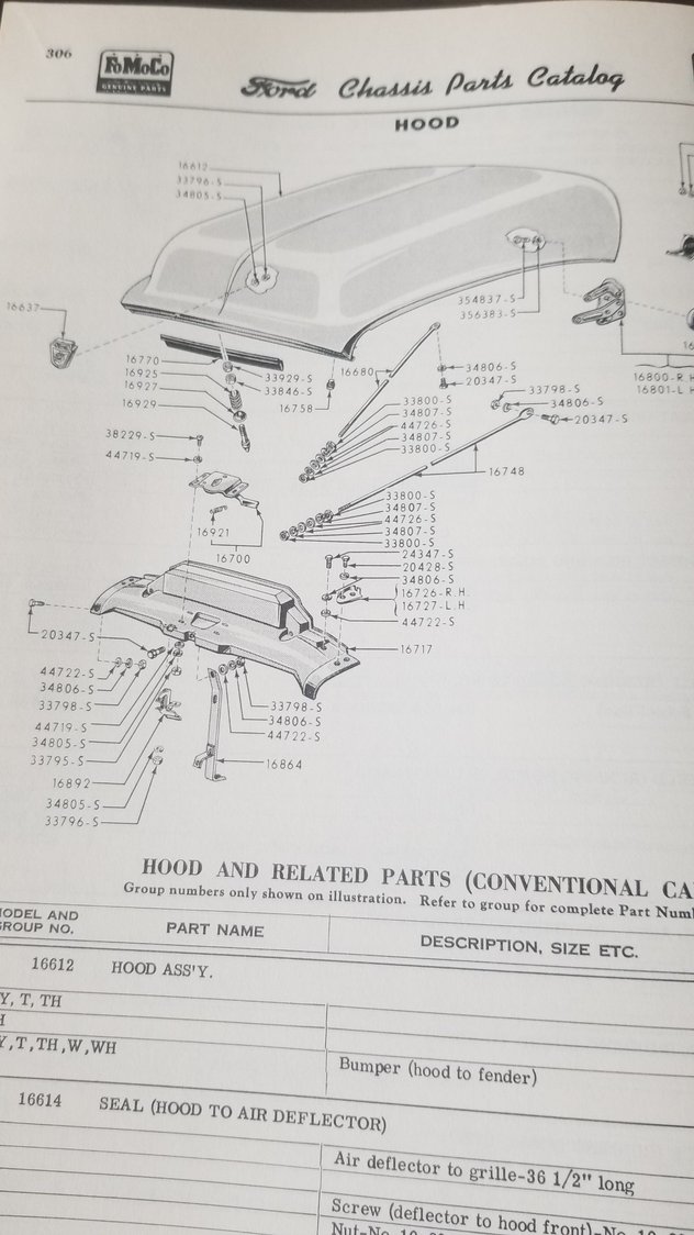

Hey, thanks for answering. I am just looking for some different tires. So i can use 16 inch wheels and tires from the years you mentioned? Also when i bought the truck a couple of weeks ago the whole front clip is off. Do you know how to put it back together. Maybe have a diagram or something i cant find anything on line. Thanks and have a great day

Here's some diagrams from the 56 Ford truck parts catalog, Hope they help. You can click on the pics and save them to your computer and view them larger or print them.

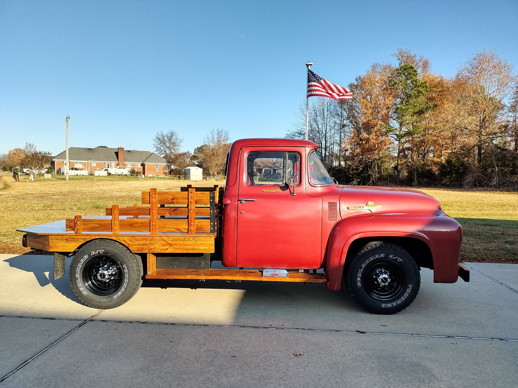

I have the stock chassis and brakes, hubs. 8 lug and i dropped to 16 inch rims
49647 4 16 X8 8-165.10 -6 BKGLXX rims from Discount Tire
