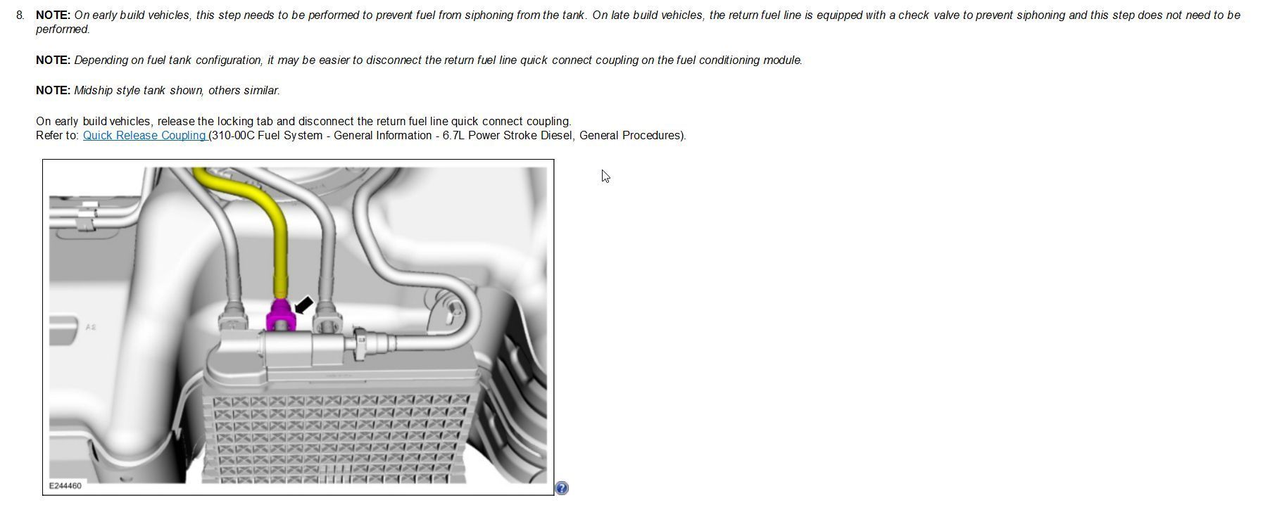

Old Jul 11, 2023 | 09:33 PM
muisejt's Avatar
muisejt
Joined: Oct 2022
Posts: 275
Likes: 156
Old Jul 11, 2023 | 09:41 PM

Originally Posted by muisejt
What do they define as "early build" and what is the context of that screen shot? My 2019 owners manual specifies 2017 as the only year requiring removal of a fuel line at the in tank fuel pump as a first step to a fuel filter service.
