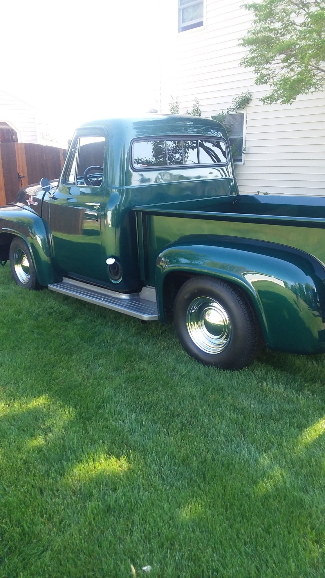

Been in my 55' since 2009.

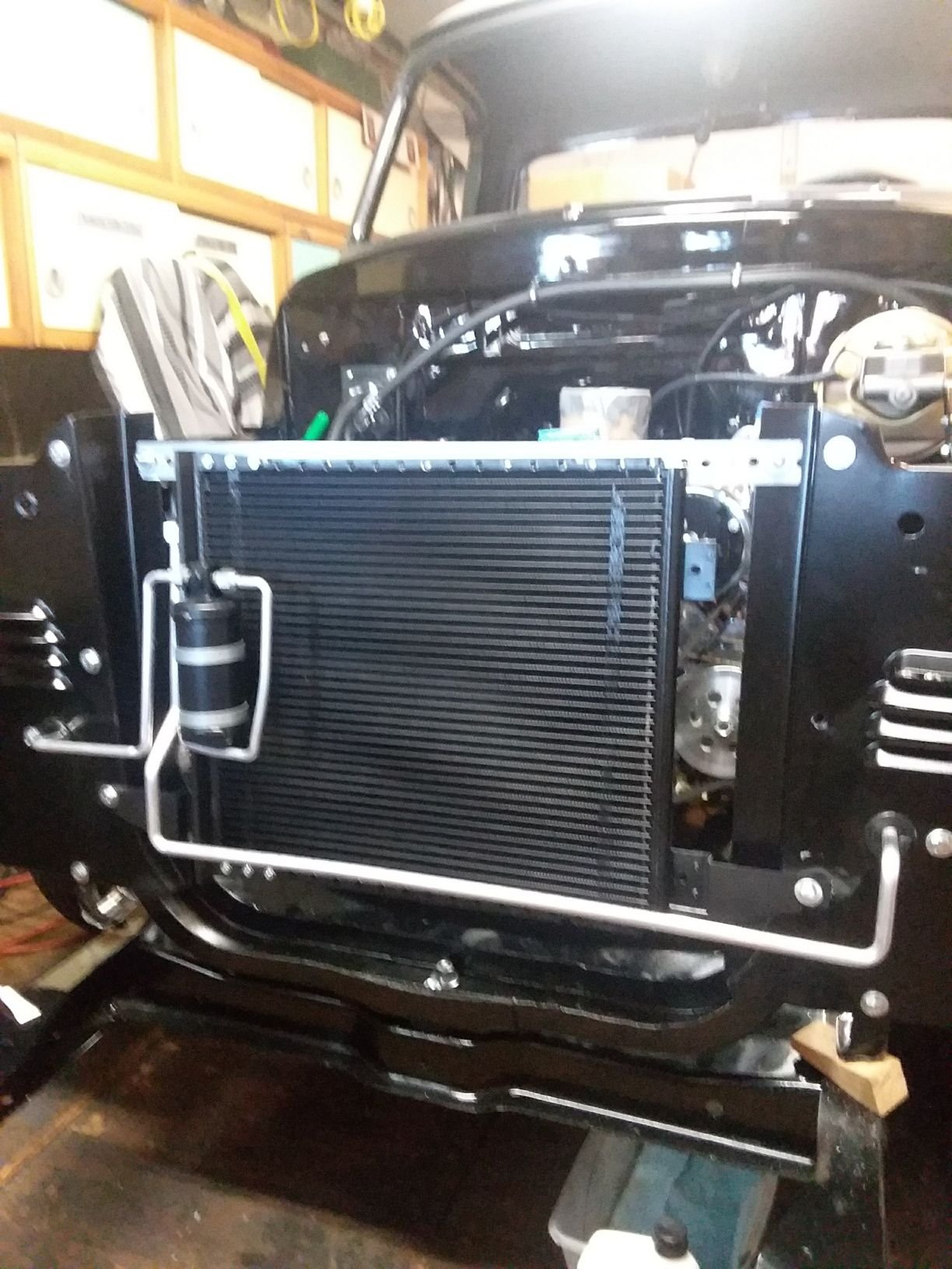

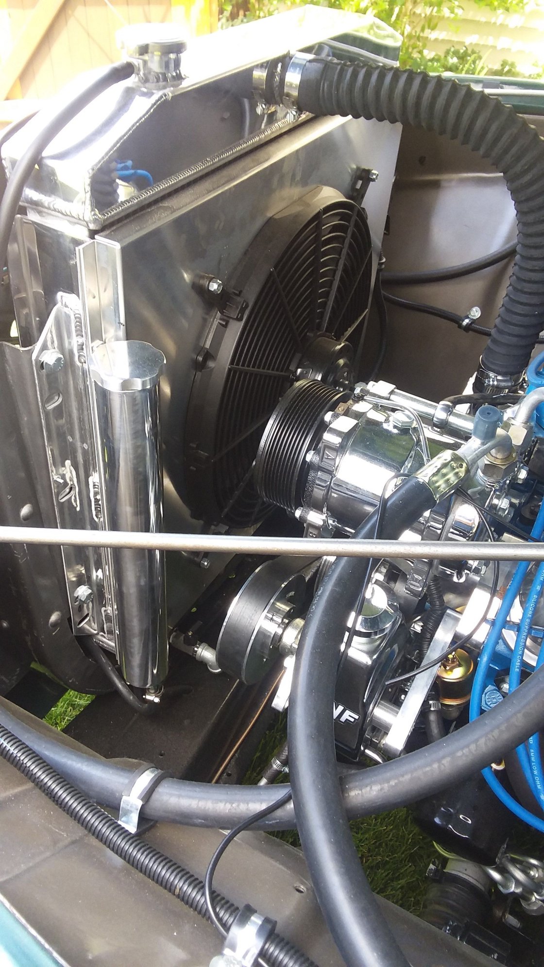

For a 312 what about AC bracket-- Modern AC compressor--pulley set-up-- not stock water pump-- wiring, Trinary switch, condenser-- electric fan, correct fan shroud, 3 row Aluminum radiator-, updated wiring harness and modern fuse panel-- lot of parts need to install on a OLD original 312 ?-- Good luck
So easy on a Ford 302 or SBC----
