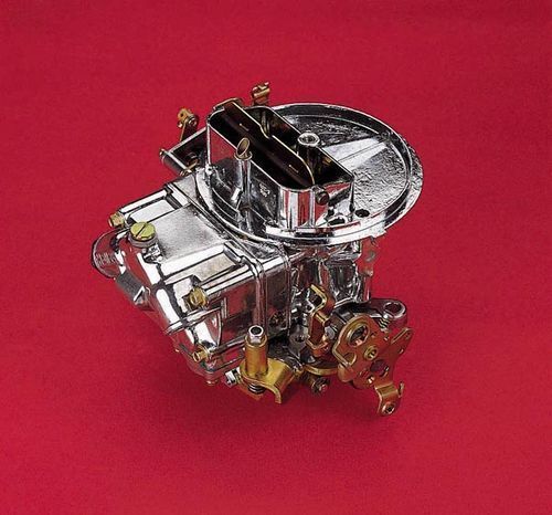

Well yesterday was a really long day. The car show in Littleton NC was about 100 miles from home. We left from Wilsons Mills which is 15 miles from me and it was 85 miles from there. On the way back, after about an hour of driving, we made our second stop at a gas station in Louisburg, that is when Dave split off from the group to head home. The rest of us wanted to stop for ice cream. Well the ice cream place was 1/2 mile from the gas station, and I was the last one pulling out onto 401. Everybody makes a left at the light but when I let off the gas to coast, my car ALMOST dies. Something not right! I pop the throttle a little bit, she seems ok. Come to a stop to wait for traffic to clear and she dies. Won't restart! Two guys in a parking lot next to me offer to push me through the intersection, thank goodness. And it's a downhill into the shopping center so I just coast off into the Mayflower restaurant parking lot. The guys are all next door at Dairy Queen so I walk over there. Explain what happened. I said either I'm losing spark, or else flooding out, because when I try to start it you can just smell unburned gas.
We figured lets enjoy our ice cream and let the car cool down for a few minutes. Head back over there, I have no tools. I found many years ago I jinxed myself by carrying tools so now I don't, and look where that left me. So borrow a screwdriver and pull the coil plug off, crank it over. John Avery about gets fried and yells "oh **** YEAH you got spark!". lol. So we determined the carb was flooding, hold it open and crank and she will fire, but you can tell it was loaded with gas, and then when you let it idle, after 2-3 seconds cuts out again. But no gas coming up out of the overflow.
Meanwhile poking around, one of them found a very dry rotted vacuum cap that was obviously not holding any vacuum anymore under the base of the carburetor. Just a little one, I said I don't think that is my problem, it would still idle with a vacuum leak that size, but you know O'Reilly was just right across the road so Louis ran me over there to buy some vacuum caps. Meanwhile John Avery saw my vacuum advance line was a little loose. The carb fitting and dist fitting are different sizes so I'd jury-rigged it before and now after all these years it was not sealing good. Again, I said, I don't think that is the problem. It wouldn't even be applying a vacuum signal at idle I don't think, because that's the ported fitting. Anyway fixed those 2 vacuum problems, still flooding out.
I call Haggerty to see if they can get me a tow home, they said "hmmm your policy doesn't have roadside assistance, but I can set you up with a tow - however you'd have to pay for it. $747." I said no thanks! Oh and I should have mentioned, we all took turns smacking the top of the carb to see if the float was stuck & could be released that way. I tried the float adjustment fittings but I already have it at the lowest possible setting. But messing with it did not help at all. So somebody said take the float bowl off and see if we can unstick the float. I was remembering how gummed up the gasket was on my F100 holley when I pulled it apart, and was really hesitant about doing that. I said if we open it up that's the point of no return. But we figured our best option, luckily Andy and Paul both had tools, so between them we had the 5/16's needed to pull the front off.
Have to say I was very pleased with how clean the inside of the carb is after 12 years, and the gasket did not stick or fail, just eased off smoothly. Did not see anything obvious wrong with the float, needle, or seat, and it was all working fine after taking it apart. I had the float bowl facing towards me when I was checking all the screws & accelerator pump arm, and ended up squirting gasoline right at my face and directly into my right nostril. That was awful and burned like hell. But not finding anything wrong, so we put it back together and snugged the bolts down, and she ran perfect the rest of the way home.

Sorry I did not pull into the station as I thought you were going to talk what way to go home and I planed on down 401 to Cap blvd. to 440 to 40 and home.
With over drive doing 70 is not a big deal and why that way.
Follow up:
Saturday / Sunday I found out what happened, sorry again, and on Sunday John came over to my house.
I could not go to his as wife was taken to the ER by a friend and did not want to get to far from home till I knew what was going on.
Any way I adjusted the float level and showed John how, not that either of us will remember what way to turn the nut LOL so he can do it if he wants but it should be good for ever now.
I think between the stop at the gas station with it running and then moving the carb got heat soaked and was boiling the gas in the bowl.
John did not see fuel out the vent so the float was not stick but if the gas boiled it could not run on vapor from the boiled gas.
I also told John they make a thicker carb gasket and sent him a link, that he could run to insulate the carb from the hot intake manifold and see if that helps.
Now that it should be cooling off he may not have this issue again (fingers crossed).

Hi Dave, the more the I think about it, the less I think that vapor lock could explain it.The symptoms of flooding, not fuel starving. Including liquid gasoline when I pulled off the ported vacuum lead going to the distributor. It just was not coming out the overflow on the top for some reason.
Remember that thing I sent you a picture of? I think I found it on the page. Right above the metering block.
https://documents.holley.com/techlib...loded_view.pdf
Number 117 looks like the thing we found on the intake after removing the float bowl.
Maybe it came out and got jammed against the float? I cannot quite figure out what it is supposed to do. But I think we should take the float bowl off and reinstall it.

Just a thought is your carb a side hung float?
Don't think I have worked on one of them and why I had not seen that part before.

The float is on the front:
