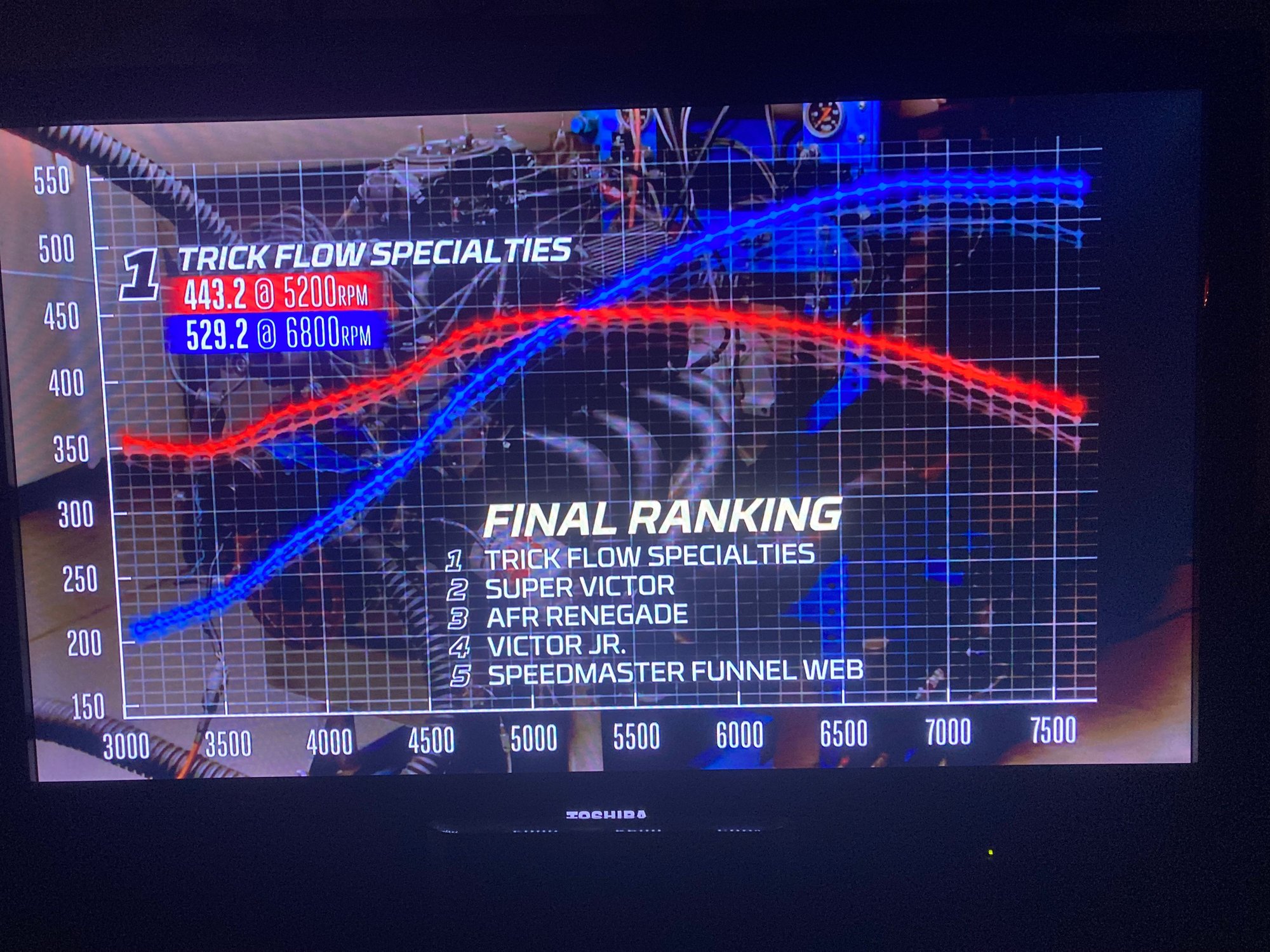

Engine Masters just did an intake swap using Edelbrock Super Victor and Victor Jr(Ford Racing’s version),AFR, TFS, and Speedmaster(offshore Funnel Web) on a 363.
Speedmaster intake did very poorly.
For the cost and maintenance of using adapters, just buy the right manifold.

Okay, I don't have a Motortrend subscription and I can't find it on YouTube. But, they do have a teaser on FB. They were all single plane carb intakes. Not exactly apples to apples but it does show the quality, or lack thereof.

Engine Masters - SBF Intake Shootout! Season 7 Episode 5 (S7E5).
Dart block, 8.2 deck height, 363ci.
Comcams custom solid roller 113 lobe separation .600 lift.
7500+ rpm
First up, SUPER VICTOR
TQPEAK 440.5 @ 5000
HPPEAK 533.6 @ 7000
Second up, SUPER VICTOR
TQPEAK 431.4@5300
HPPEAK 503.1 @ 6900
Third up: AFR RENEGADE
TQPEAK 439.2 @ 5100
HPPEAK 517.0 @ 7000
Fourth up, TRICK FLOW
TQPEAK 443.2 @ 5200
HPPEAK 529.2 @ 6800
Fifth: SPEEDMASTER
TQPEAK 420.8 @ 5100
HPPEAK 496.6 @ 7000
On Netflix.

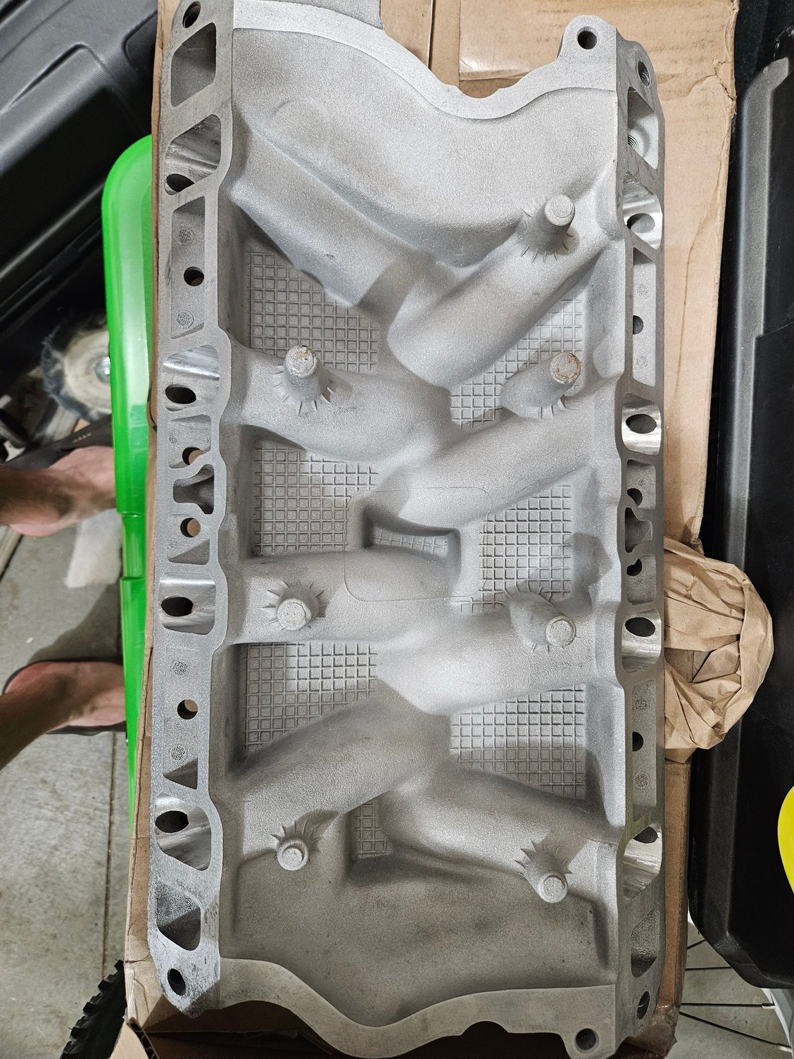

Figured I would show some pics of the lower manifold back from Tmoss. Matt was easy to deal with and I had it back in under 2 weeks. Sure beats the waiting period for some of the other places!

Did they give you any flow numbers on the intake?
Old Aug 12, 2023 | 05:20 PM
bleeds blue's Avatar
bleeds blue
Joined: Aug 2002
Posts: 583
Likes: 46
From: Utah
He told me it would flow 239 CFM.
