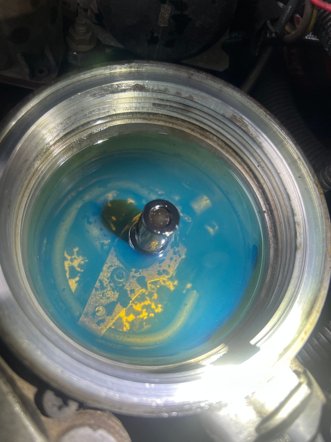

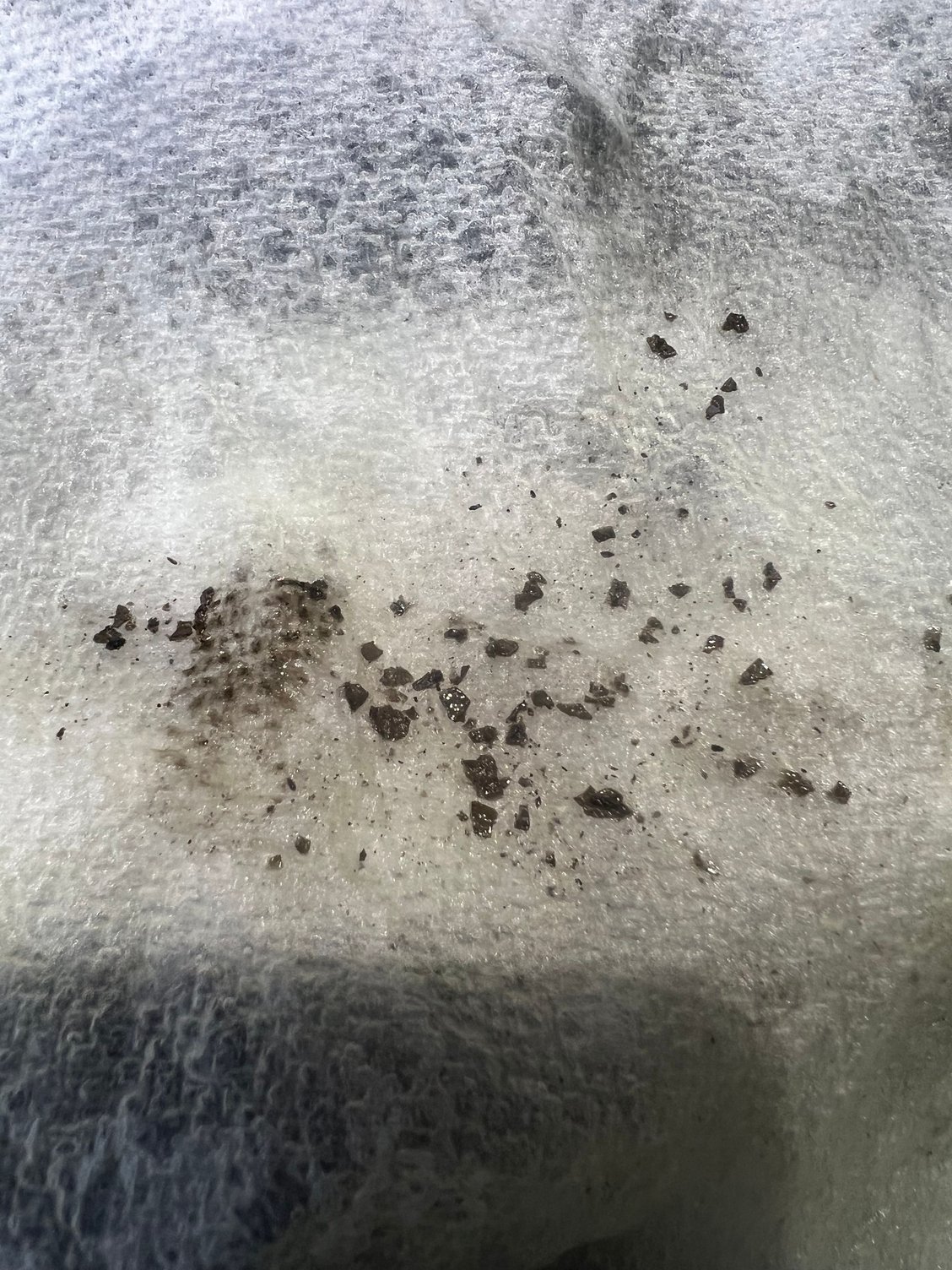

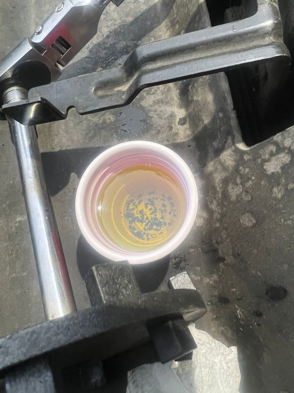

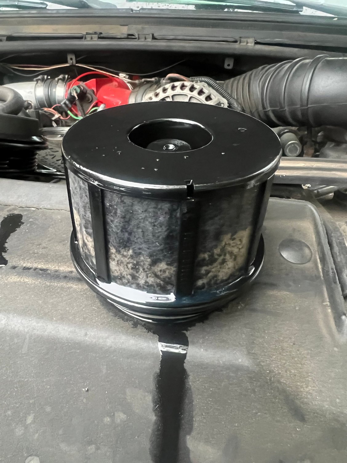

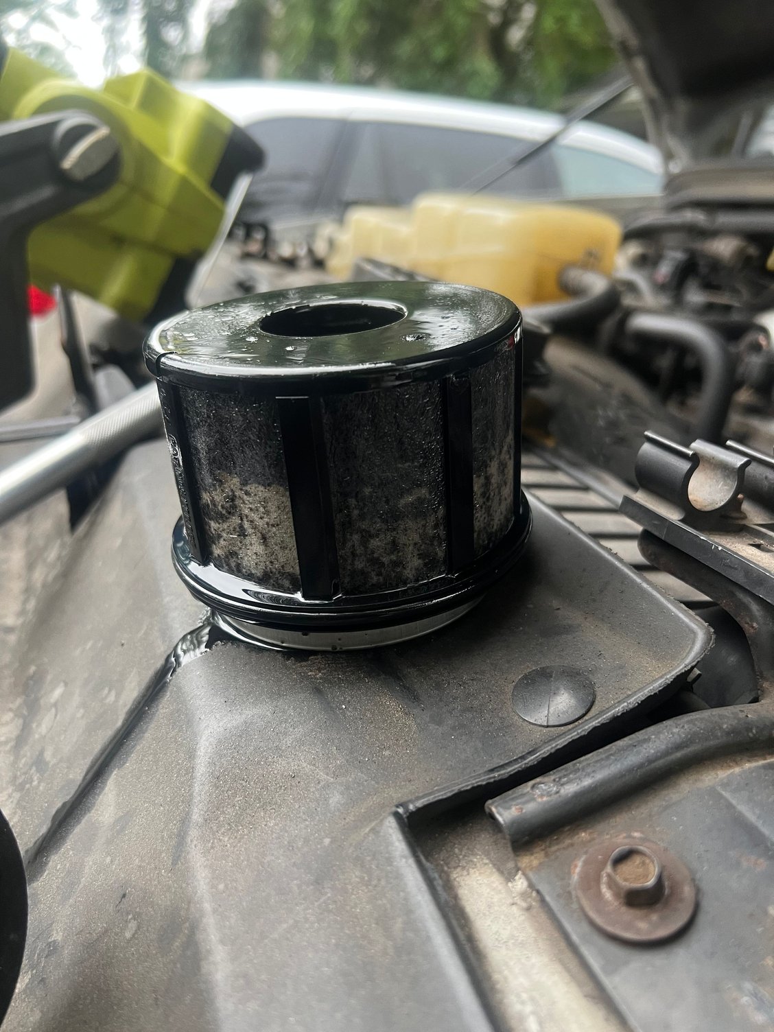

Rain stopped long enough for me to get under the hood. I checked the tinnerman nut on the ipr and it’s in place and seems tight. I moved on to the fuel filter which was last changed about 25,000 miles ago according to my records. I pulled the filter and it definitely looked pretty fouled. I also noticed some flaky particulate in the bottom of the fuel bowl. I managed to catch some in a little cup and poured it onto a paper towel. I’m thinking it’s some biological material, not sure oil would flake up like that? So I’m starting to think my issue might be multifaceted. I still can’t get my Bluetooth dongle to connect to my FORScan so I ordered a usb obd2 connector so hopefully when that gets here I can check the codes with a laptop. I’m including some pictures

Yeah I'd bet that filter s the cause of your stalling, but what's the cause of the filter plugging like that. This is a 2000 1 ton right, I don't think any of those came w/ steel fuel tanks but you might double check. The steel tanks are known to delaminate and plug up filters. Otherwise may be looking at dropping the tank for cleaning and start some biocide treatments. What's the coolant reservoir look like any signs of oil or diesel there?

yes 2000 f-350. I’m pretty sure it’s not steel. I tossed a refrigerator magnet on it and it wouldn’t stick. I agree that could be causing the stalling a fuel starvation issues just wondering what the pick up screens look like if that much particulate made it to the fuel bowl. Still not sure what would cause the oil loss. Degas bottle looks pretty good.

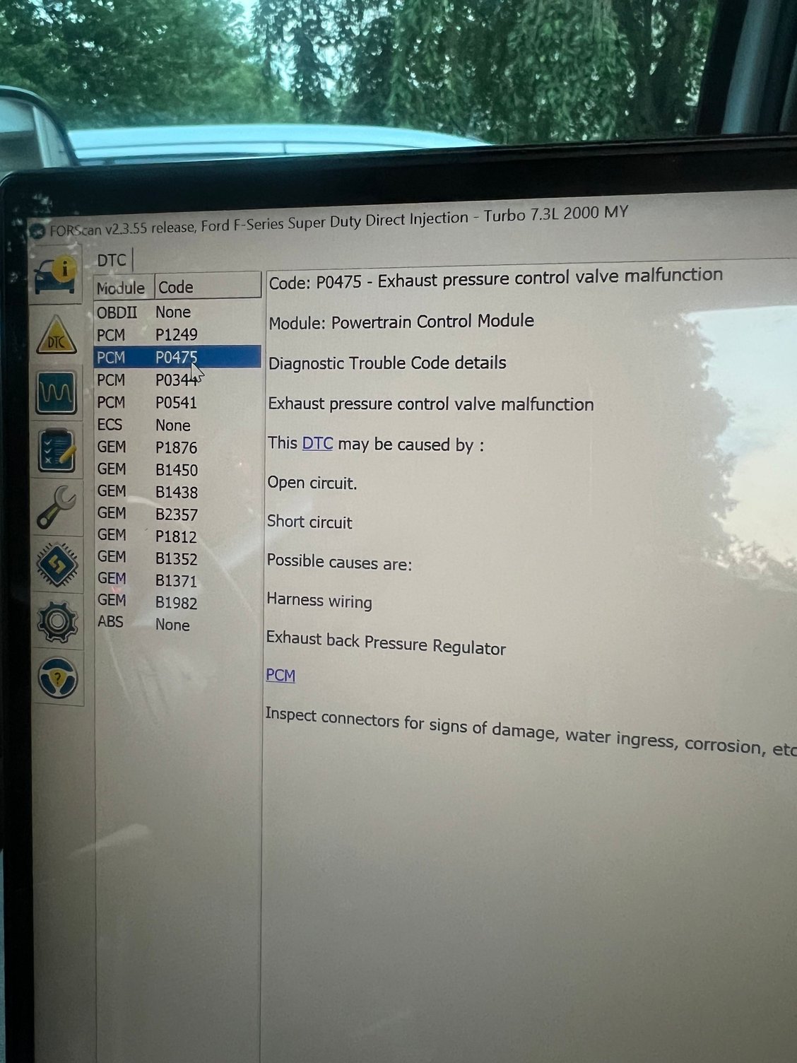

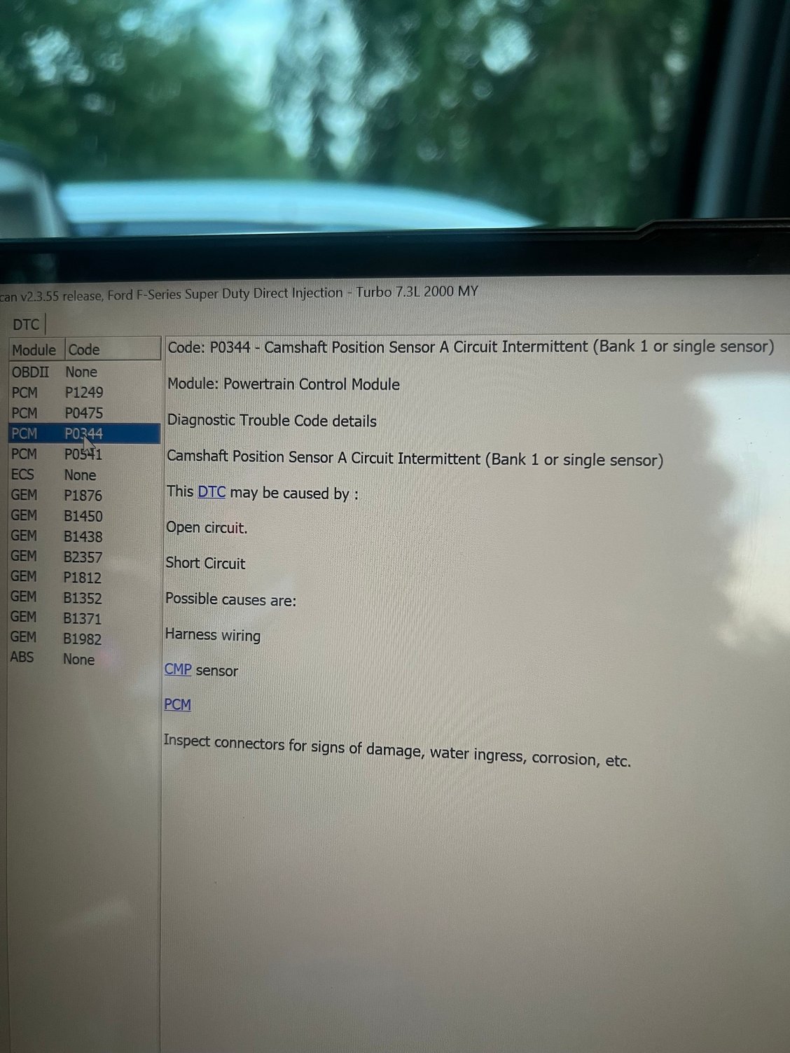

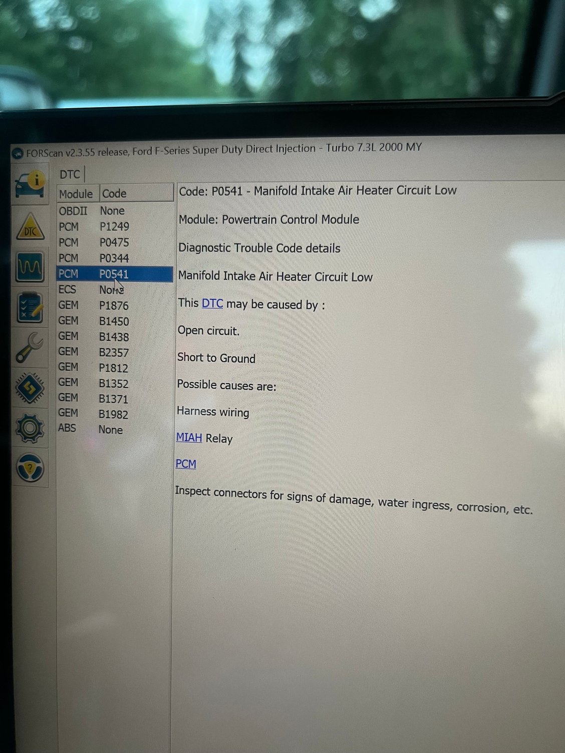

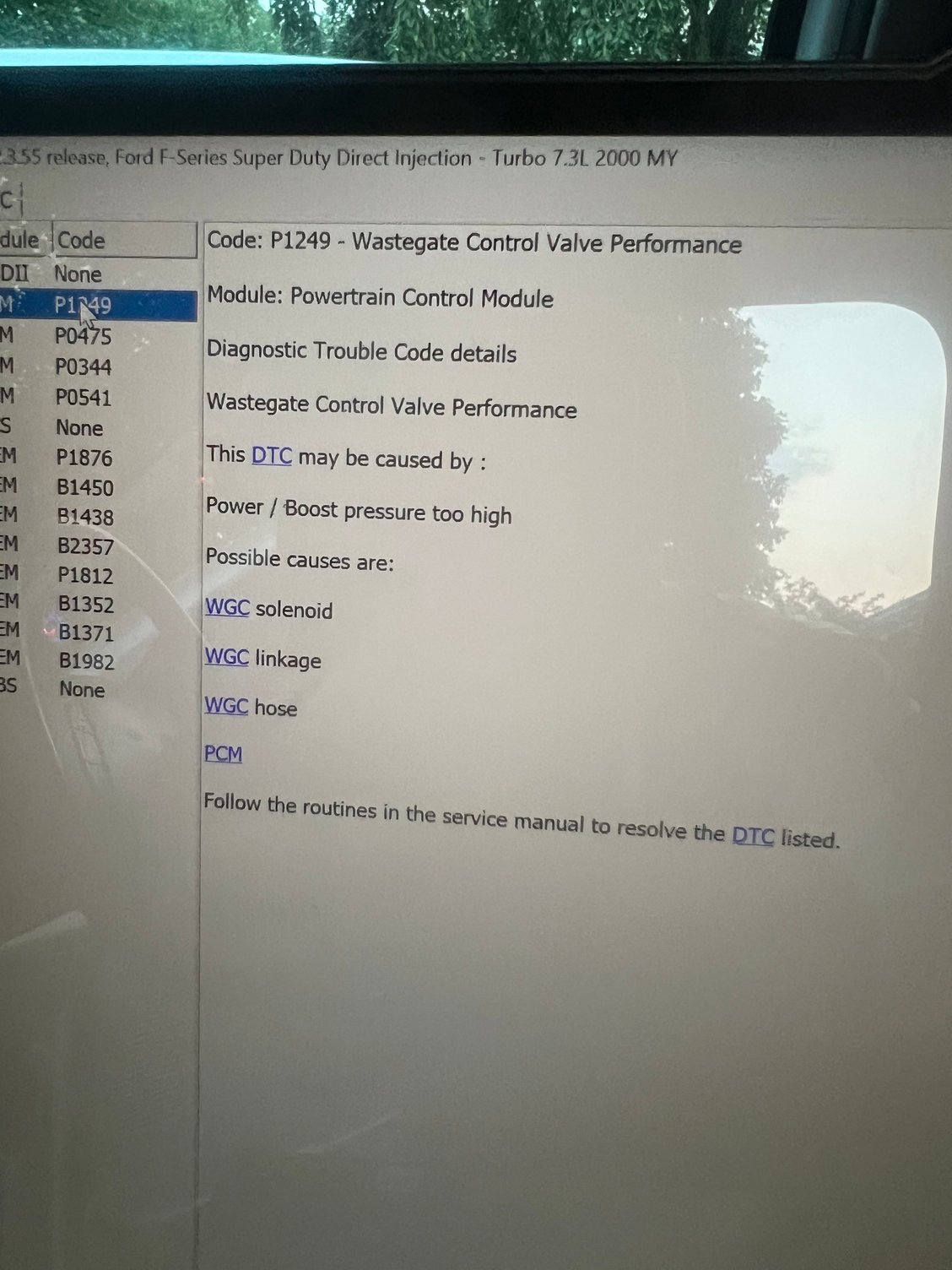

Still can’t get my phone to connect FORScan so I bought a wired connection and connected it to the laptop. These are the codes that came up. The wastegate is disconnected/deleted so that is normal as is the air intake heater so they are expected. Maybe I should throw my new CPS on since I got a code for that? Is that EPCV code for the tube and sensor possibly clogged? I’ve never had it off in my ownership. I know some people run weed wacker line through it to clean it out?
Old Jul 13, 2023 | 09:32 AM
Kwikkordead's Avatar
Kwikkordead
Joined: Jun 2004
Posts: 25,090
Likes: 1,112
From: Rio Rico, AZ.
With all those different codes stored and from the sounds of your description of woes, I would begin with making sure that all the power supply connections and grounds are corrosion free and clean. New power supply relays for the engine management system. Since you live in the rust belt, salt is extremely suspect to have invaded the wiring harnesses and other parts of the electrical system and is now showing it's ugly face.

Could that material in your fuel bowl be from the cap? They don't look like any microbes that I've seen, that usually looks like pepper. Like suggested I would definitely drop the tank and do the Hutch mod and if you can swing it time and money wise a fuel pressure gauge would be a valuable troubleshooting tool and will save a lot of time and headache. I have a permanently installed Isspro and wouldn't be without it.

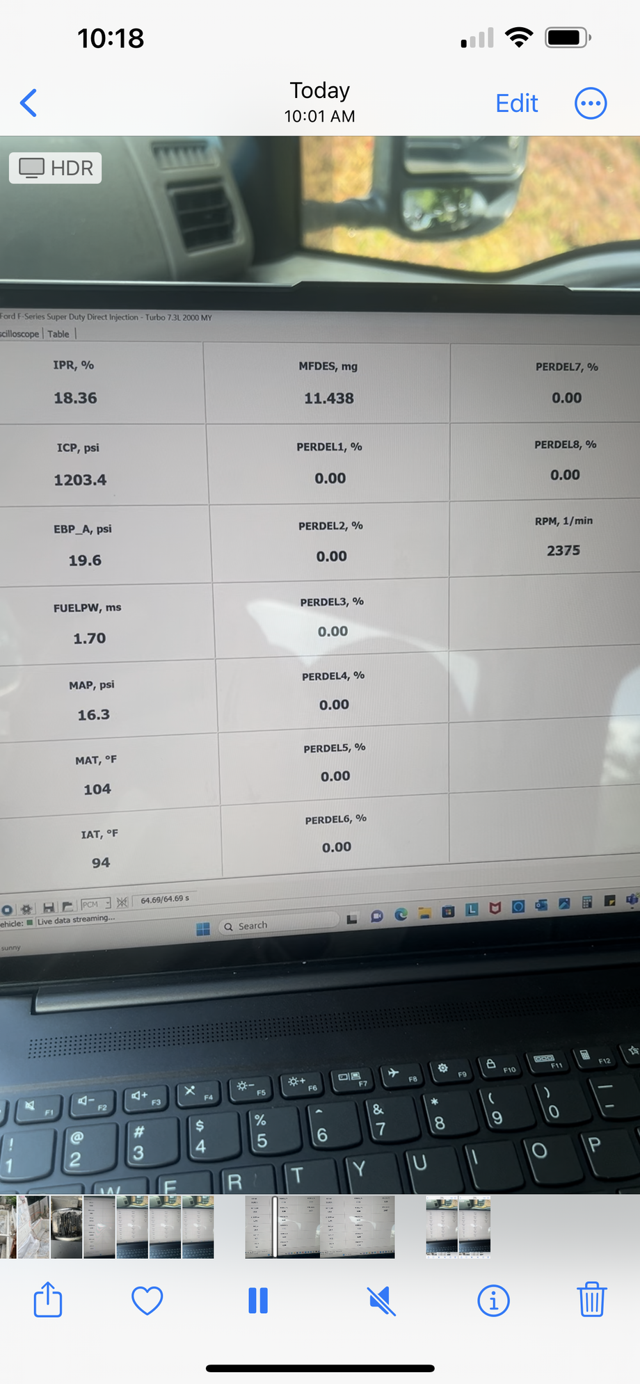

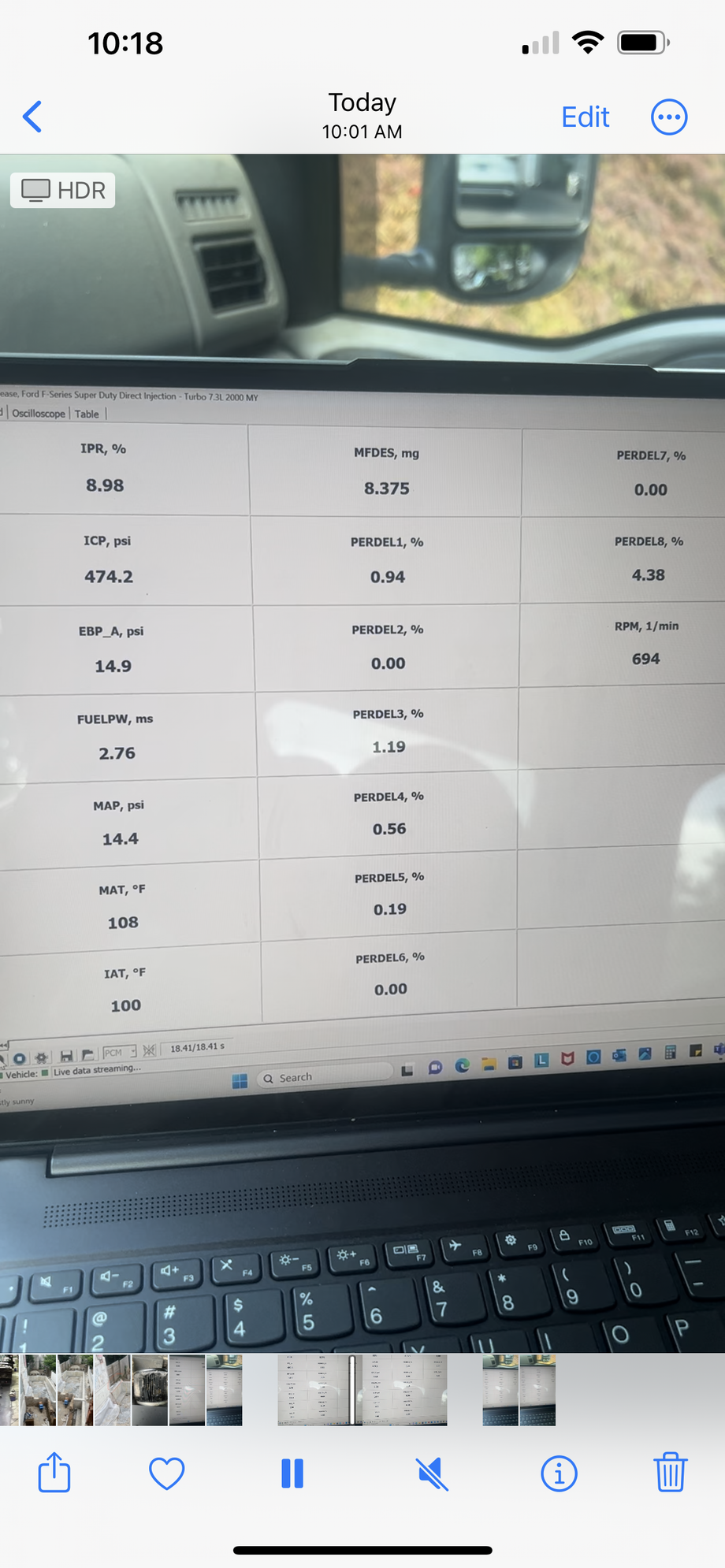

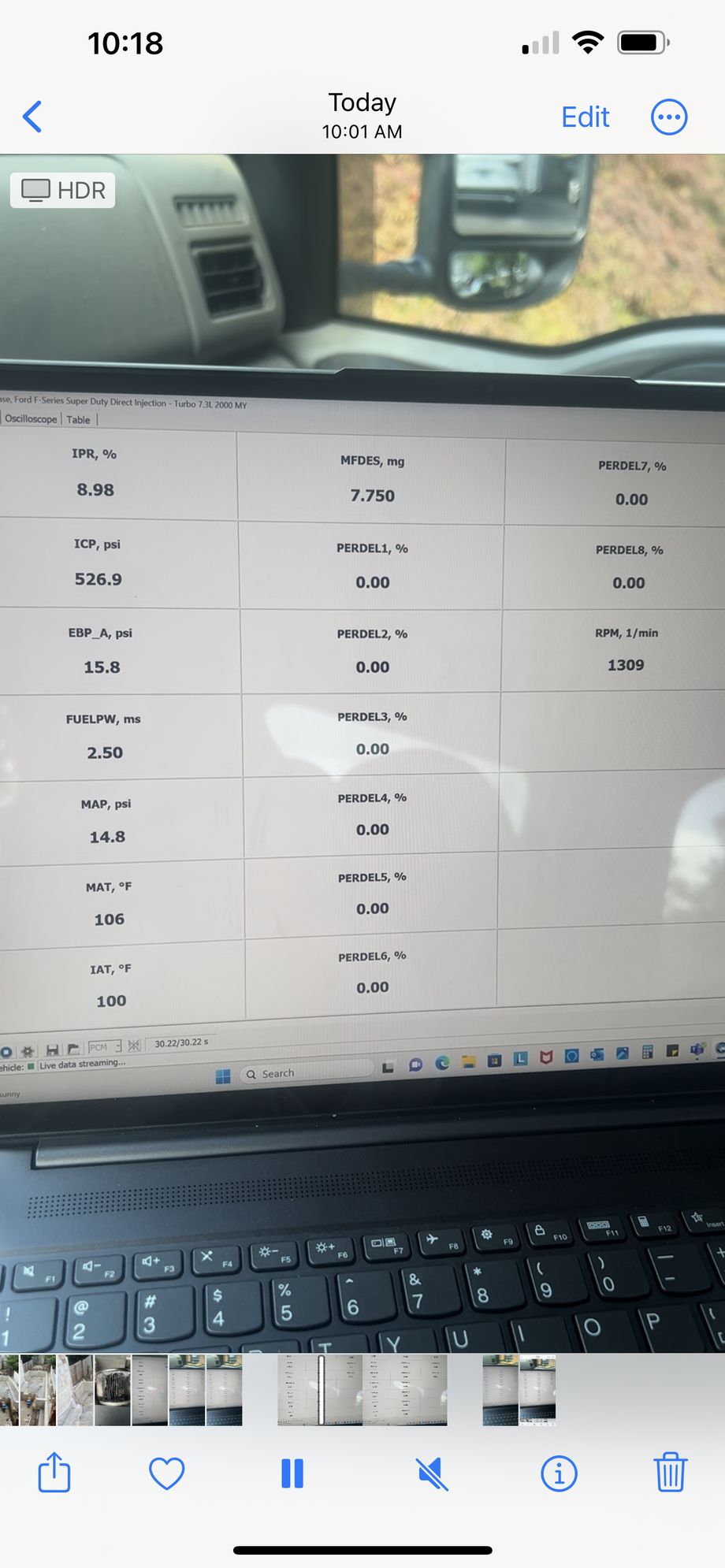

Some updates on the issues. I haven’t had much time for trouble shooting but I replaced the fuel filter, cleaned out the fuel bowl, checked the oil level and set out for a test drive in the neighborhood. The truck seemed good, throttle was responsive and it didn’t cut out at all. I decided to stretch the legs a little further and drive up to tractor supply (about 3 miles away). I was pulling into a parking spot and it dies. Damn. It started right back up with no codes so I shut it off and went inside. Came back out and it started up again. Went around the parking lot once and it shut off again. Started back up and nursed it home without it shutting off. Got the laptop out and set up some PID’s for it to monitor. Here is what it showed. I’m not real familiar with what the numbers should be so if anything looks out of the ordinary, please let me know. Also if there are any PID’s that would be beneficial to monitor let me know and I can add them. While I was trying to set it up and the truck was just idling, the engine cut out twice. I also broke off the out layer of the old fuel filter and the inner filter looked pretty coated with oil so injector orings seem like they will definitely need to be done sooner than later. I’m also going to swap out the 10year old CPS with an oem one that I have in the glove box.

Tried to add these as a video but had trouble so here are some screenshots at idle, 1400, 2300 rpm’s
