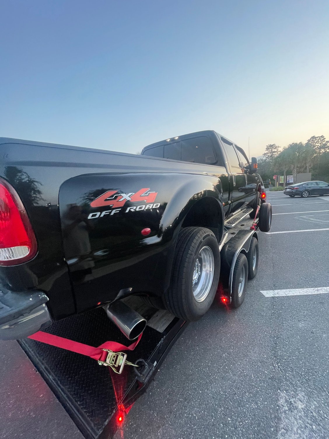

I’ll try and keep this short. I have a 05 f250 with 146k miles. I love this truck and have had no issues in the 3 years I’ve had it. I needed a long bed Dually and found one identical to my 250 so I bought it. It says it has 147k miles on it and is relatively clean. Anyways it has a rough idle. I took it to my local power stroke shop and they went over it. He changed all fluids and filters and added rev x… told me to drive it and see how it runs and if I decide it’s worth investing in come back and he will do whatever we agree on.
I use my trucks to tow, but I don’t drive them much. Maybe 5k miles a year.. but when I go somewhere, I want the truck to run and not have issues.
As of now the engine is “healthy” but runs rough. Like weak injectors or Stiction. It also leaks oil from basically everywhere on the motor.
Shop quoted me about 11,500 to pull motor, reseal, studs, machine heads, lifters, oil cooler, and maybe some other small things that normally go with that.
we also talked about new engine and injector wiring harness for $1500.
$1900 for oem injectors.
how does that sound ? What would you do given the info you have. Part of me thinks for the amount of money I should just put a long block in it. I don’t mind spending the money it needs but I also don’t want to throw money away. I’m not worried about resale value. I probably over paid for the truck because I wanted it.. I’d like it to last me at least 3 years. I’ll probably bite the bullet and just buy a new one in 3-5 years.

The truck itself looks clean, and based off of your experience with your F250, it appears you're pretty familiar with the 6.0. With that being said, the motor that's in the dually sounds like it's got a LOT of issues. I would either get a new 6.0 put in it, or put a Cummins in it.
