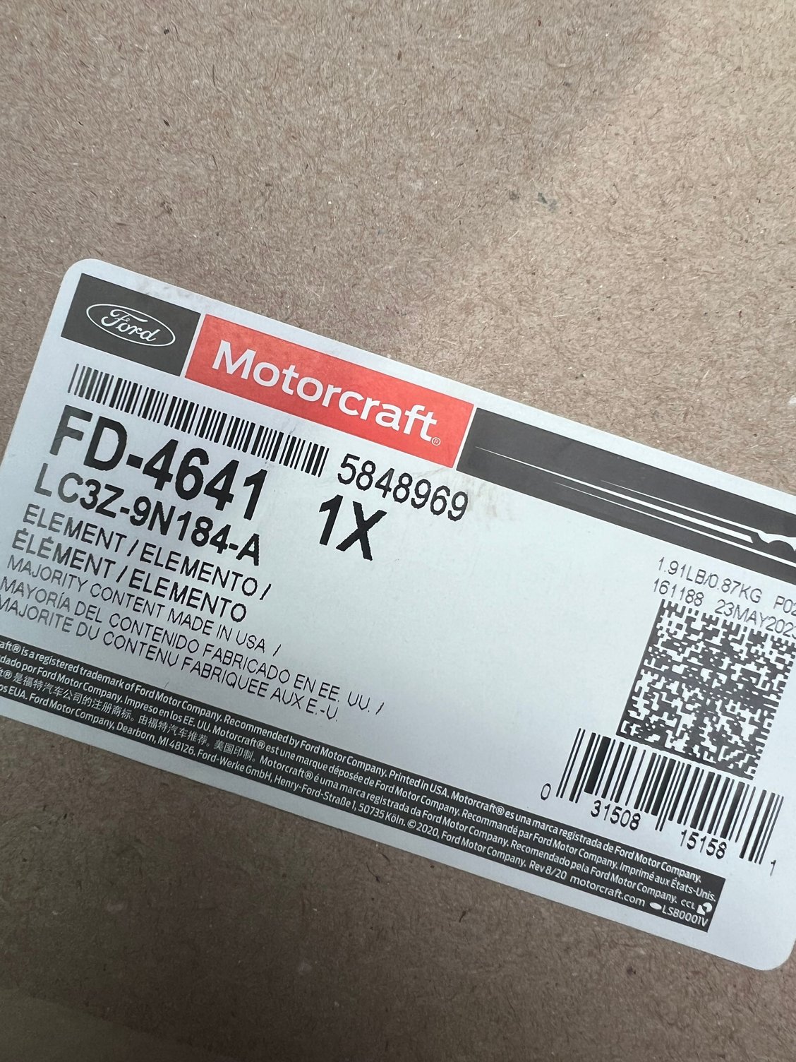

The part numbers are becuase
version 1 had a potential crack in the small return line
version 2 included a collar for subject return line connection to give it strength.
version 3 has a change to help prevent the top center of the plastic in engine bay filter from cracking as the filter gets full. This version does not have the collar.
i had to buy a filter yesterday becuase my version 2 filter cracked at the center and was basically a fuel water foulntain. I went to buy a version 3 filter and was told they have to give me version 2 until supplies are exhausted. I told him I’m currently stuck on the side of the road a few blocks from here with a version 2 and I want a version 3, the latest and greatest…according to him.
i might have been con’ed so here is a pic of what was supposed to be a version 3 filter.
and, don’t but this filter any where but from ford. Ford caps the center output connection to prevent contamination. If you buy the filter somewhere else…it probally will not be capped and you will have to flush it before connecting it.
dont for get to cycle the ignition on and off 6 to 13 times to get all the air out
