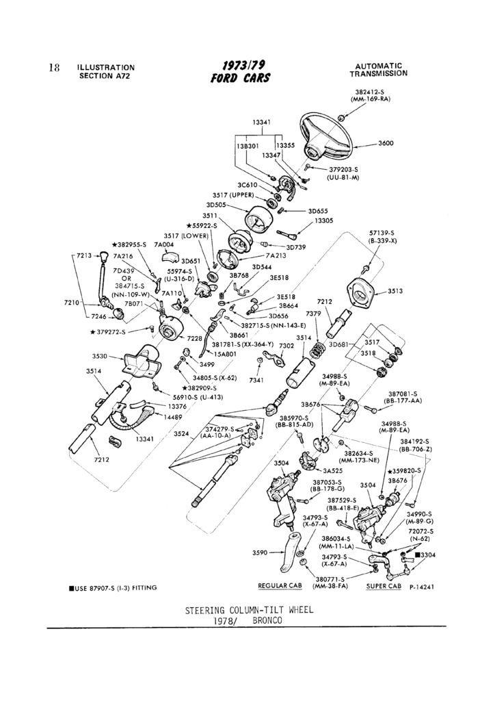

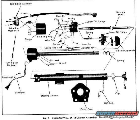

Good day, I’m in the process of rebuilding a 79 auto tilt column and I’m missing a couple parts that I can’t seem to find. The tilt pins (I think that’s what they’re called) and the shift lever itself. If anybody could point me in the right direction that would be awesome. I’ve found pins for a 80 and up column but I’m not sure if they’re the same or not. Thanks!

It’s the little tilt pivot pins I’m looking for and the actual shift lever not the pin. I should have been more clear. Thanks for the help
