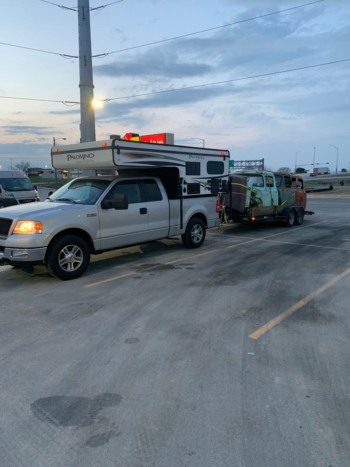

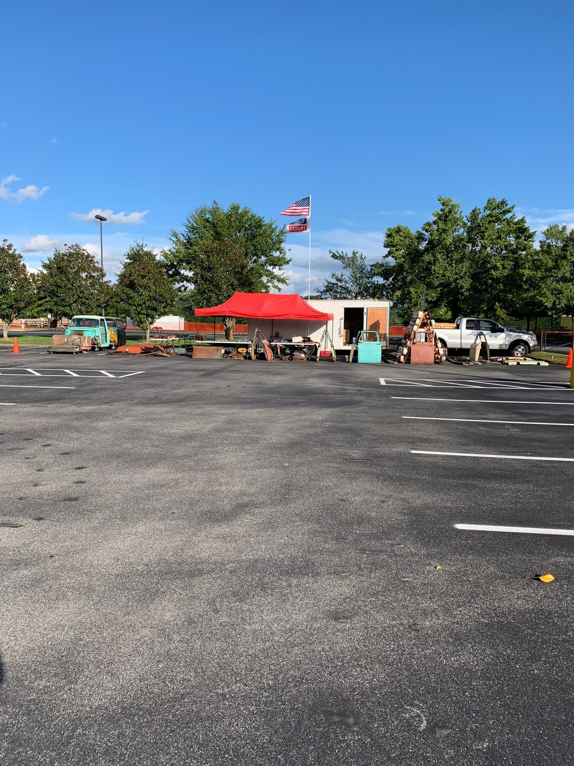

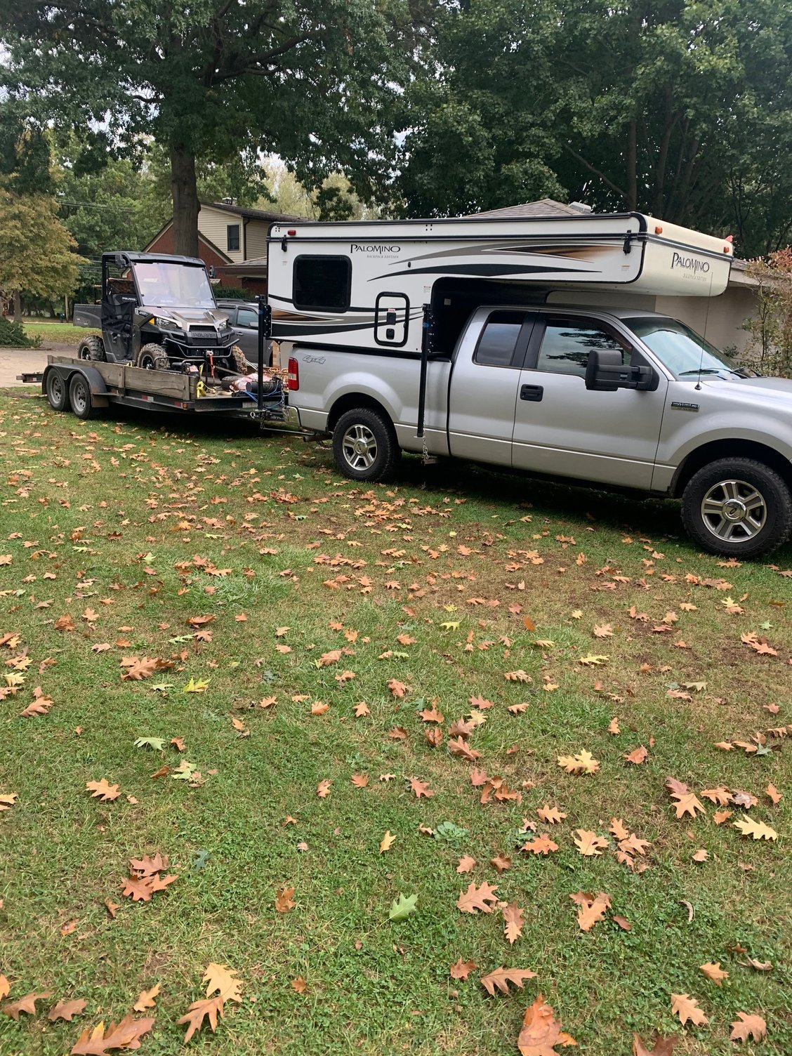

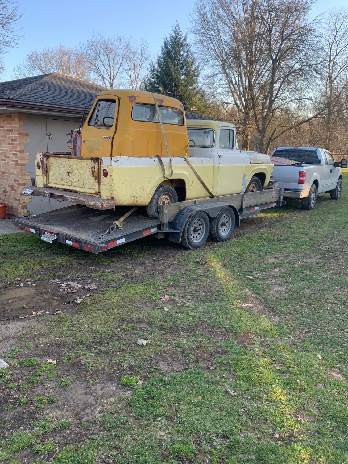

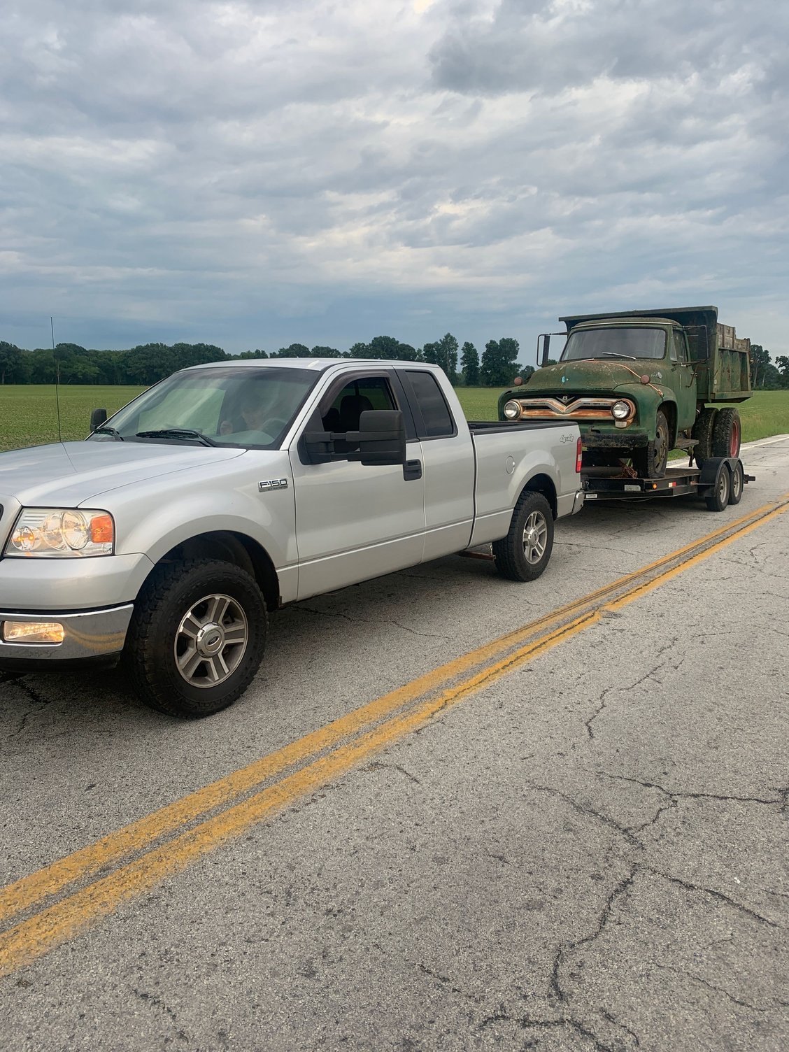

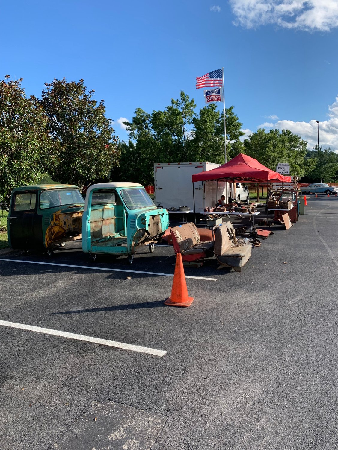

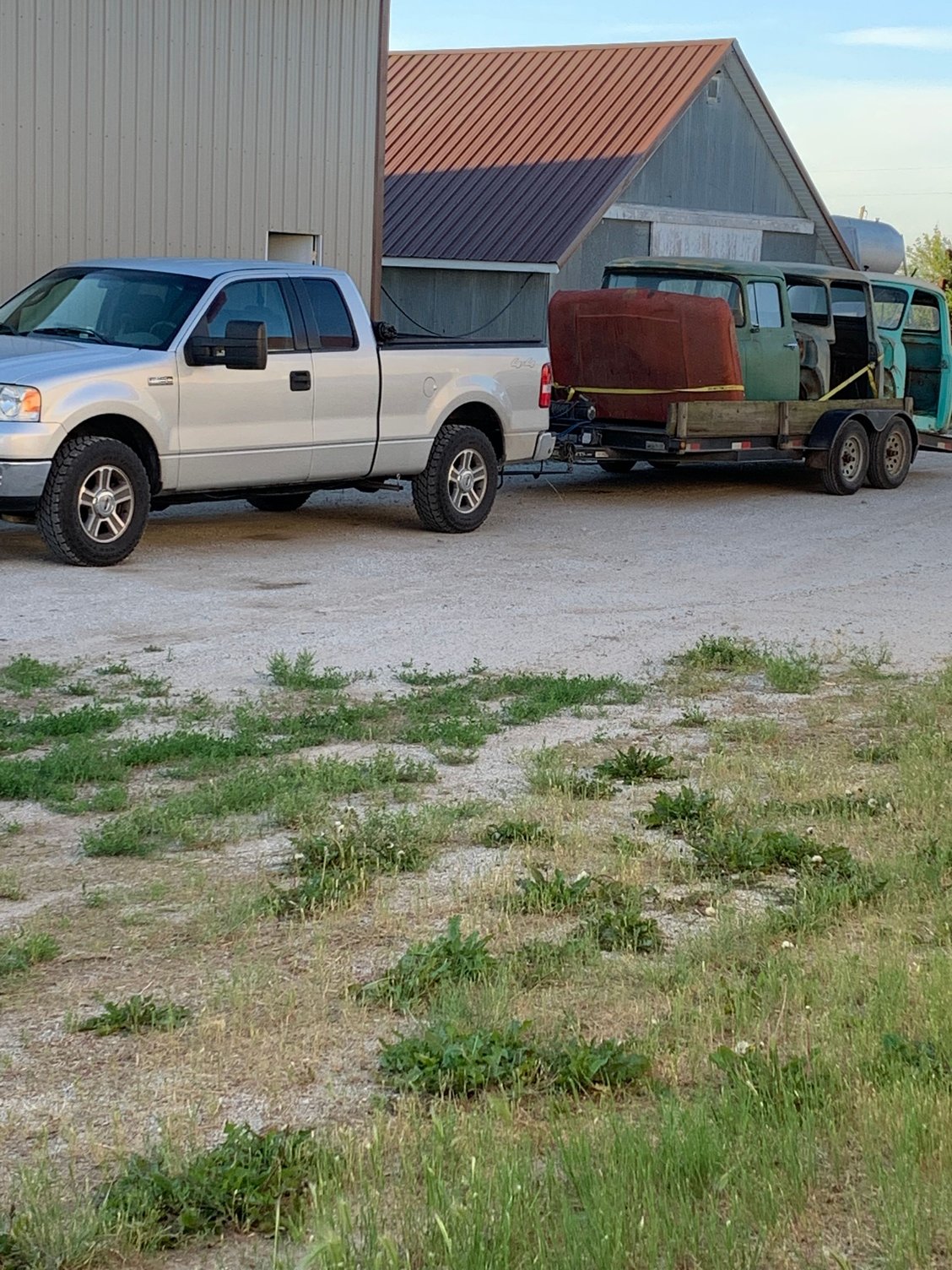

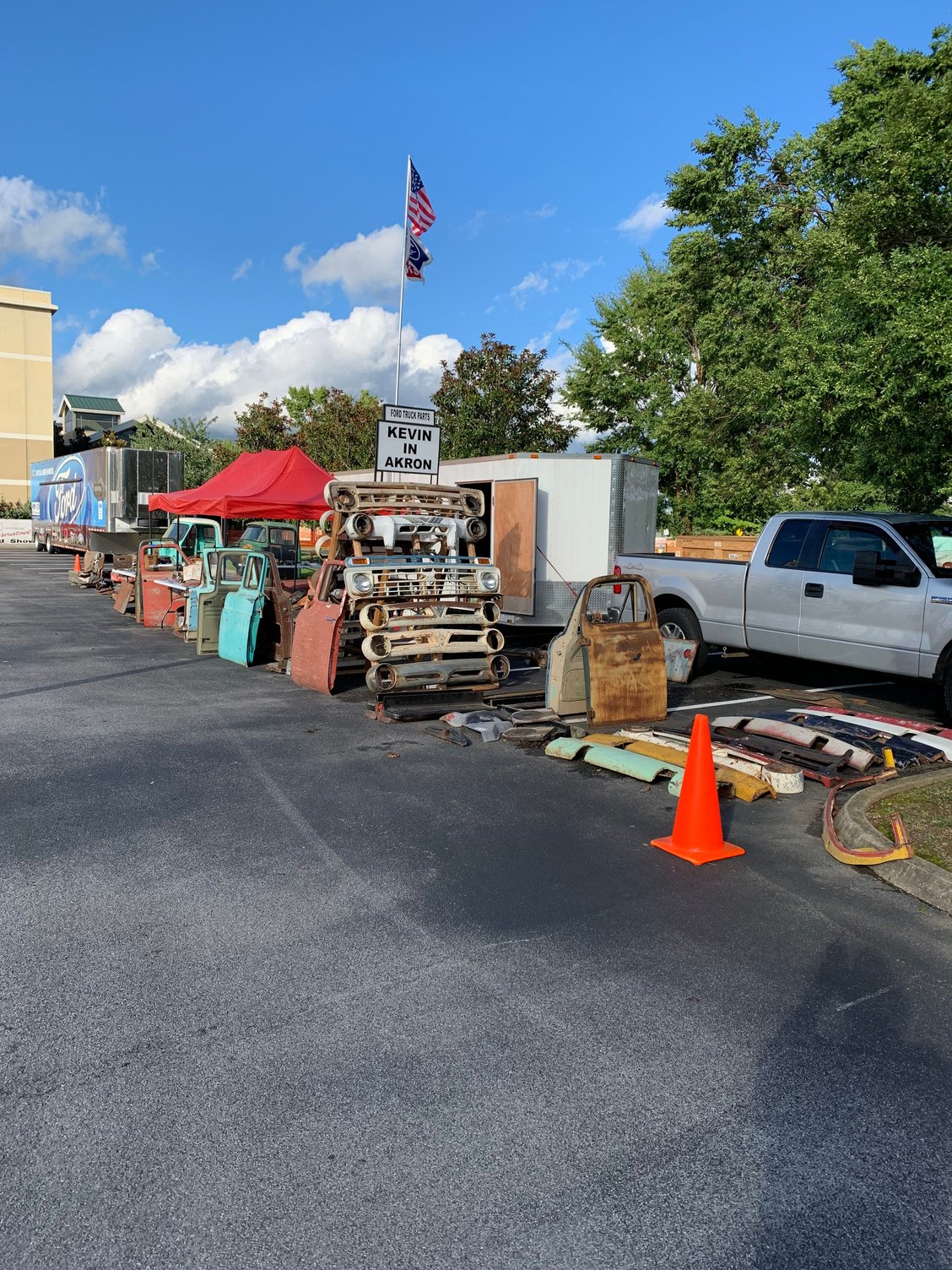

My 05 f150 never had a problem with power that 5.4 worked hard for the entire time I owned it 127,000 miles and never opened up for any internal repairs. Don't be afraid to let the rpm's run up. Let the horses run free. You'll be fine
i couldn't find a pic but it also towed a 20' enclosed trailer several times from Akron Ohio to pigeon forge Tennessee loaded!
edit:
here is a pic of my swap meet set up. All that was in the enclosed trailer!

mine pictured above is doing all that towing with a 3.55. I really liked the 3.55 since I could tow the trailer empty in 4th and when heavy towing drop down to 3rd.
