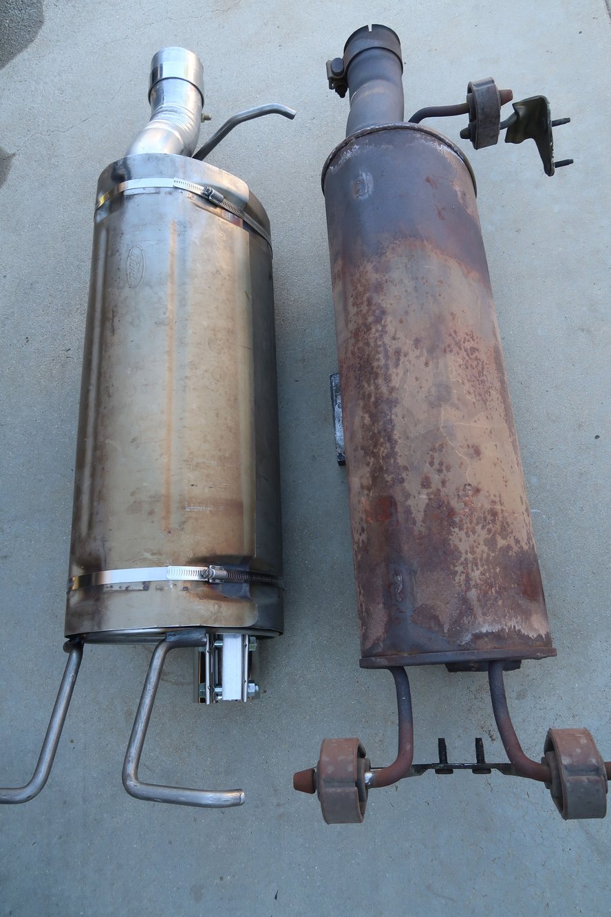

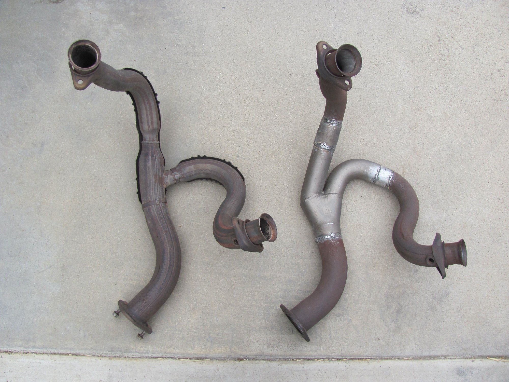

I installed an SPD Y-pipe on our 2002 Limited 7 years ago and have had no issues with flutter.
Are there any other mods to the exhaust?
Our exhaust was factory stock until the pipe bend in front of the muffler rusted and broke.
The break in the pipe bend was toward the center and hard to see from just looking under at the exhaust.
Water vapor collects in the upward bend just before the muffler and rusts the pipe over time.
Maybe you have an exhaust leak and the more efficient flow with the SPD makes a leak more noticeable.
Replaced the pipe/muffler with a Walker 54485 and have not noticed much difference.

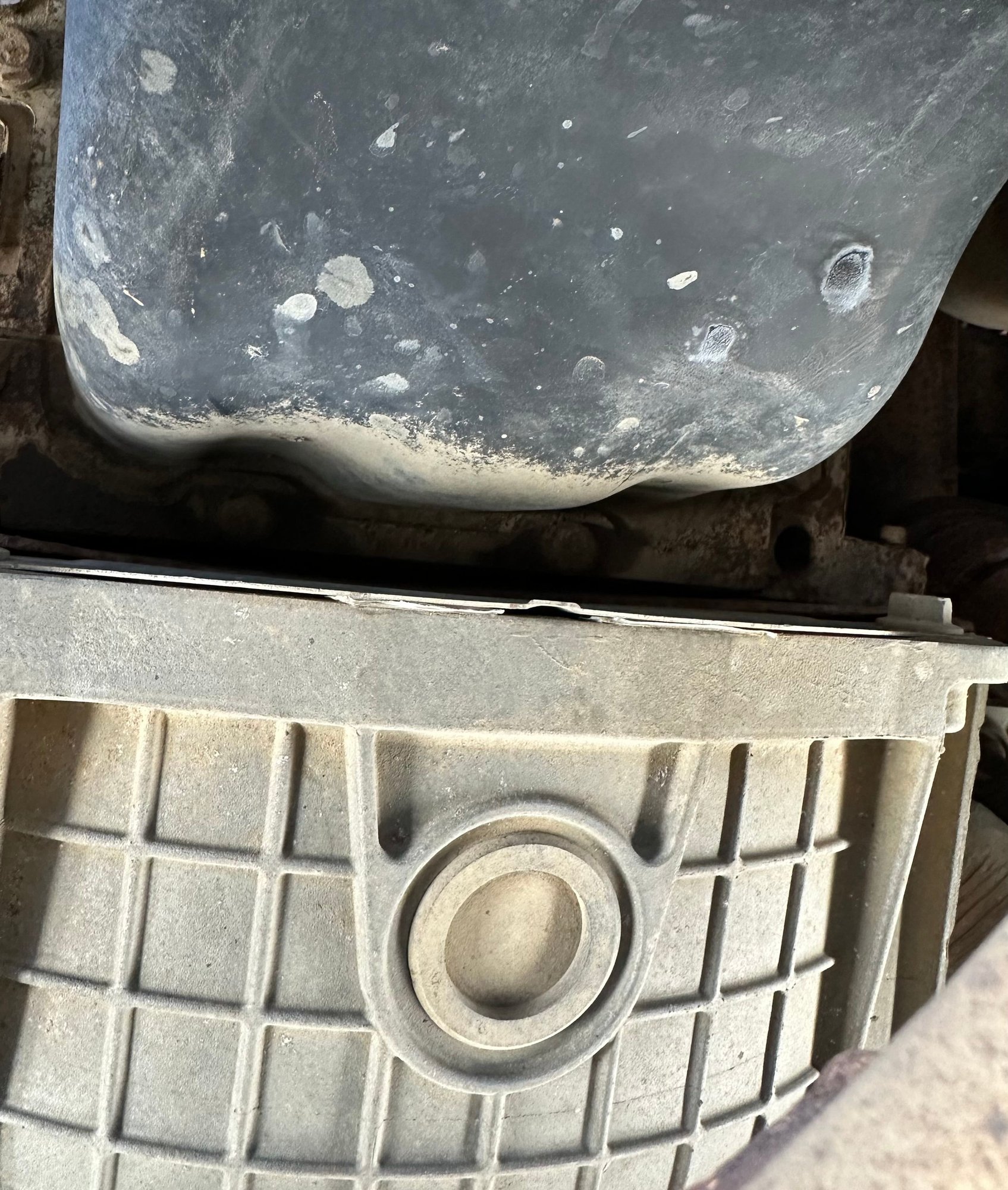

Even though it started after Y pipe install and you’ve checked all exhaust connections, have you ruled out the heat shield on the front of the transmission? Mine had an annoying metallic/flutter rattle at ~2000 RPM especially under a load.
I added some double sided tape (between shield and transmission) almost a year ago and it’s been quiet since. Others have physically bent the shield with good results too.

I see what you mean from the pictures - thanks. I slipped underneath and took a look. I can't say the heat shield 'feels' loose at all, but I can see how maybe that space between the two mounting bolts could contact under certain conditions and rattle. I created a rubber wedge and sandwiched it in there so that there is no play at all and no metal contact. I'm going to wait a while before road testing it so that everything is as cold as possible for accurate results.
