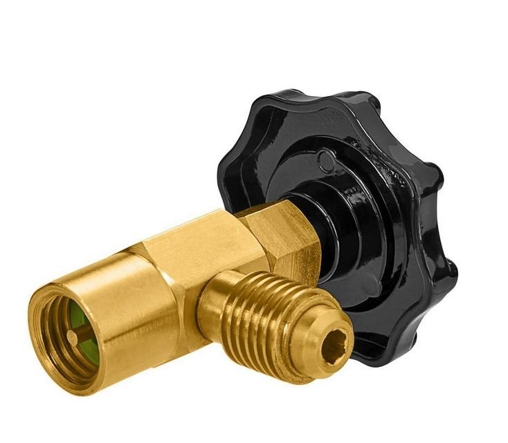

You can buy just 1 can with a reusable hose then the other cans without a hose. If you using a manifold you will still need a can tap.

Those $10 134A cans at Walmart are what you need. They are labeled 12oz. Three will near fully charge your system, like 94% I think. You need one of those brass can taps or get a good side tap from Robinair
