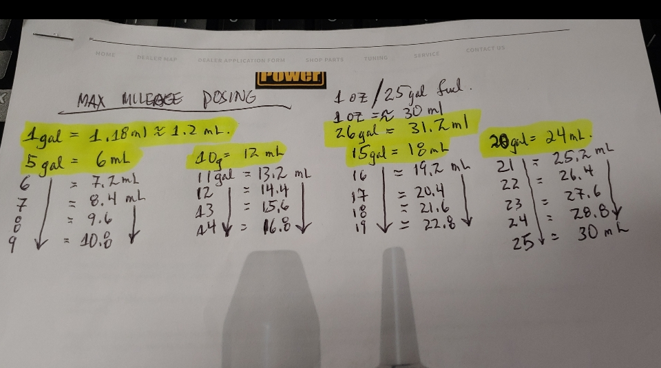

That's the thing with that FBC (fuel borne catalyst), you CANNOT or rather SHOULD NOT overdose it... So Pittsburgh Power sells the syringes right on their site...
This is the bottle I have... same thing. I want to be fairly accurate with the dosing, so using the syringe is more exact.
Here's the dosing I figured out...
