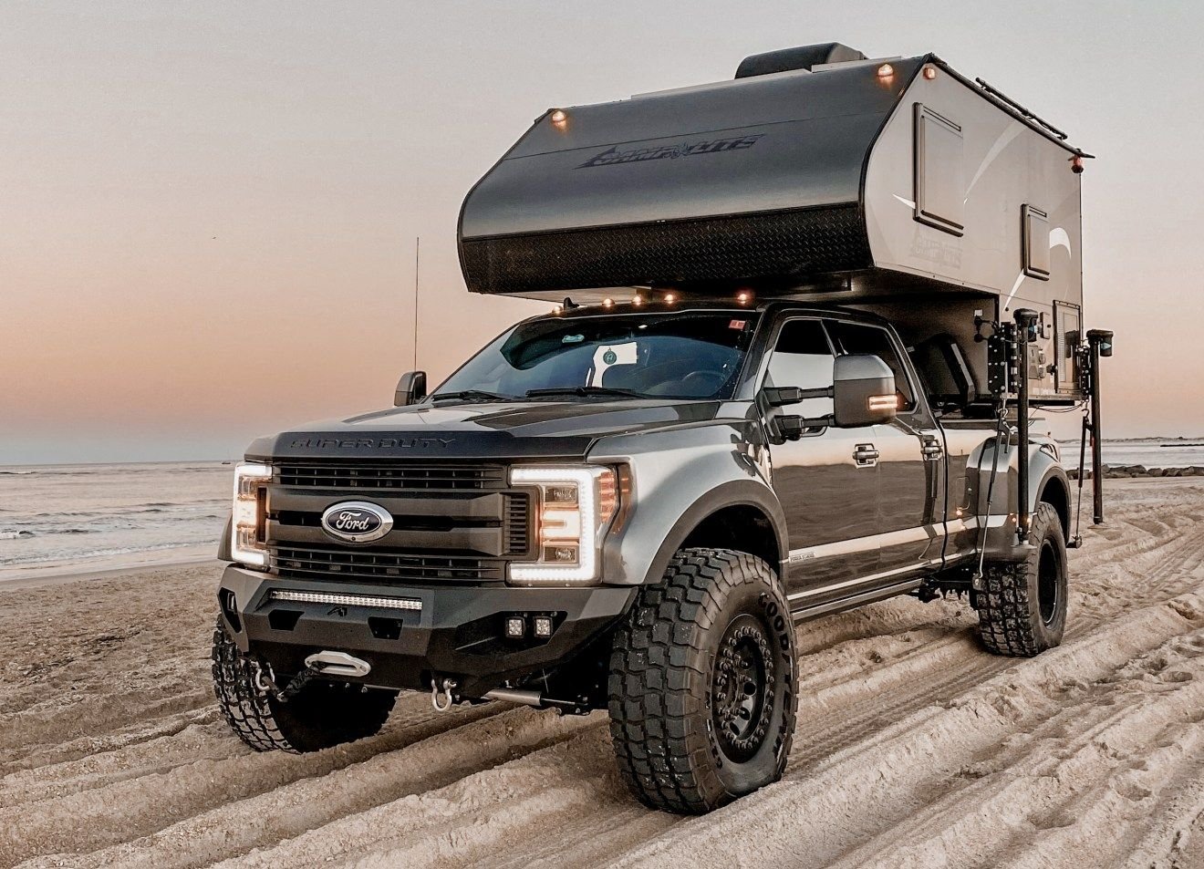

I want to use a slide-in camper—all of which seem super heavy, especially when counting the wet weight. I have had a 2002 CC DRW 4x4 with a lance, big boy camper. It was overloaded, and I won't make that mistake again. The new duallys have 5-6K payload, so if I use a 2K camper and all the fixings, I will be about 3.5K in payload and room to do want I want. I prefer to be as close to 1/2 max payload. The truck will handle much better, especially off-road.
Also, I would like to use a "super single" to help with off-road use. I am looking at Super Single Wheels - 1st Attack Engineering.
Many people are doing a 550 and liquid springs but that would add 30K to my project.
Any ideas would be great.
