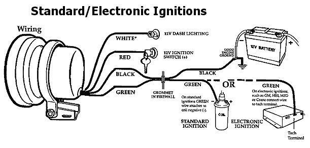

OEM coil elec C clip has a place (elec connector) to connect the tach, it even says TACH on it, they are pretty basic wiring. Most aftermarket stand alone tachs have a 4,6 or 8 cly setting on the back.

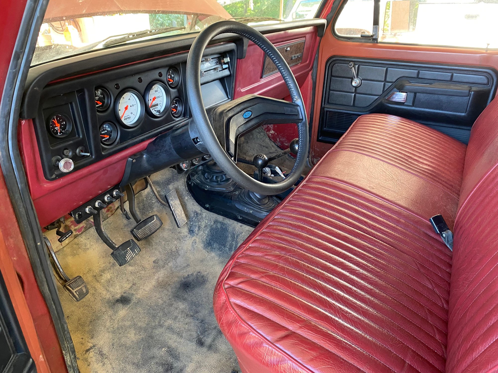

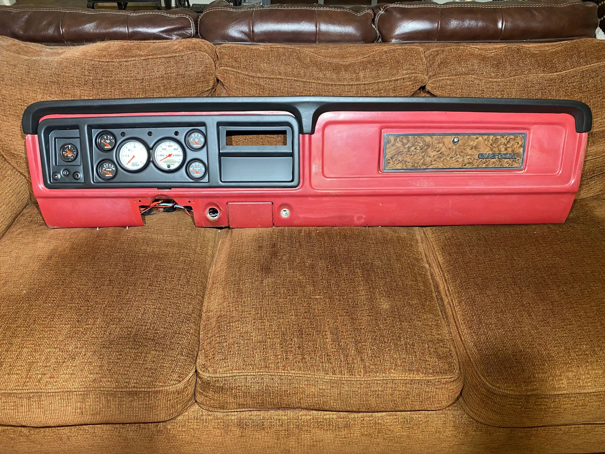

I don't recall ever seeing a Dent with a factory tachometer cluster. But you can do this....
