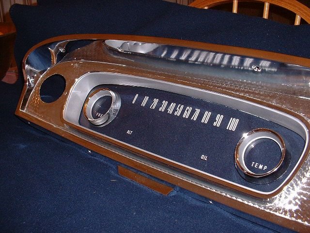

In 1965 and 1966, standard cabs had round gages, while the higher trimmed/badged Custom Cabs had what is known as the sweep speedometer. But one member here owns a truck whose original owner specified round gages in his Custom Cab .

I have a 65 custom cab and I am using the round gauges because I think they look better and the bezel is steel not plastic. Just my two cents

Good idea about steel bezel vs the plastic as the plastic is virtually impossible to rechrome correctly now. I had mine done way back in 2009 by a business specializing in this stuff but is now gone.
