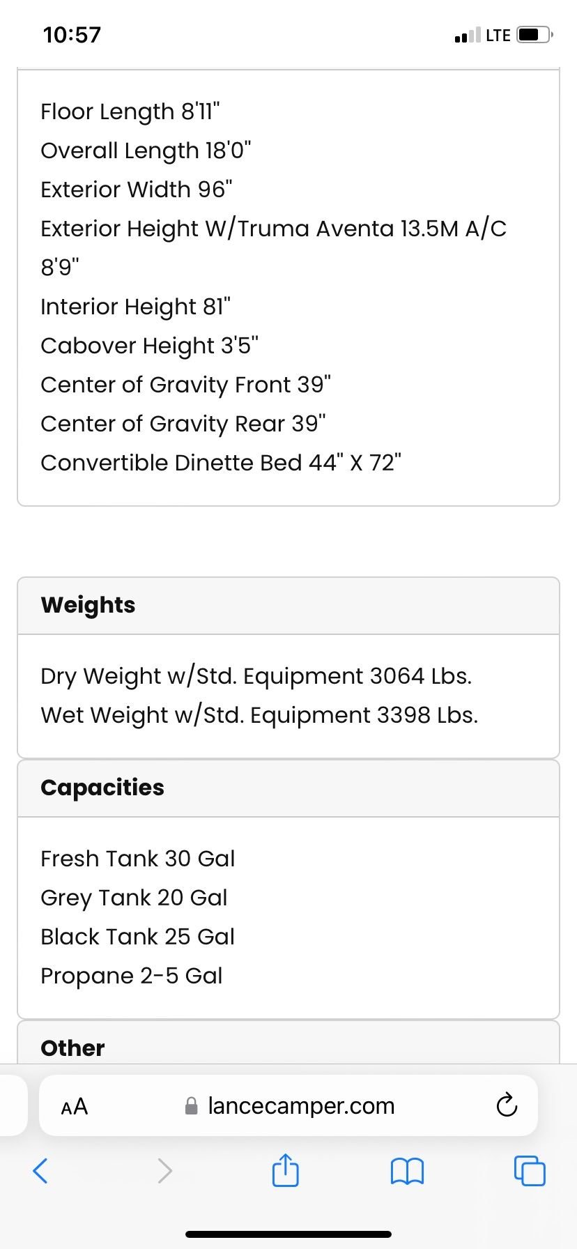

I bought a 2022 F-350 7.3 CCSB about 6 months ago with the intention of pulling a 5th wheel. Lately I have been looking at some slide in campers. My questions are
1. Is this still possible since I didn’t order the camper package .
2 I am running the factory 20 in wheels, does this affect me too.
3. I know it wouldn’t have Fords certification or could you get one if you upgraded parts?
Can I still use a slide in in this truck and if so what upgrades would I need to do yet.
And I do know that I am or would be limited to lighter and smaller campers, my payload is 3900 pounds.
Really liking the Lance 855s
Thank you for any replies that you may have. Worst case scenario is I just keep my 5th wheel plans

I had a Northern Lite 8.11 SE on the truck in my signature for 5 years until I sold it last year. Fully loaded and wet my camper weighed between 3600-3800 lbs. My truck hauled it beautifully. I loved that camper and so did my wife but after having a hard side camper, I really felt limited as to where I could take it. I do a lot of hunting, fishing etc. and there are a lot of places I go that I could just not get to with the hard side camper.

The Lance 855s is a nice camper and heavy. Even a 5th wheel will test the trucks ability for SRW depending on size and weight. Maybe you could test drive one or ride with someone to see how it feels.

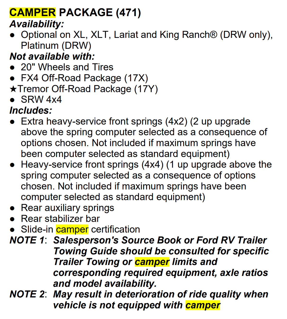

Seems to me the camper package offers little more than a factory rear sway-bar and slightly upgraded front springs. The big-wig posted above looks like a must if your truck lacks a sway bar. A camper load sits with its load almost entirely (if not more) on the rear axle, so the front spring upgrade seems of little or no value. And with the short bed, your centre of gravity may end up slightly behind your rear axle, taking some load off the front axle. I suggest you scale your rear axle to see exactly how much capacity you have, since your stated payload includes both front and rear capacity.

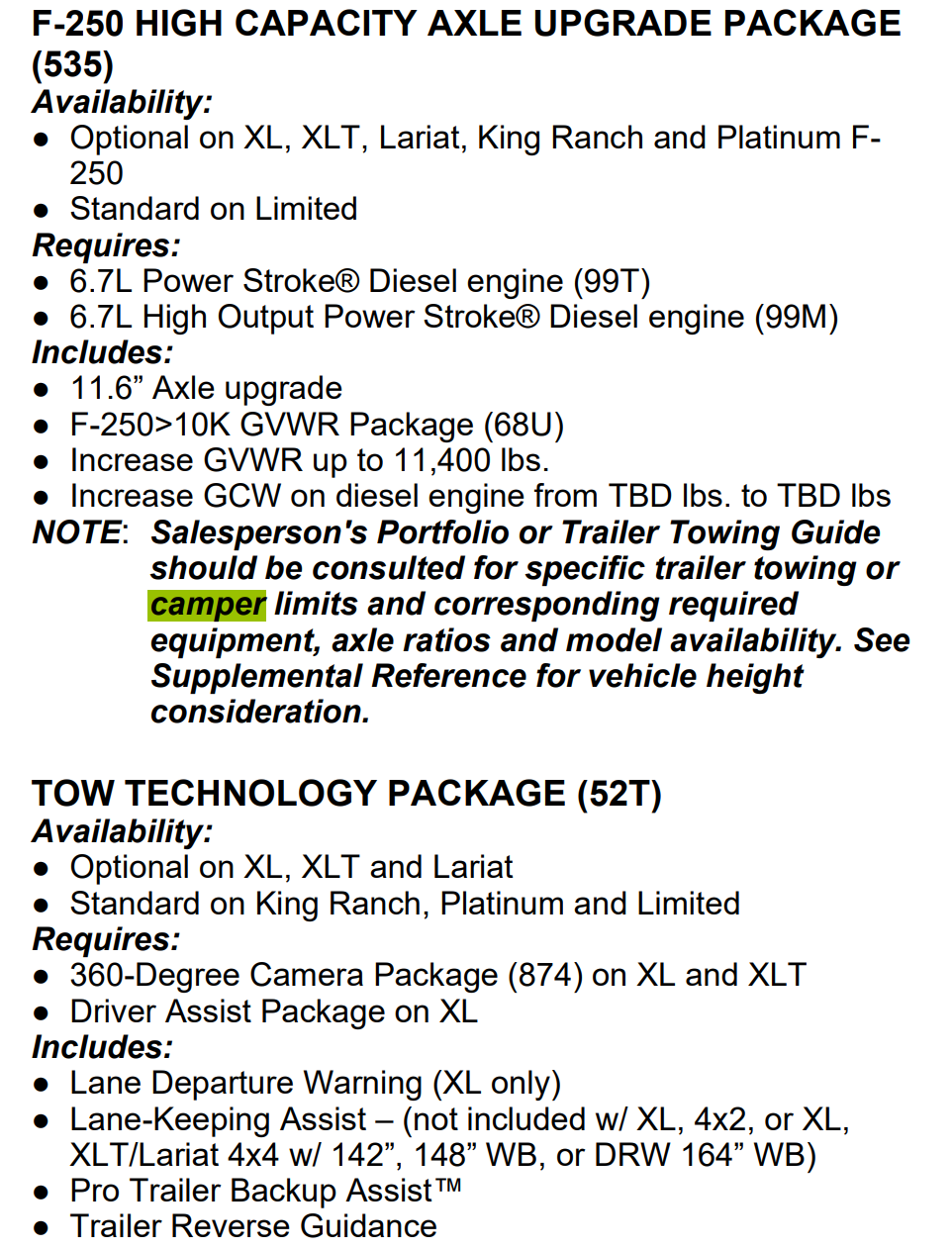

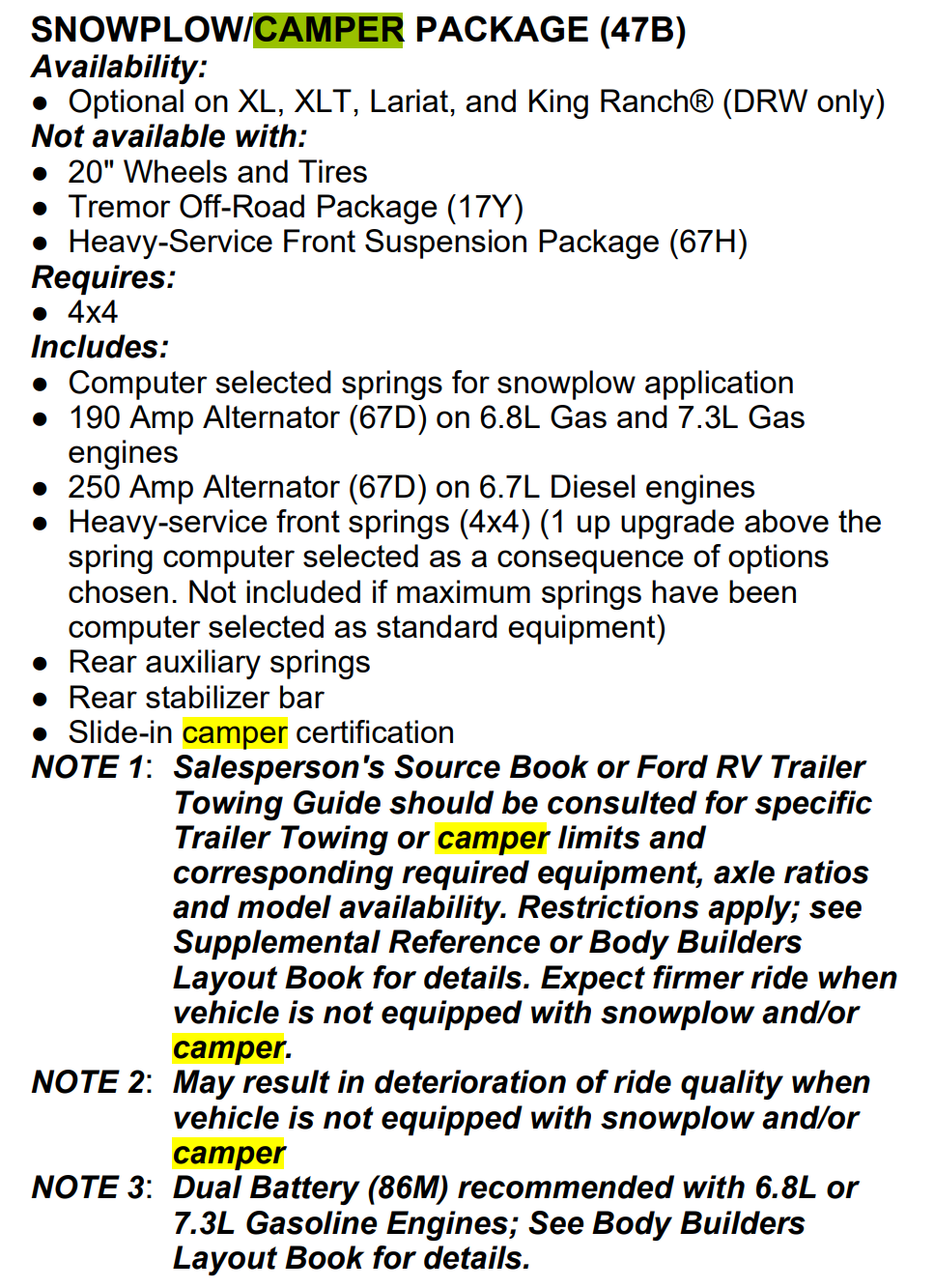

Perhaps the 2024 order sheet will help the OP with what happens to the factory build for the camper certification. I've grabbed 3 cuts from the order guide shown below.
