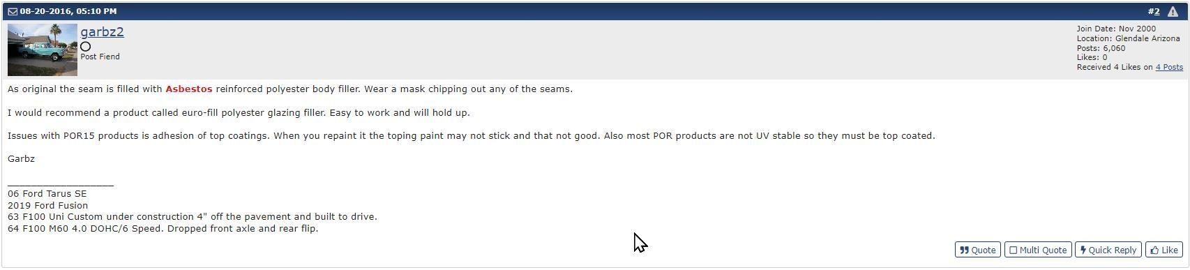

Doing a bit more research on this and discovered this post saying there would have been asbestos in the seam sealer. Does anyone know definitively where on the truck seam sealer would have been used? Yes, I know, the seams, but I need specifics here lol

I've worked in and around the auto body and old car restoration business for 45 years and no where have I ever run into any body filler that had asbestos in it. Finished seams, like roof to quarter panel and A pillar were finished with lead well into the 80's. Seam sealer is going to be found in the drip rails, the seam across the back of the cab above the back glass, and perhaps in some areas of the cowl. These areas will be covered by paint and no one will know what's underneath without digging into a finished paint job.
This whole subject begs the question, what is the verification process used by the Australian government to ensure compliance? Is it just a form you sign attesting to the fact the vehicle is asbestos free? Are they going to take the truck apart to investigate? Brakes and clutch is going to be the likely sources they'll be concerned about as those were known parts that contained asbestos 50 years ago. Not so much lately. If there was anything in any seam sealer or filler, and I highly doubt there is, it's going to be covered and sealed by the paint and won't cause a health concern. Anyone grinding into your paint will make a bigger mess than asbestos would be.
