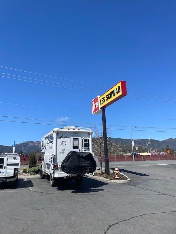

So the kid says to hold tight and splits for a few and comes back with 8 open end lug nuts that he removed from an old non working vehicle out back and gives them to me to use, no charge by the way.
So I ask him if there's a Discount Tire around these parts and he says no but there's a Les Schaub about a 1/2 mile down the road and he already called them to see if they had my exact tire that I was running and they said yes they did in fact they have a dozen.
So I pull out a couple of 20's and stuff them into the kids shirt pocket and shake his hand and tell him how much I appreciated his effort and then dropped the blown tire on my entry step ( fox landing ) made sure the lug nuts were secure and dropped the jack and left for Les Shuab down the road.
Pulled in and spoke to the lady behind the counter and they could get started on it right away and the indeed have (4) Toyo Open Country MT's 35 x 12.5 x 18's load range "F" in stock.
So 2 hrs and $2,500 bucks later we were back on the road headed north with all new skins.
