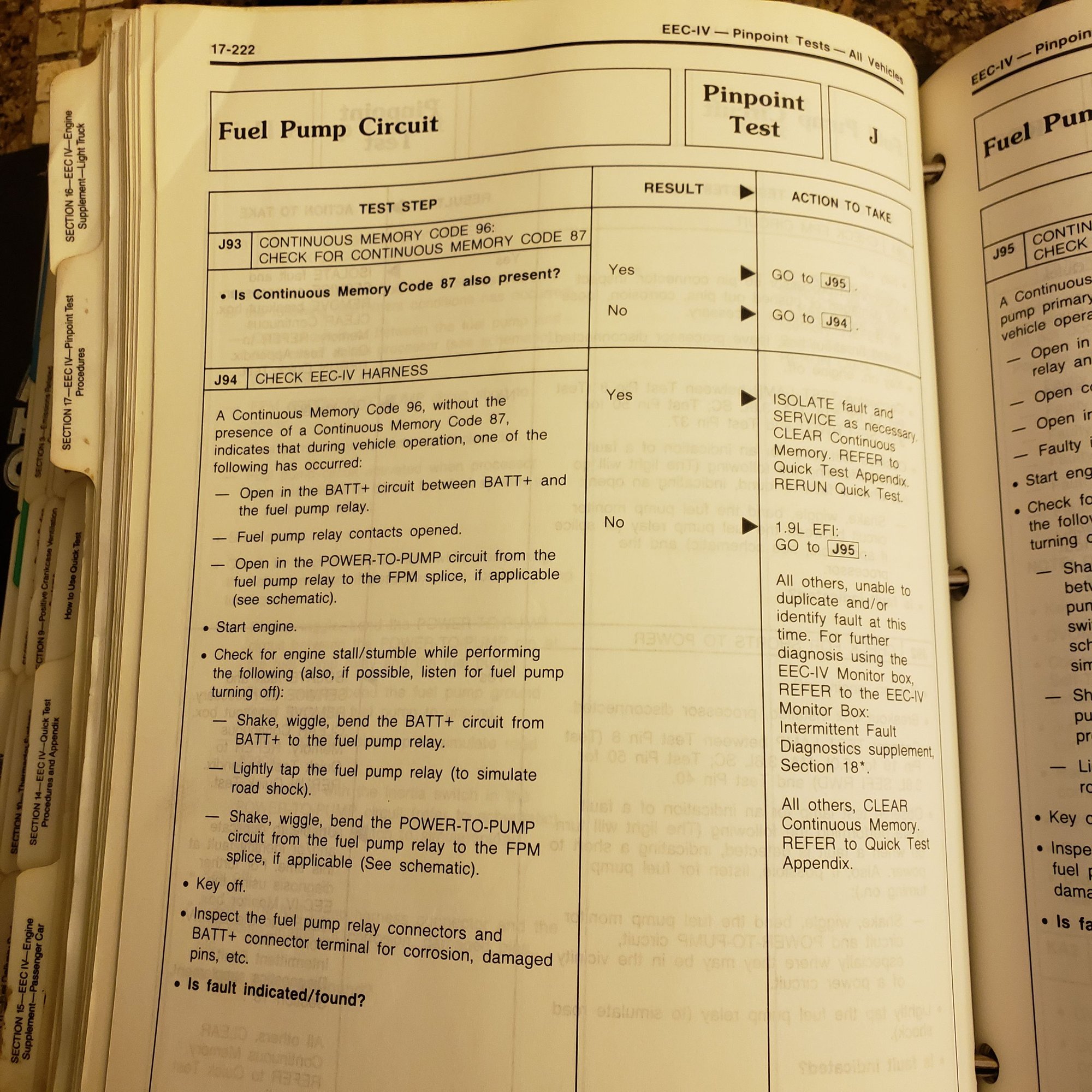

1988 f350 460 efi. A lot of new parts started trying to stall or die easy and runs a bit richer but that seemed to have been a consiquence of what evers not working. It hasent actually died just does for a second then runs fine. On the high way theres no problems unless its stop and go. And check engine light is off on high way. Self test codes 22 33 96 98. Map has pressure contion rest eec reset no change. Im concerned about 96 if anyone has insite its much appreciated.

How are you getting your codes?
There is no 98 code for yours
This should get you started

Old May 17, 2023 | 07:39 AM
manicmechanic007's Avatar
manicmechanic007
Joined: Jul 2020
Posts: 10,533
Likes: 2,660
From: Near Salt Lake City
Old May 17, 2023 | 07:43 AM
manicmechanic007
Joined: Jul 2020
Posts: 10,533
Likes: 2,660
As you can see from that J94 test, you need the proper 88 schematic to see if yours has the splice to the FPM
You are looking to do some wiggle testing
Good luck
007

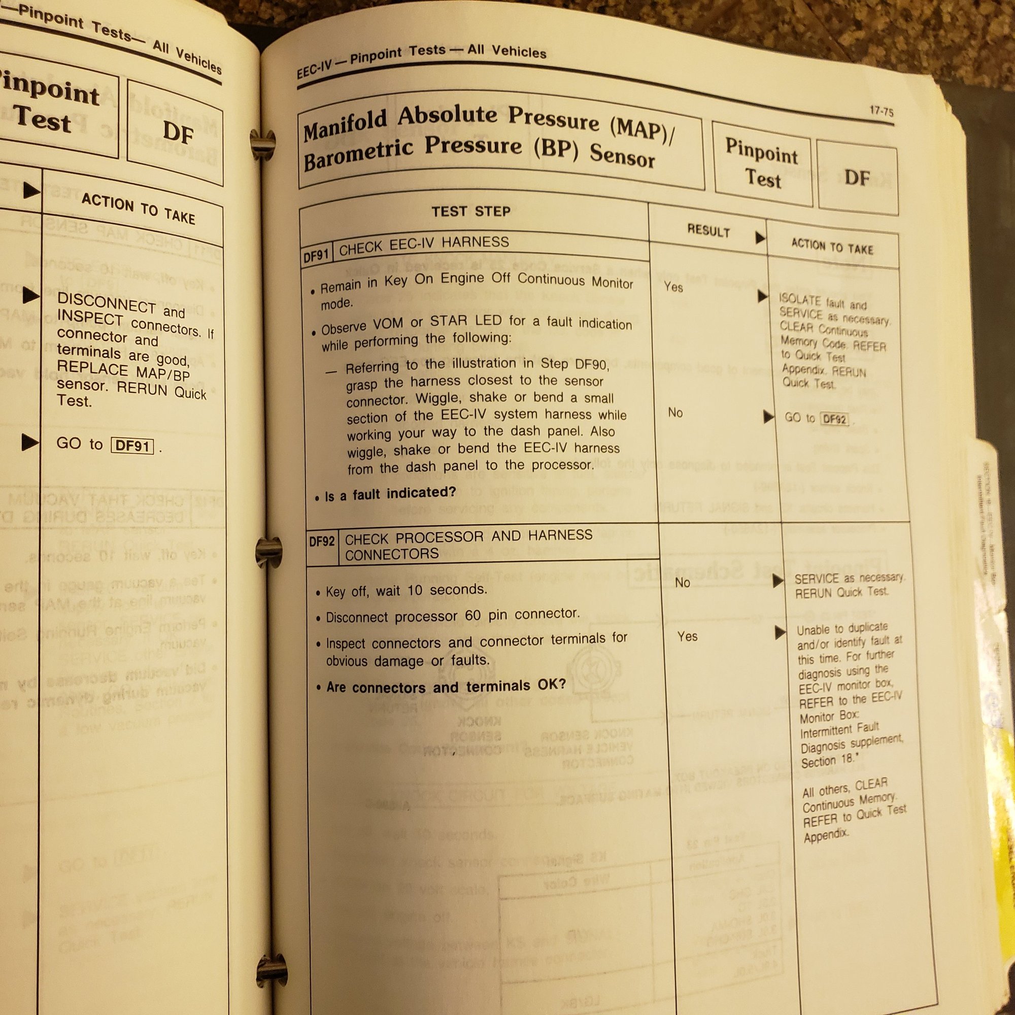

You will have a hard time with DF 90 to DF 93
Getting a vacuum pump (on the MAP) to 25 inches is difficult / impossible
Substitute a known good map sensor is the test
Plug in a new MAP and watch the 22 go away

Old May 17, 2023 | 08:26 AM
manicmechanic007
Joined: Jul 2020
Posts: 10,533
Likes: 2,660
Old May 17, 2023 | 08:29 AM
manicmechanic007
Joined: Jul 2020
Posts: 10,533
Likes: 2,660
If you do not have a problem before performing DF91, you will after on an old truck
You hope the new map fixes it
