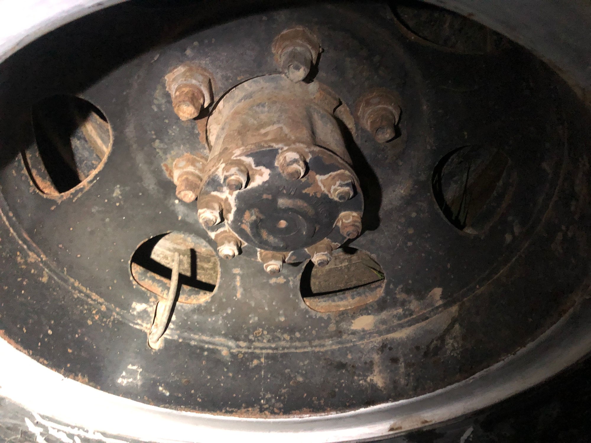

Hi all, I just picked up this F600. I plan to fix it up and use it a bit.
I think it has the Widow maker wheels. It looks like it has 3 WM wheels and 3 standard lock ring wheels.
The front driver looks like lock ring not all the way down in the groove, all hold air but are trash.
