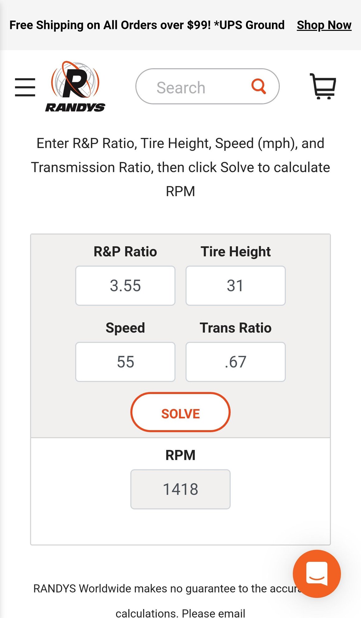

The oversize tires should lower the RPM's from stock size. You can do some math and calculate the RPM based on gearing and tire circumference. Research the trans to find out the ratios for each gear and calculate the RPM's you should turn for whatever speed you want.

That is high. Perhaps a previous owner swapped the rear end or the rear end gears. Crawl under your truck and try to read the stamped metal tag bolted to the differential cover. It should say something like 3 55 or 3L55 if it's limited slip. I bet it's say 4 10 thou.

The calculation for that is the attached photo of the calculator. I did 265 tire that’s what Google said was the equivalent of 31”. But if I do it with 4:10 gears it says 1500. The tach is accurate at idle.
So I’m confused with it being 2200. But I’ve counted the shifts and it reaches overdrive.
