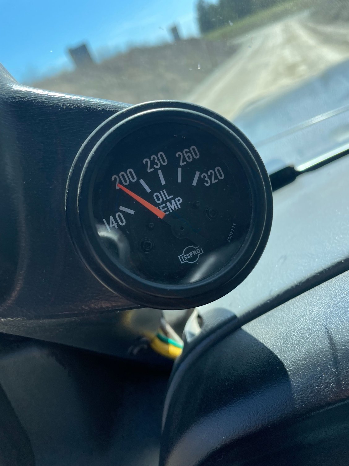

Hauling gravel out of a pit that has a steep hill for 1/2 mile. By the time I get to the top my trans was at 240°F. Using 1st gear. High range.
If I use 4 low will it help or get worse?

I tried it. Seemed to work. Stayed below 200 this time. Later in the day and warmer out too.
