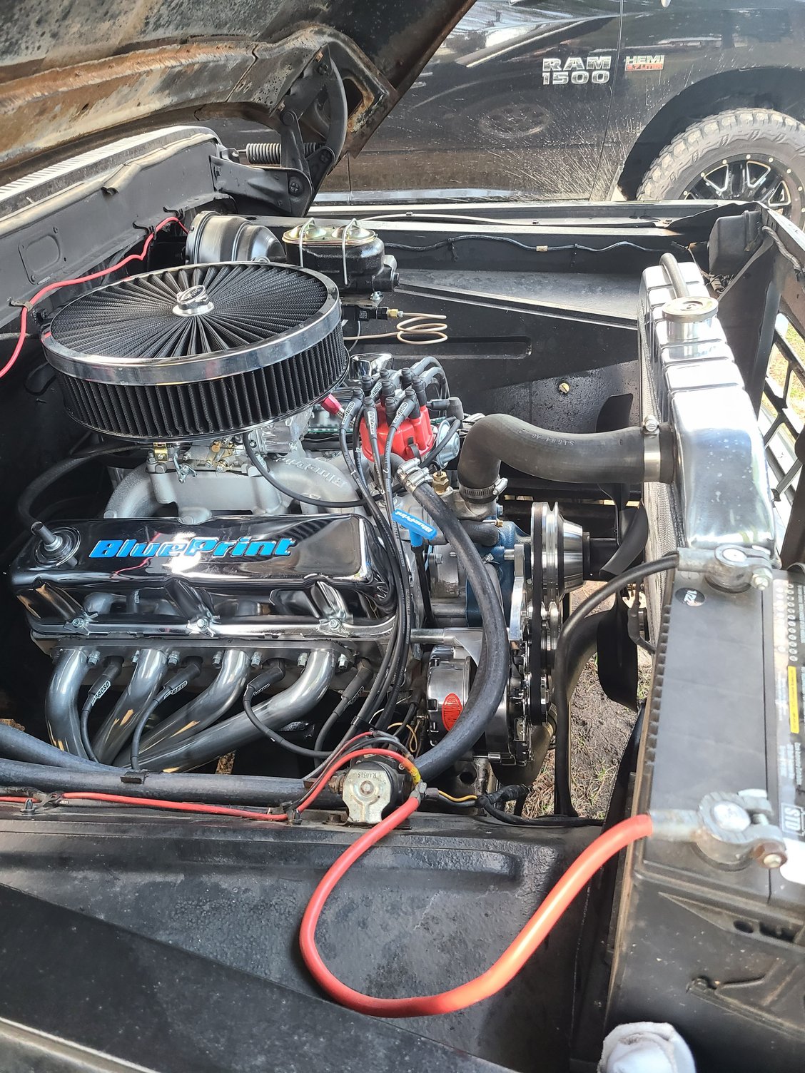

Originally Posted by DaveDe
What headers will fit on a 1965 F100 with a 351 Windsor?
I just swapped my 240 for a 302 crate and had the same problem on my 65 f100. I ended up going with Sanderson FF2s. It was the safer option for the passenger side frame and they did fit. The one problem I had was I bought a crossmember back exhaust kit from Pypes. I had to take it to 2 different exhaust shops to find someone willing to make the intermediate pipes. It's extremely tight.
good luck
