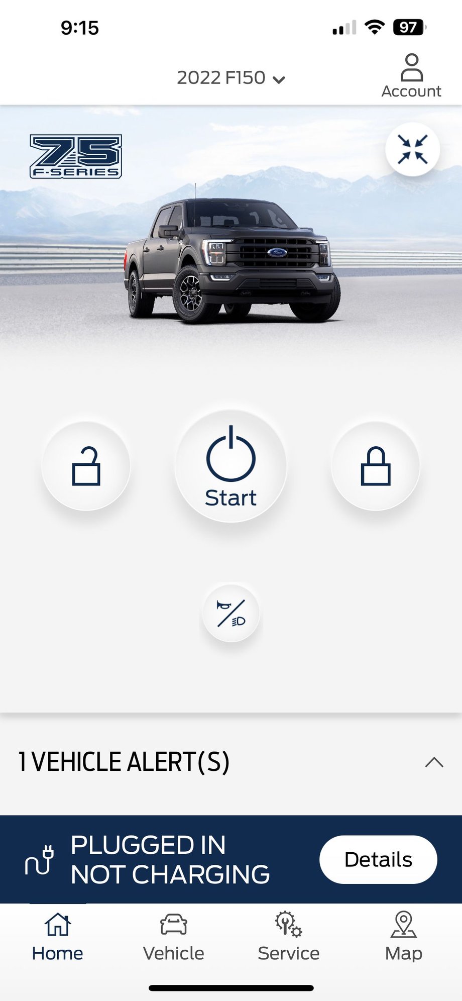

I looked at my Ford app and I received an email from Ford in the Message Center saying they applied a new update to my F150. Couple of things Ford needs to work on:
1 When the message you sent has an Update Details button make sure it works.
2. Why would you put this at the bottom (I'll call it the Home Page for my Truck) 1 Vehicle Alert(S) PLUGGED IN NOT CHARGING?
I don't have a Hybrid or Electric truck. Mine is a 3.5 Eco Boost.
Ford put out an APP Update, problem fixed. I was hoping that the Ford rep on this site would saw this post.

I have that stupid message at the bottom of my home screen, too. Mine is powerboost and it only charges when I'm driving!
Edit: Oops, charging message is now gone...
