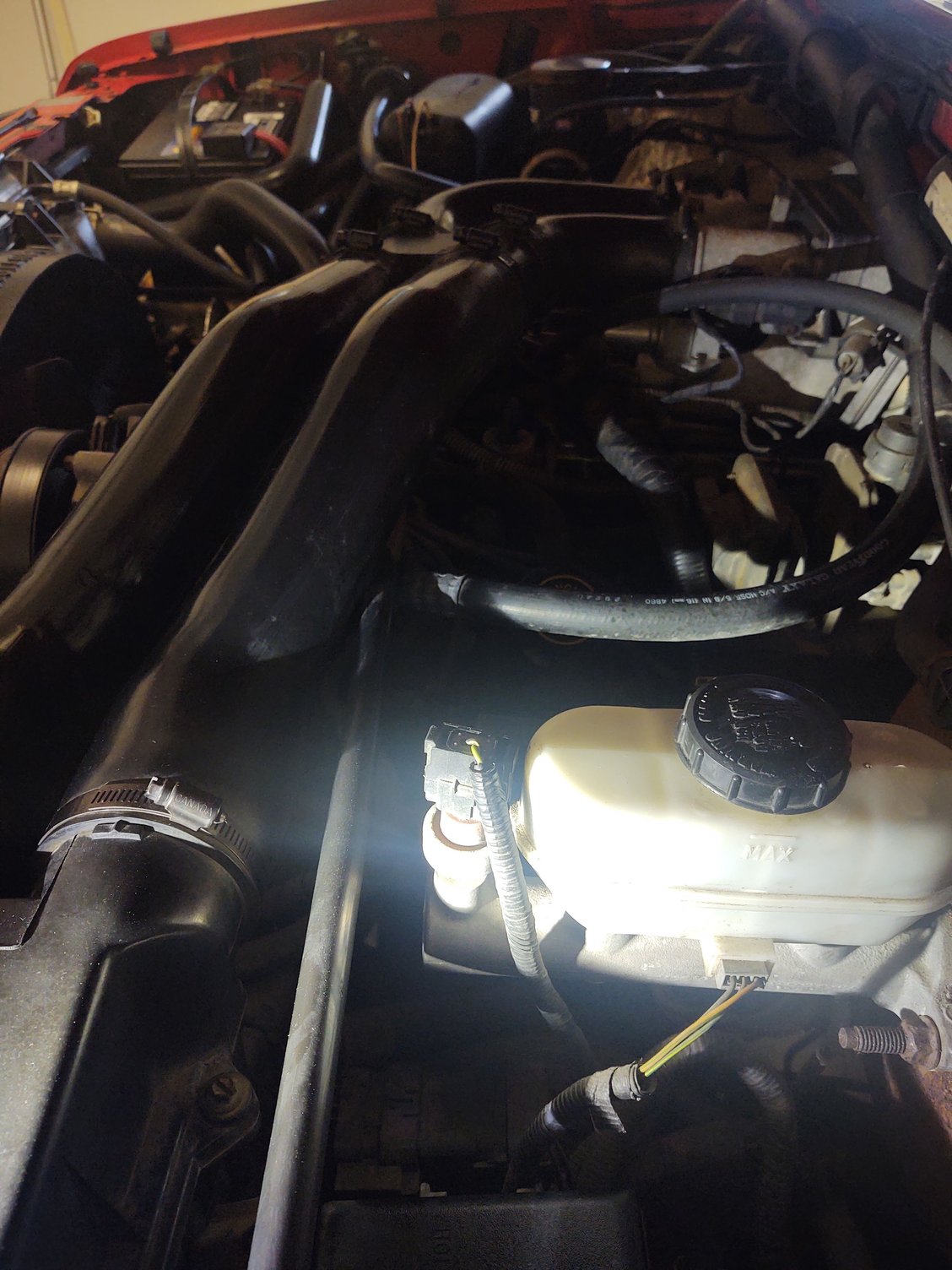

I replaced one a truck years ago but I don't remember the replacement. This 95 F-350 picture appears to be one of the burn em down cruise switches. If so I will buy one online and bypass Ford fixing it. Where can I buy the part as I don't remember where I got mine but it was online. Thanks for the help.
Does this appear to be the proper replacement?

I believe that is the correct kit that includes the updated brake pressure switch. In the meantime...disconnect that fire hazard.

Yes sir. Done. Thank you Randy
https://www.amazon.com/Motorcraft-SW...a-451699707518
all the recall sensors i have seen also come with a wiring harness with fuse in it.
the fuse blows instead of burning the truck.

Tom want to make sure you are saying the picture of the one on Amazon is or isn't the correct part? Thank you.

i never saw one like that, but they claim it is for the truck.

OK Thanks. Amazon shows I ordered this same one back when. As far as I know it worked fine. The details say it is for the recall. I'll check it closely when I get it. Thanks again.
