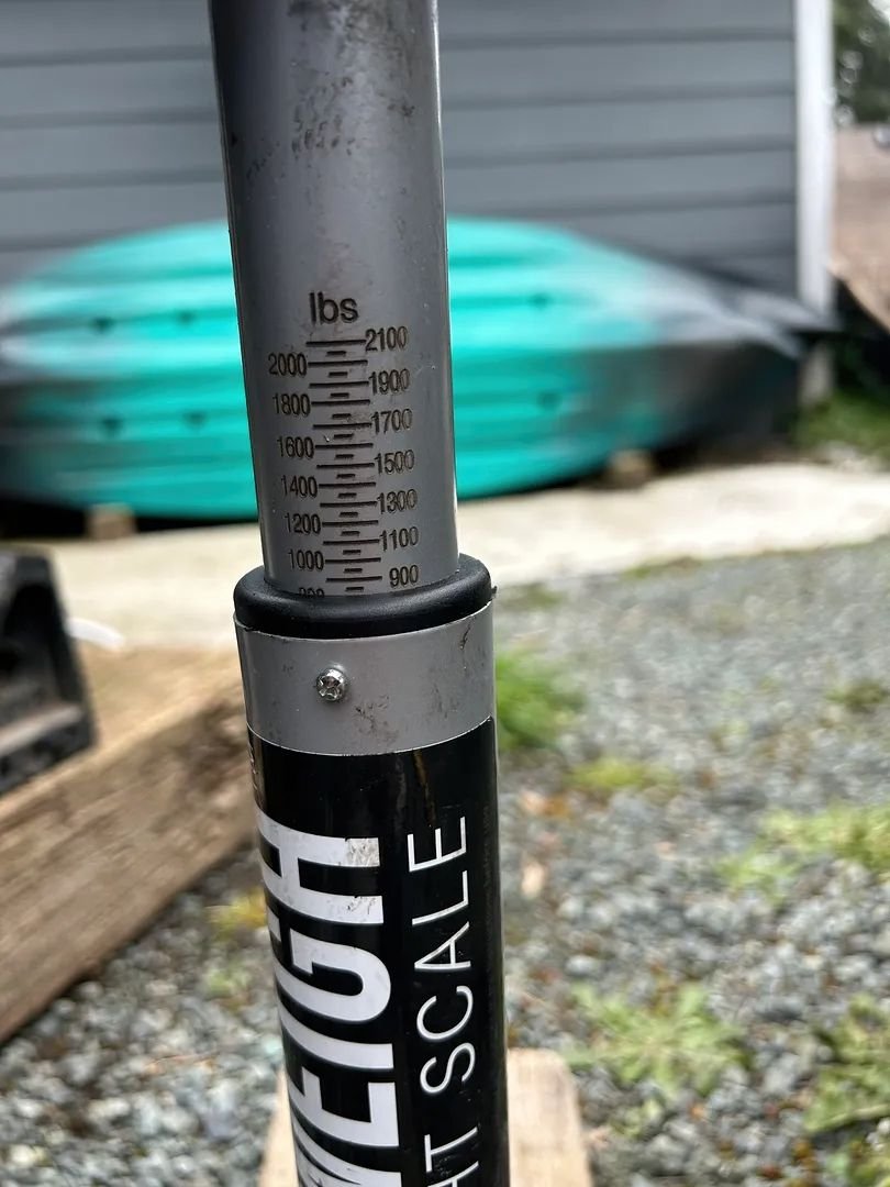

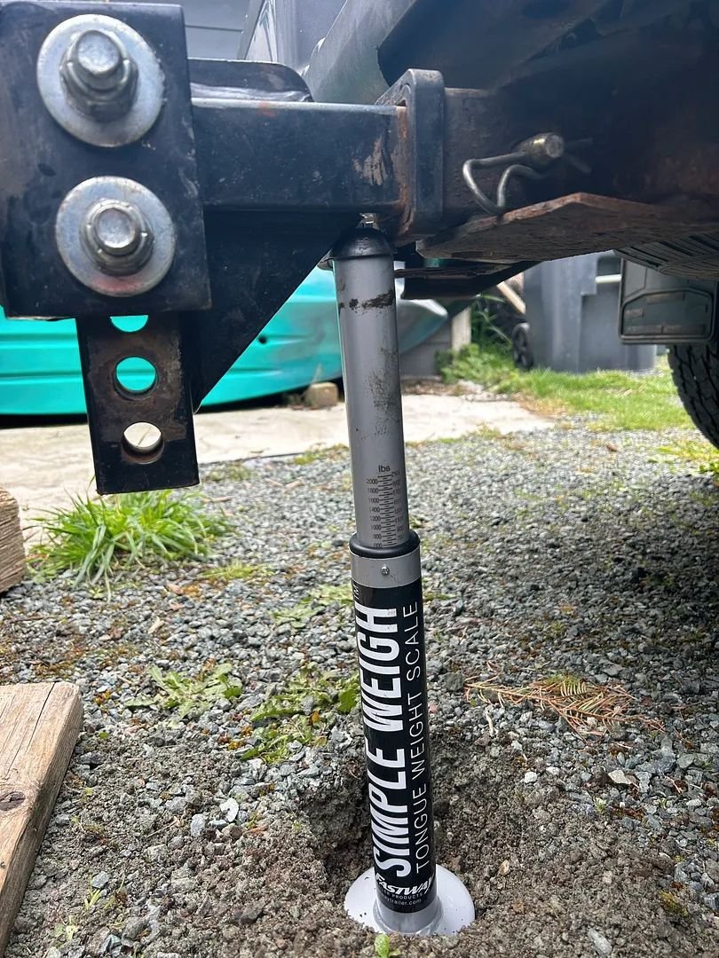

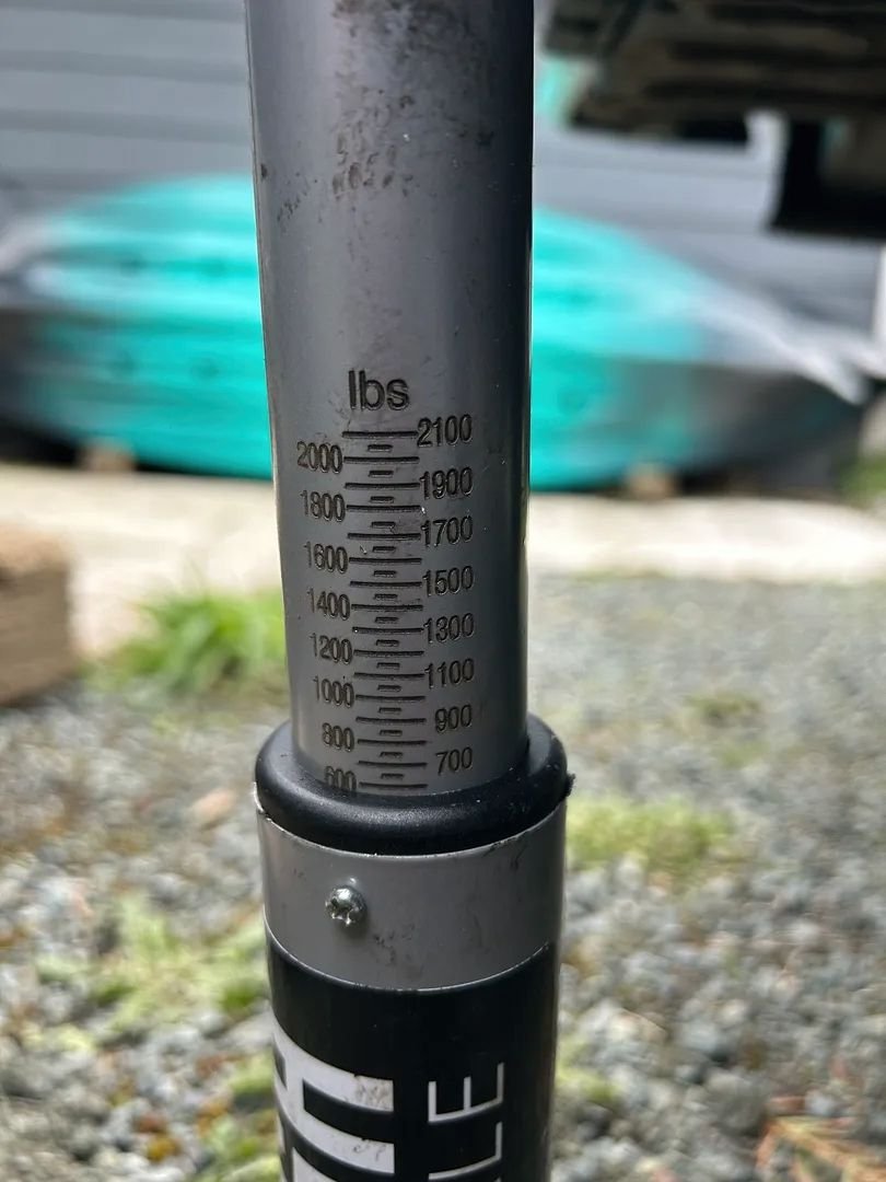

I used this tool to weigh the tongue.
Here are the pictures, and how I set it up.
Why did I lose weight once I hooked up trailer to truck, and I did not put on the bars, just dropped the trailer down onto the ball until the jack was off the ground?

The second picture in the original post looks to me like a scaled tongue weight of about 825. Without knowing the axle weights you can't determine what your percent tongue weight is. If 702 is the published "dry weight" then the scaled ~825 is probably fairly accurate assuming full propane tanks and batteries on the tongue which aren't included in the published "dry weight" figure. As suggested running over a CAT scale when you have a chance would allow you to fully understand how things are loaded and confirm you have an appropriate amount of tongue weight. If for example your fully loaded trailer weight (axle weight + tongue weight) is 6500 the 825 tongue weight would be right in the sweet spot at ~12.7%.

So………not sure how the OP is measuring the weight settling on the truck hitch ??
It appears that the ground is dug out under the scale. If the OP dug that out so he could start the scale at 0, then the truck springs will absorb some of the weight as the trailer tongue settles on the hitch.
