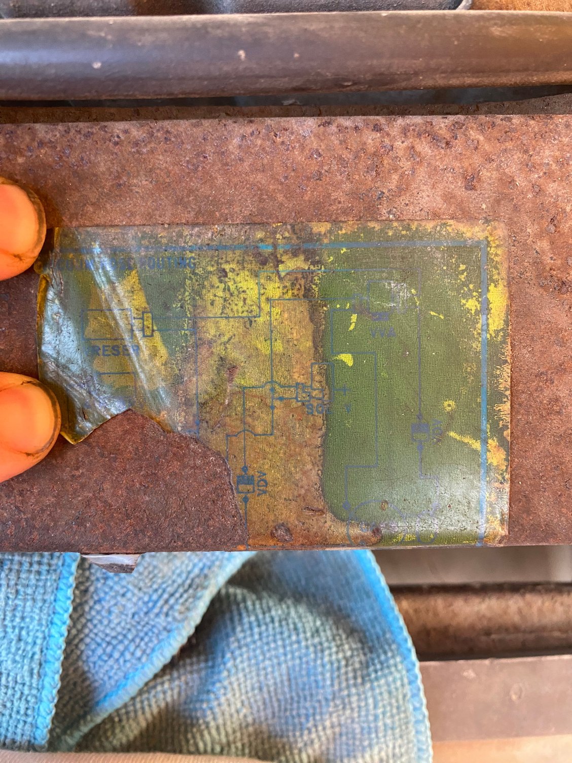

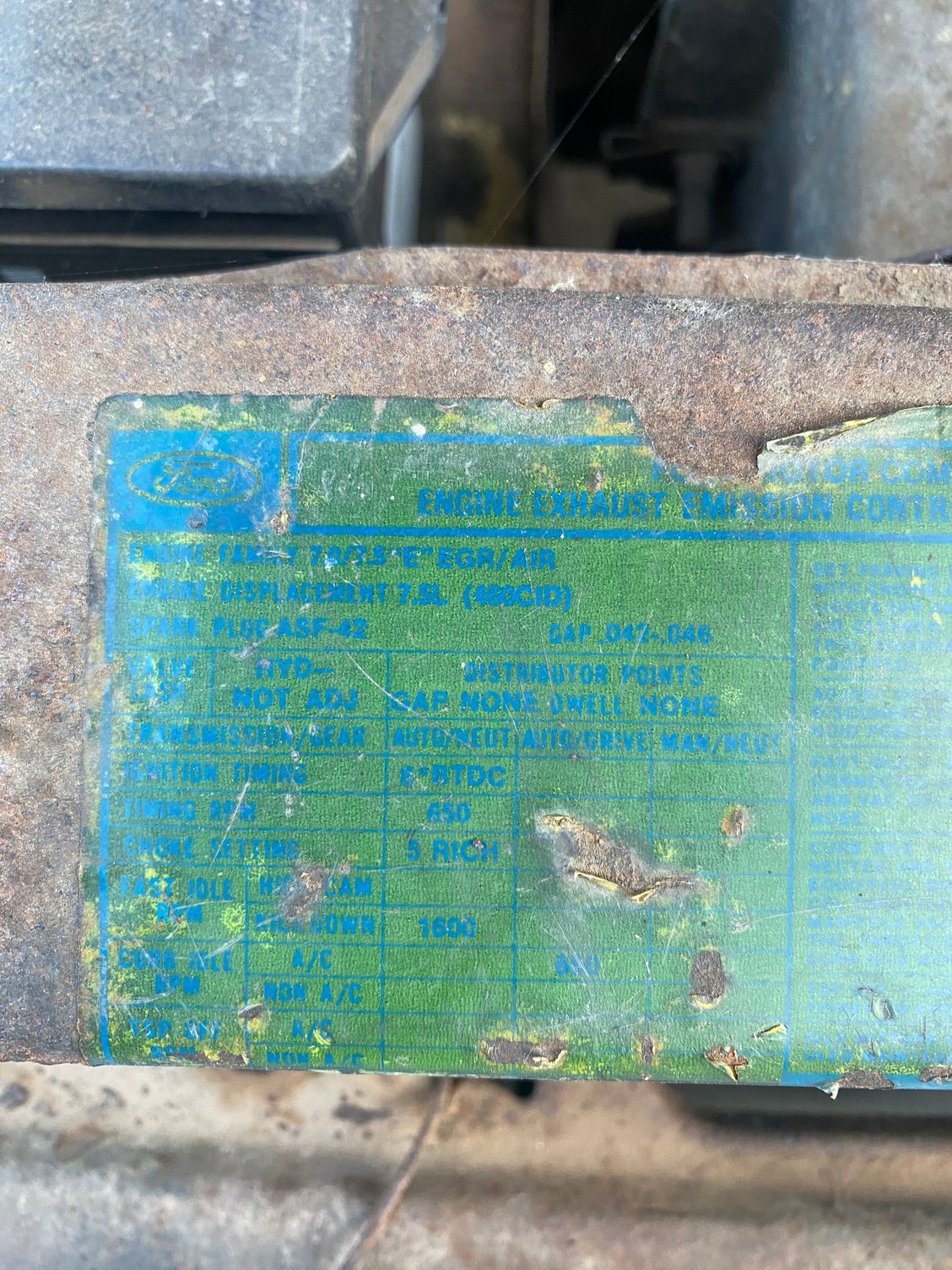

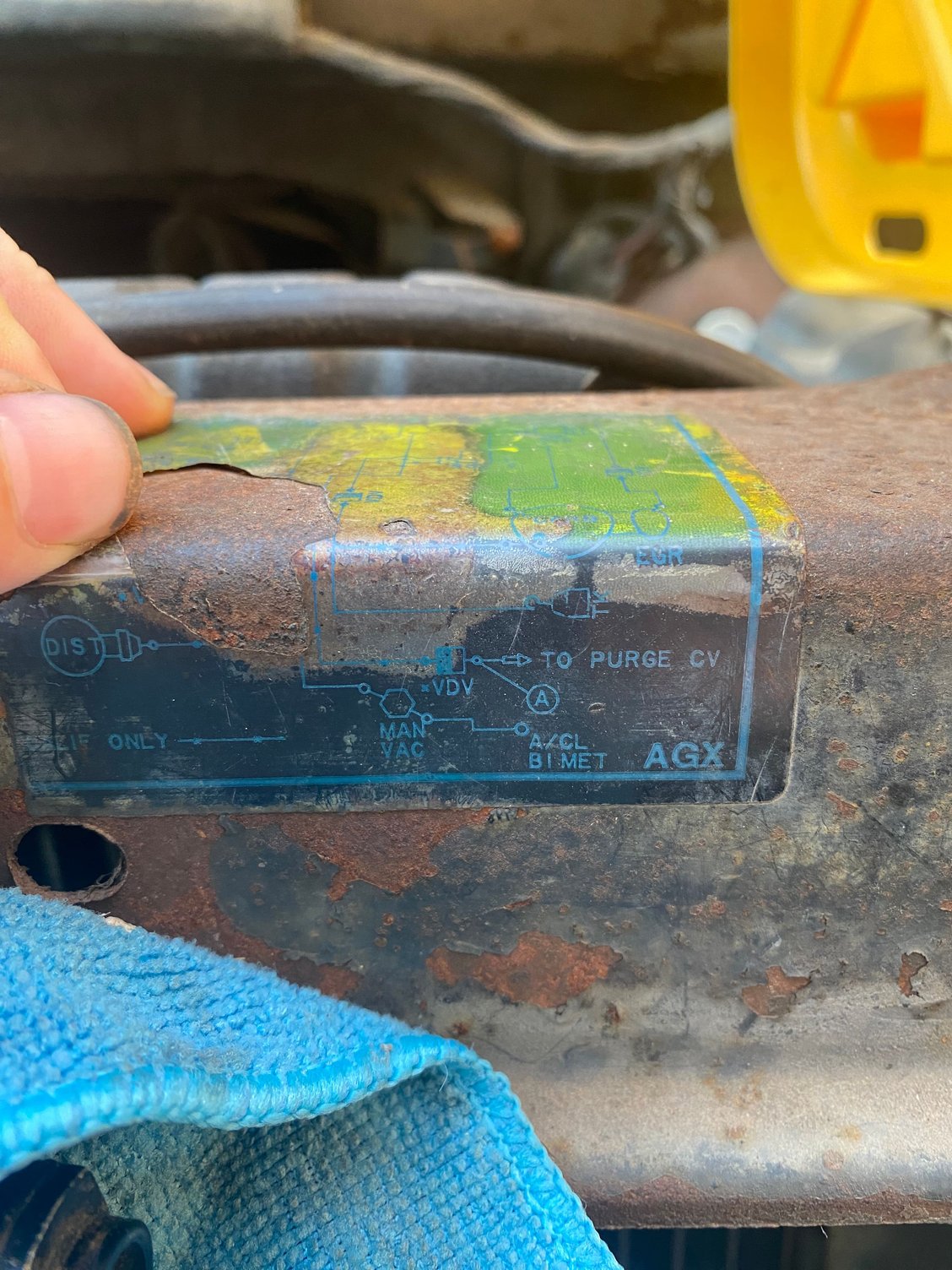

I know this was last year but do you happen to have any photos of the decals on you 79 E350
im looking specifically for the vacuum diagram decal. Mine is not really readable. I’ll attach what’s on mine.
