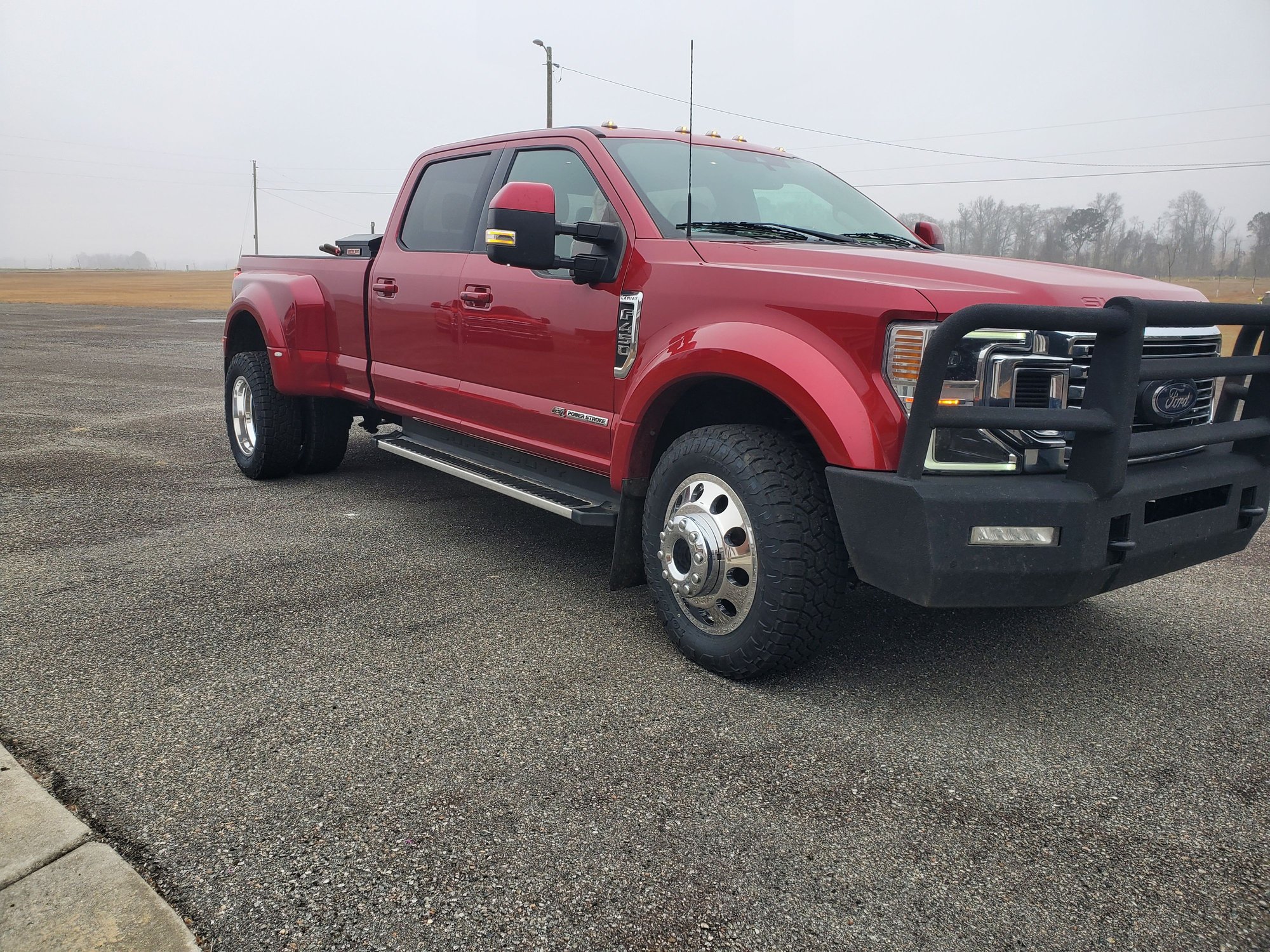

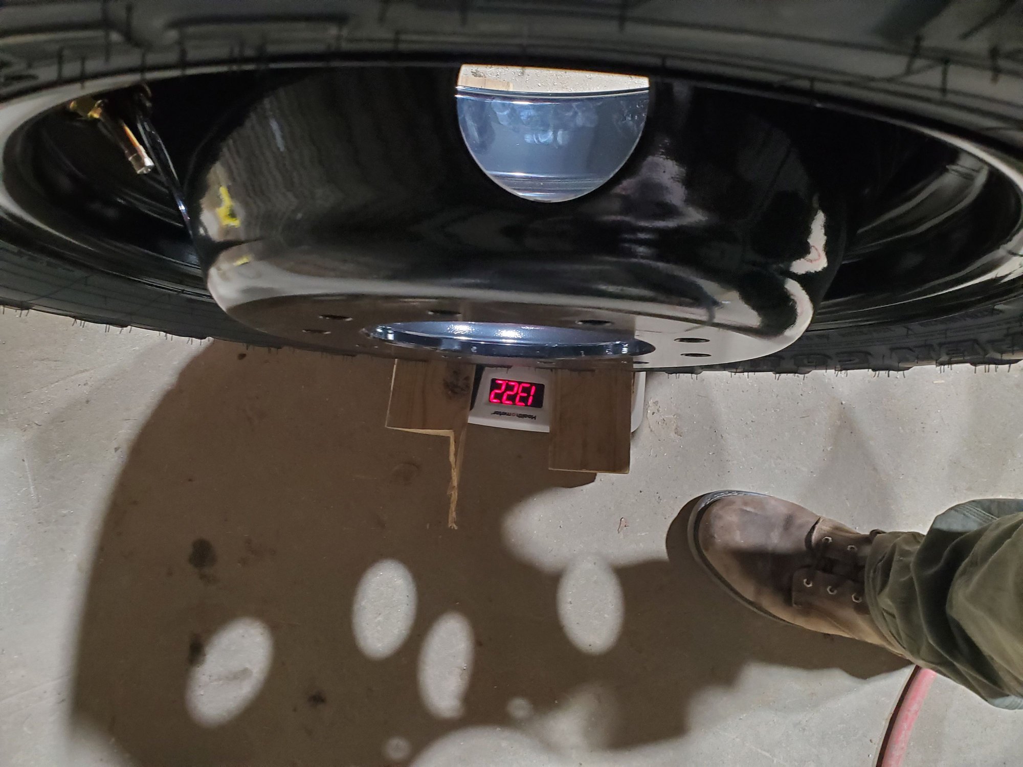

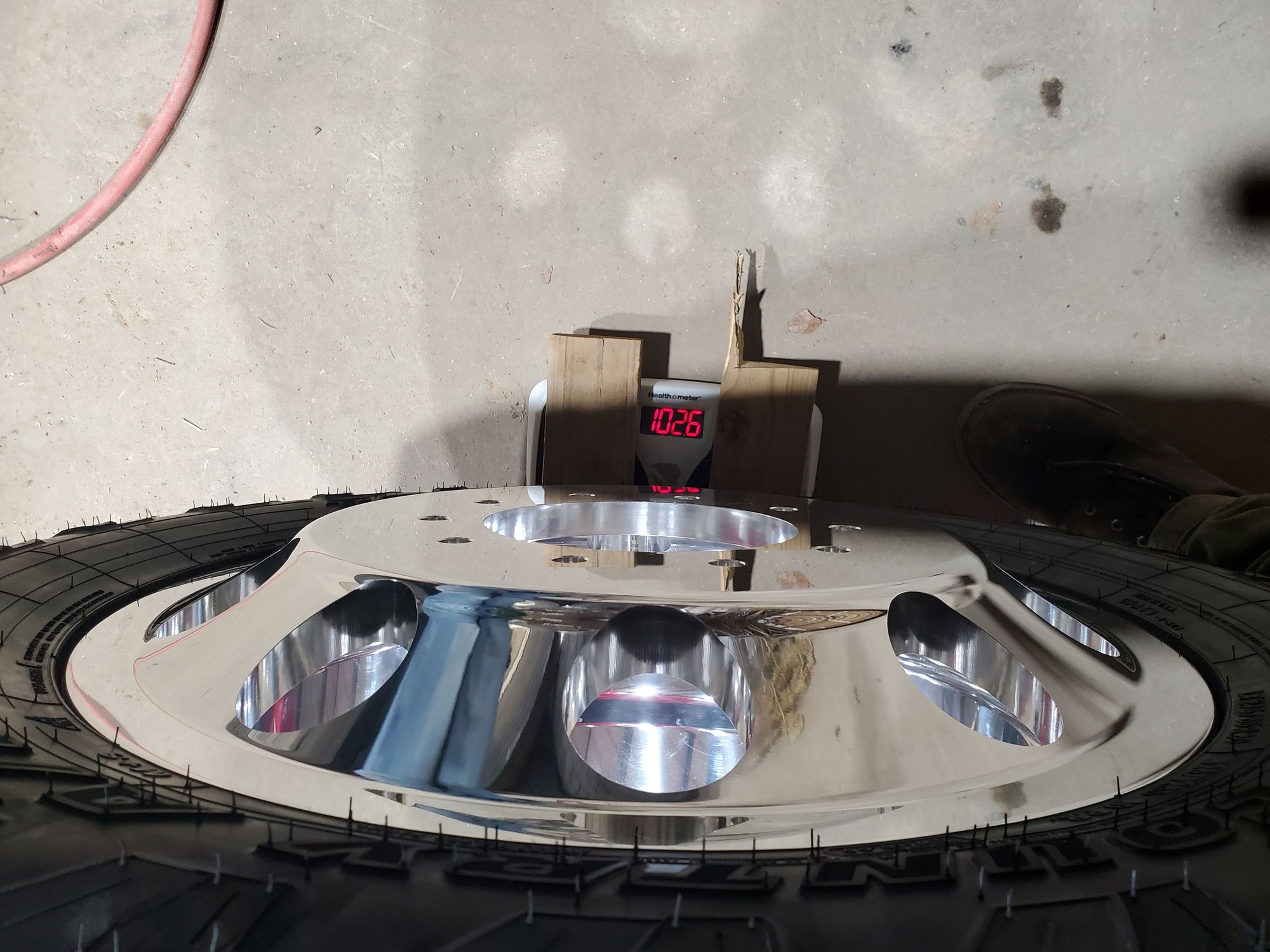

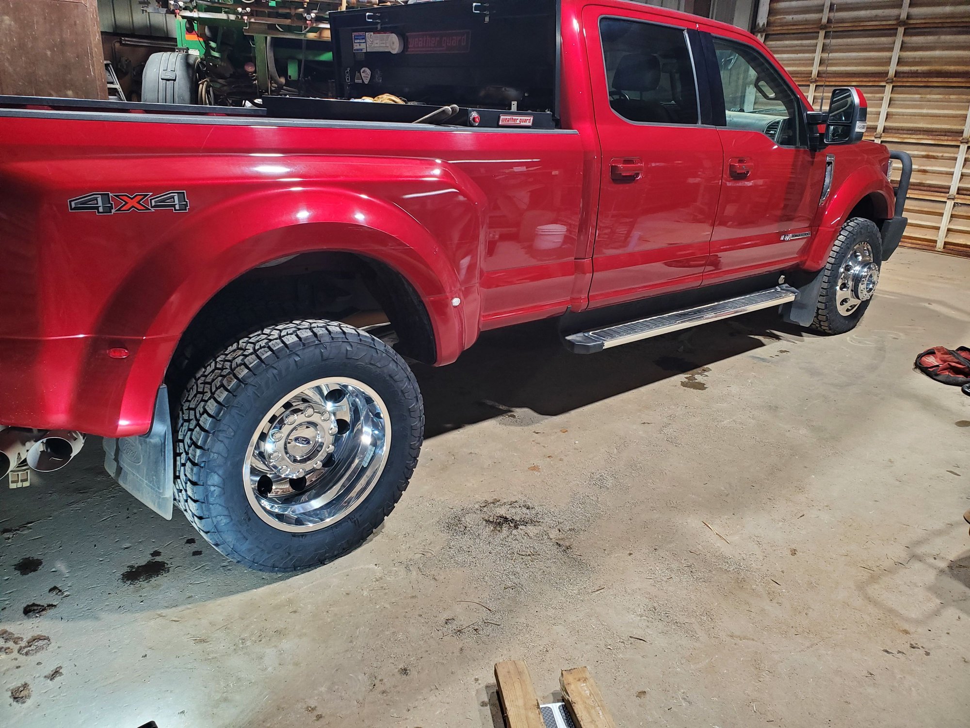

2022 F450 20" rim conversion complete.
I bought:
(4) JK Motorsports aluminum rims - $2,630
(3) TrueDually steel rims - $1,165
(7) 275/65R20 Toyo Open Country ATIII load range E - $2702
​​​​​​Total cost $6500

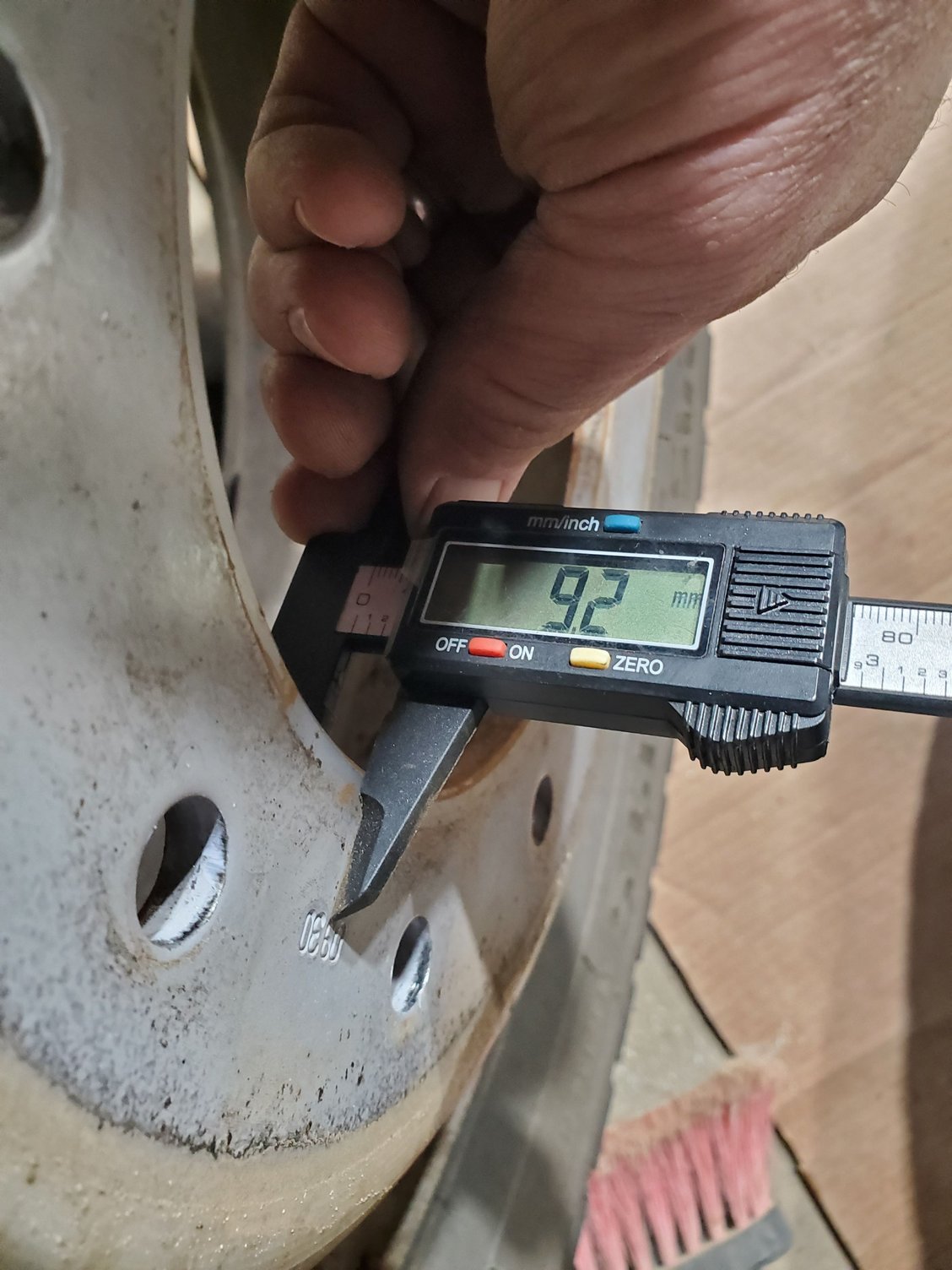

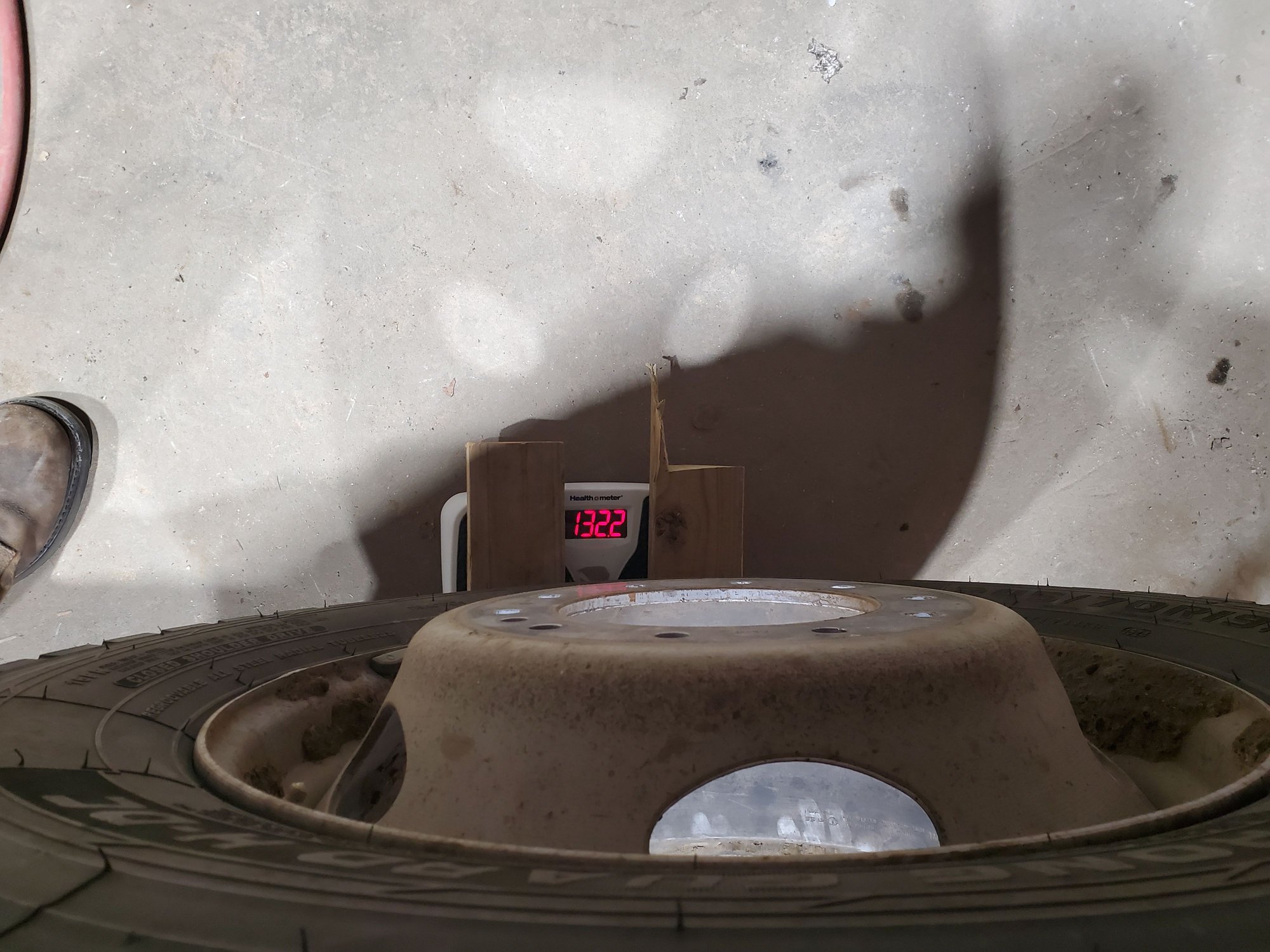

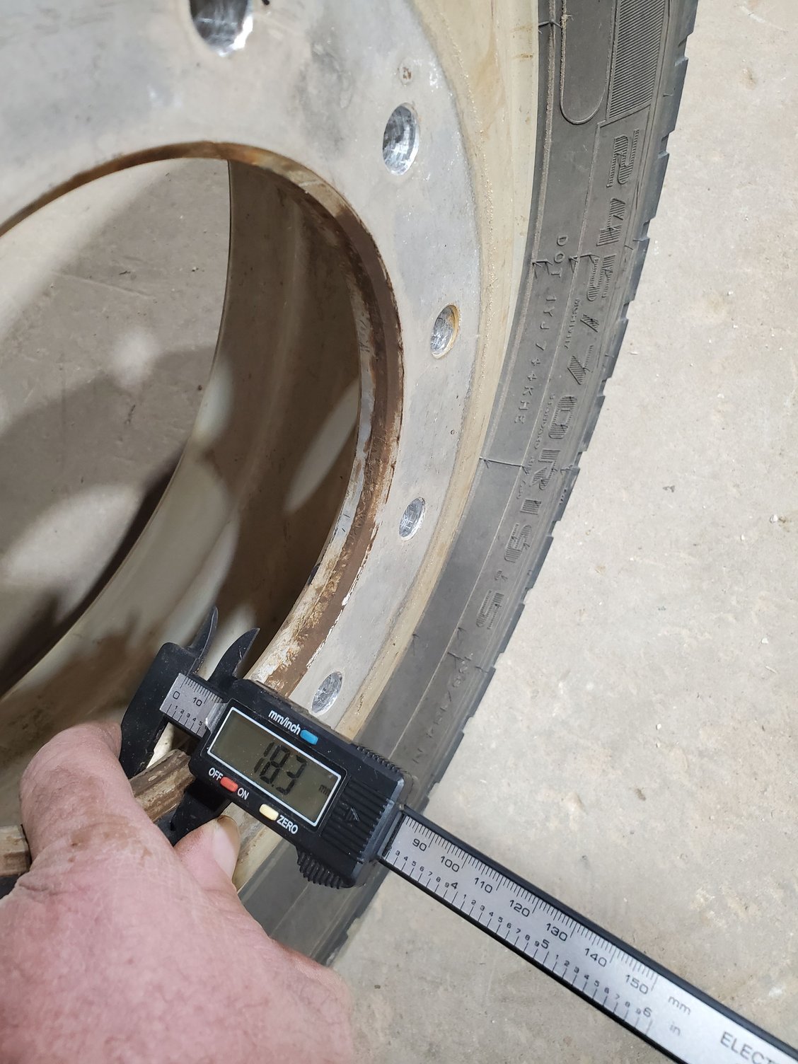

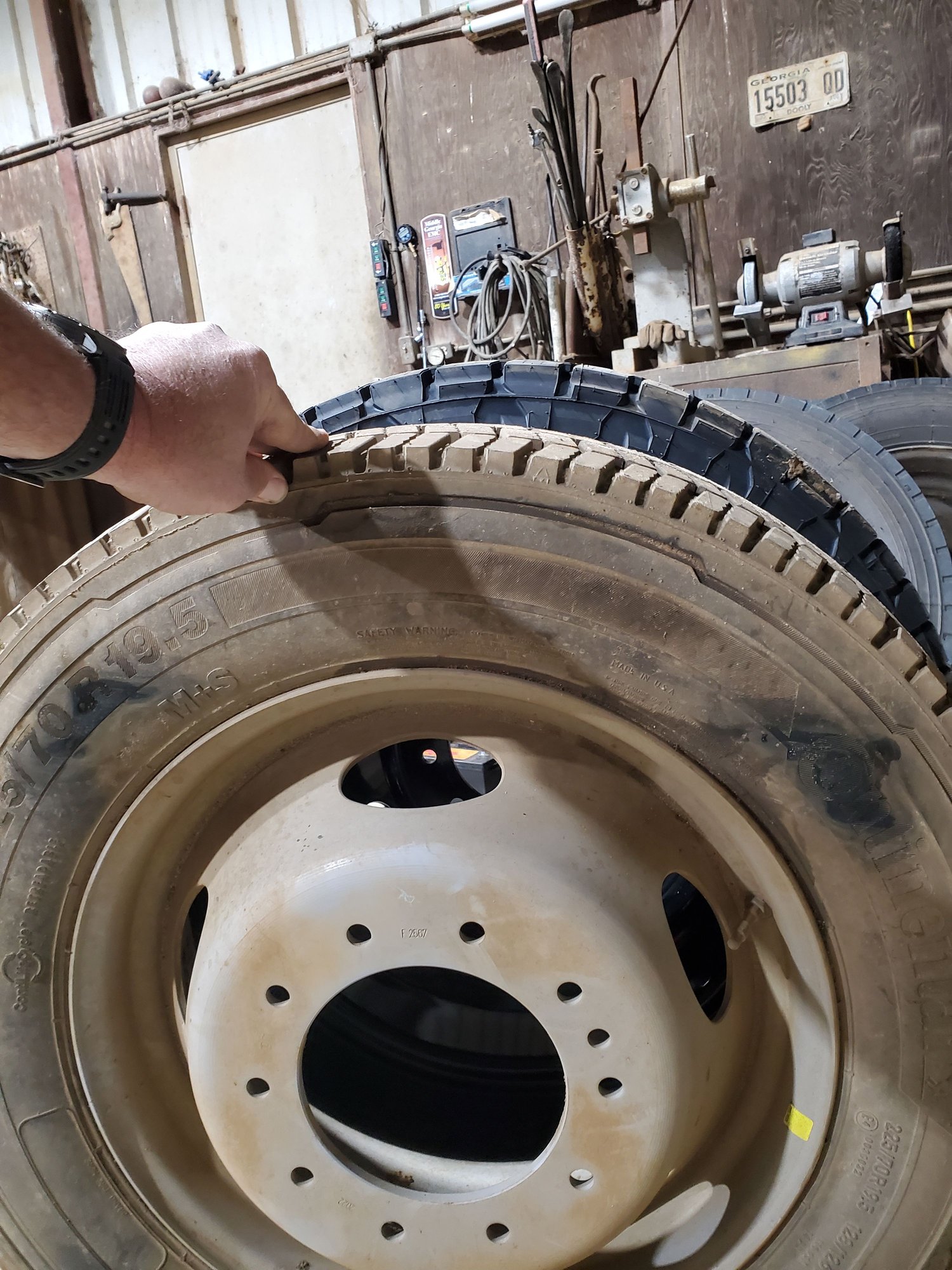

The 20" JK aluminum rims are thicker(22.3mm thick at hub), and heavier than stock aluminum 19.5s (18.3mm thick at hub). Despite that, the 20" load range E tire and JK aluminum rim combo weighs less than stock 19.5 aluminum rims and 245/70R19.5 tires.
Also, the 20" TrueDually steel rims are also thicker (11mm at hub) and MUCH heavier than stock 19.5s (9.2mm at hub). Despite that, the 20" load range E tire and TrueDually steel rim combo weighs the same as stock 19.5 steel rims and 245/70R19.5 tires.
The JK and TrueDually rims mount up perfectly to the hub shoulder with stock lug nuts and hubcaps. The lugnuts are fully engaged with thread all the way to the end.

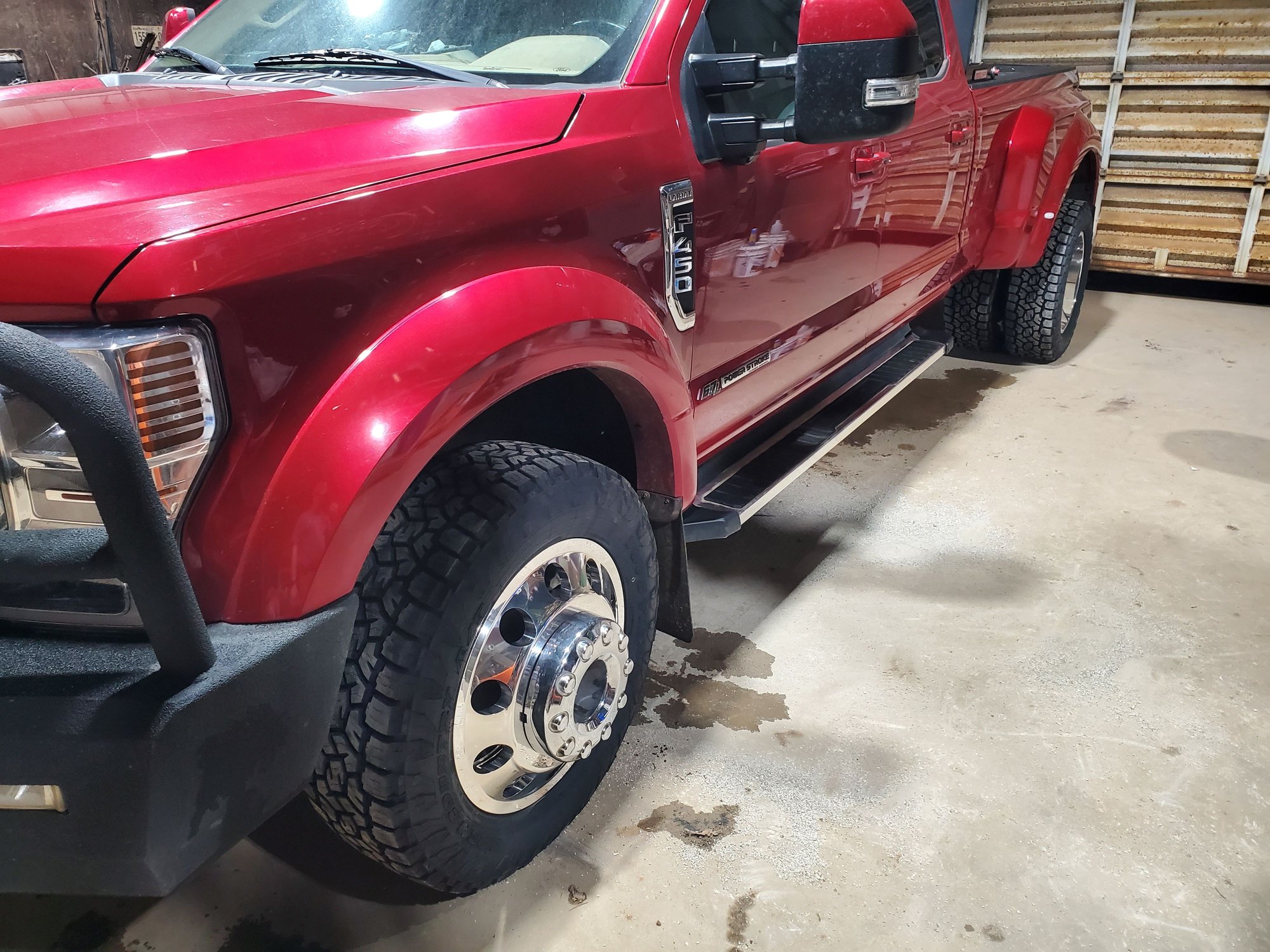

The new tires &rims poke out past the rear fender an inch or 2 with 275/65R20 tires. The front tires do not rub the swaybar in turns, nor do the rims grind on tie rod.
Also, the full size 20" spare tire fit perfectly under the bed.
I put a few miles on the setup, and all seems to be well. There is plenty of space between the rear duals to allow for larger tires if someone desired, but I would not do it. The toyo at3 275/65R20s are a decent comparison to the stock wheels and tires, and they do not need any lift or mods to make them clear.

Jk rims and 275/65R20

Truedually steels & 275/65R20

This is at 88mph on speedo.

Thanks for sharing and all the details. How are the outer duals balanced?
Stick on weights. Looks like crap.
