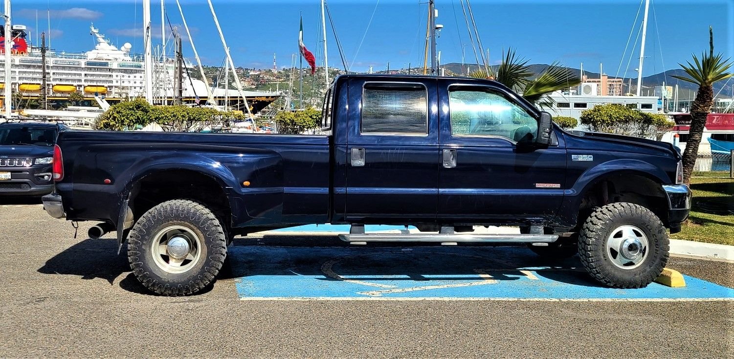

Question for those of you who have installed a transfer tank in your bed.. I have a 2004 F350 Dually and am going to install a 110 gallon transfer tank in it. I will be placing it on a 1" thick horse stall pad.
Here is the question. What size bolts do you use to secure the tank to the bed.
I know I know simple stupid question but here I am.
Picture for interest. Yes my Truck
