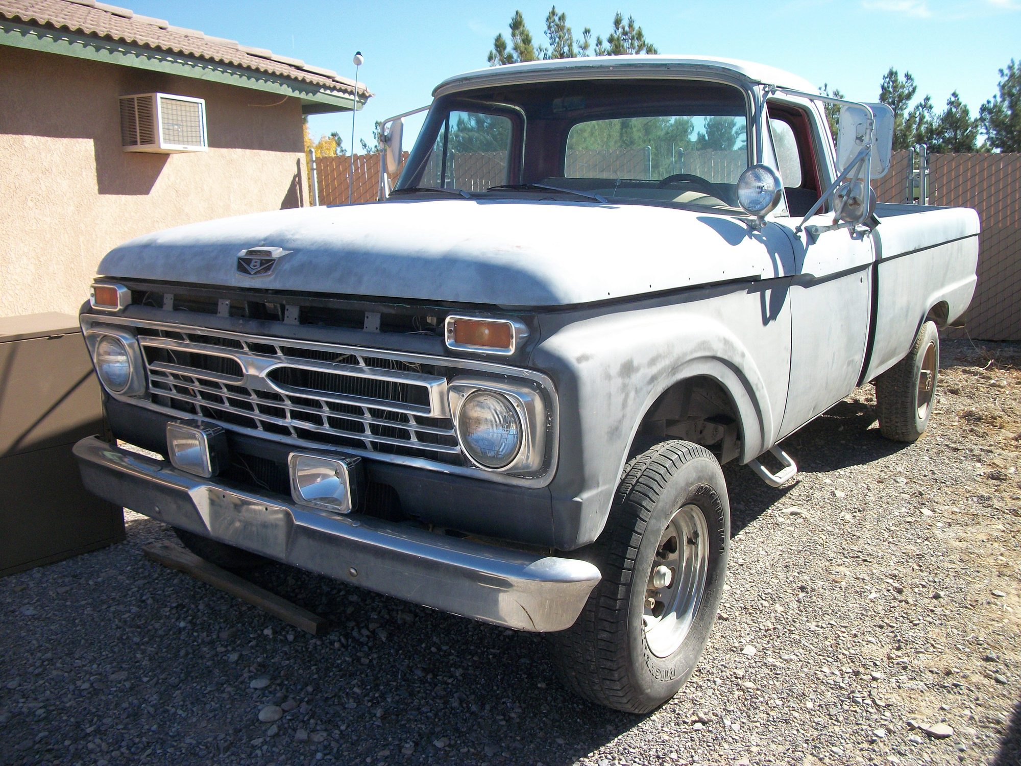

Here's a project that I bought from a fella that was storing this truck. He sold the truck with storage fees that accumulated over time and I jumped on it. A friend of mine did the work and some of it needs attention, It is a nice start. 7.3 idi with a turbo. It sits on a 86 frame
