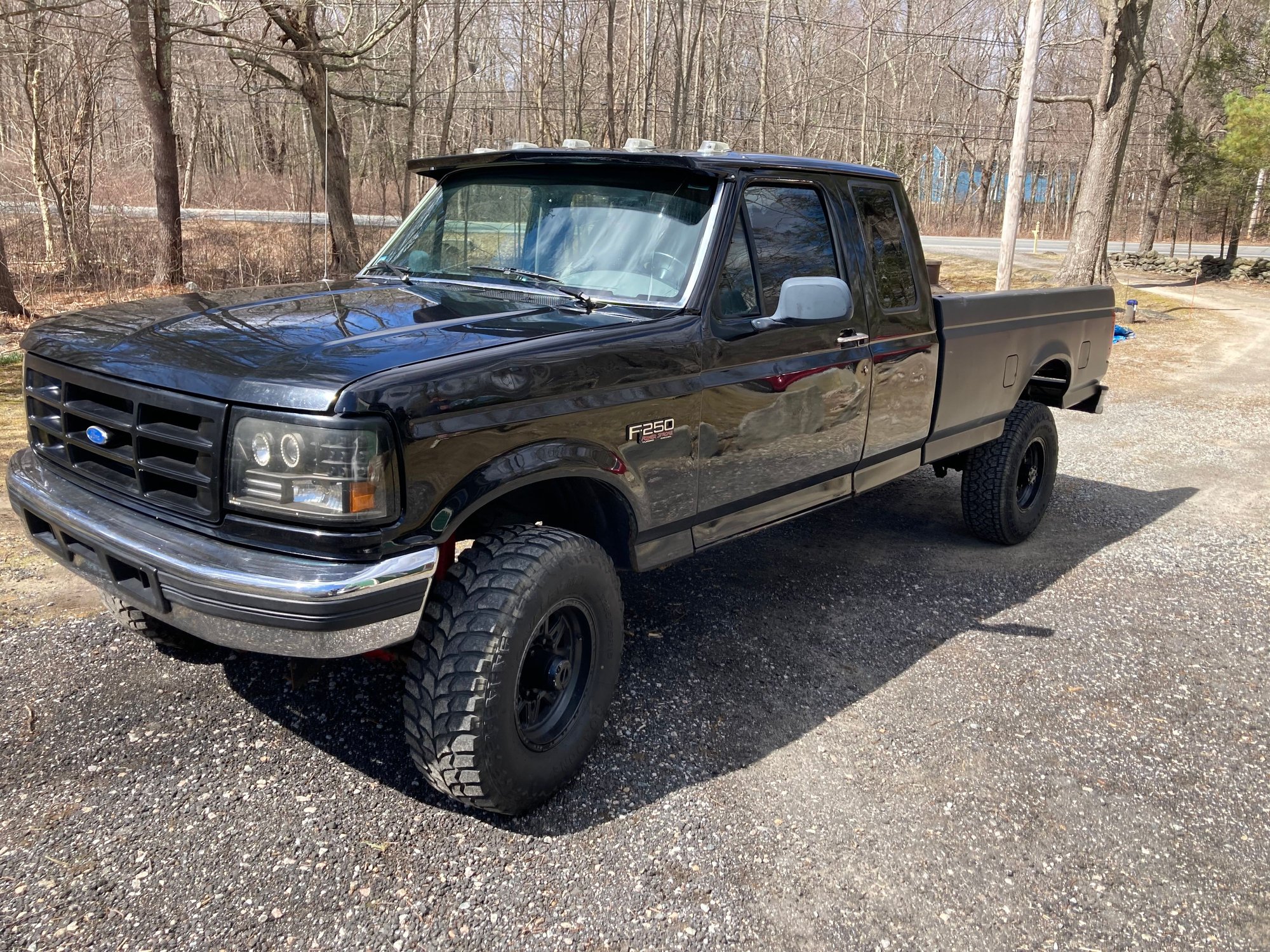

Hey everyone. I'm going to look at a 96 f-250 with a 7.3 and zf5 this weekend and I wanted to get some input from the collective on what to look for. The main thing for me is it has a fuel leak from one of the lines going to the fuel bowl (current owners description), anything I could bring with me to do a temp fix for me to get it back to my house for a proper repair, about a 30 minute ride.
It also had a SAS done with a D60, anything I should look for as a potential red flag there? Anything else I should be aware of, the truck has 207k on it. From the pics, the body and frame look good for a New England truck.
Thanks!

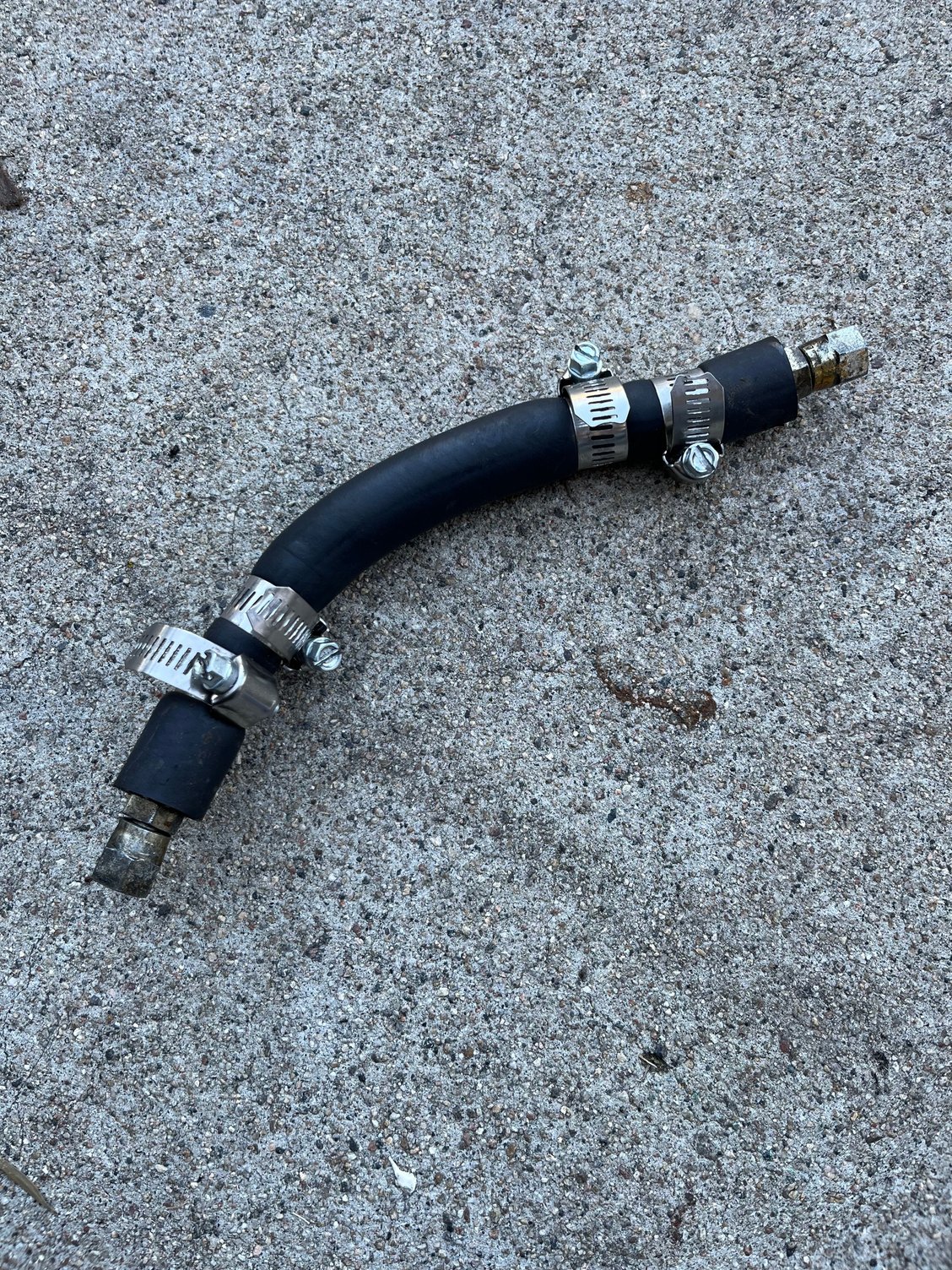

I agree with the fuel line recommendations. If it’s a return line, it could be a problem. I had one burst about 21/2” from where it enters the head and no one in area had a replacement line. I used 5/8” heater hose and 4 worm clamps to sleeve the passenger return line. Made it home 50 miles and ordered new ones from riff raff. I also resealed the bowl/fpr/all hoses to the bowl during the at home repairs. Figured while it’s out once, do everything I could. When my return line bursted, I lost gallons of fuel in matter of half an hour. I could see the gauge creeping lower and lower regardless of tank selector was on.
also added mechanical gauge to check the valley pump. Few npt-4an fittings and liquid filled gauge did the trick.
My temp fix!!

Thanks everyone for their suggestions,it turned out to be a blown return line so I used White95PSD's idea and got it home, no issues.
