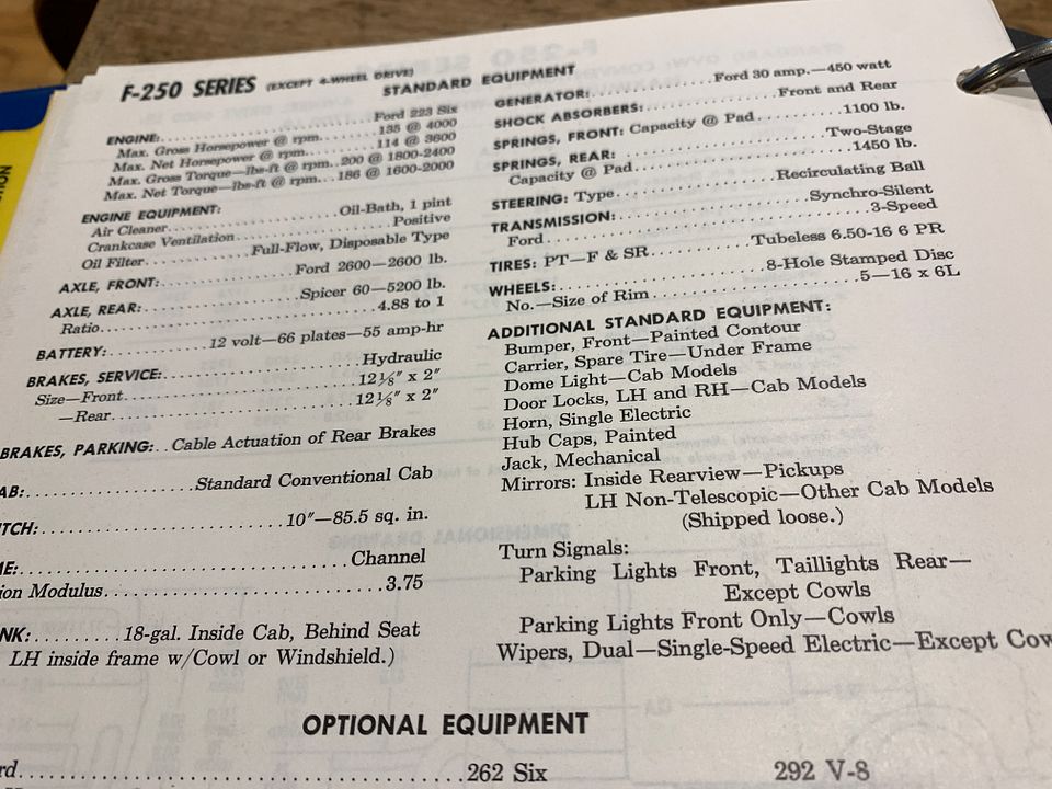

Here's info from the 1964 Ford Salesmans Facts Book for the F250 2 wheel drive trucks.
Painted
Or the Optional Stainless (Bright-Metal as they call them)

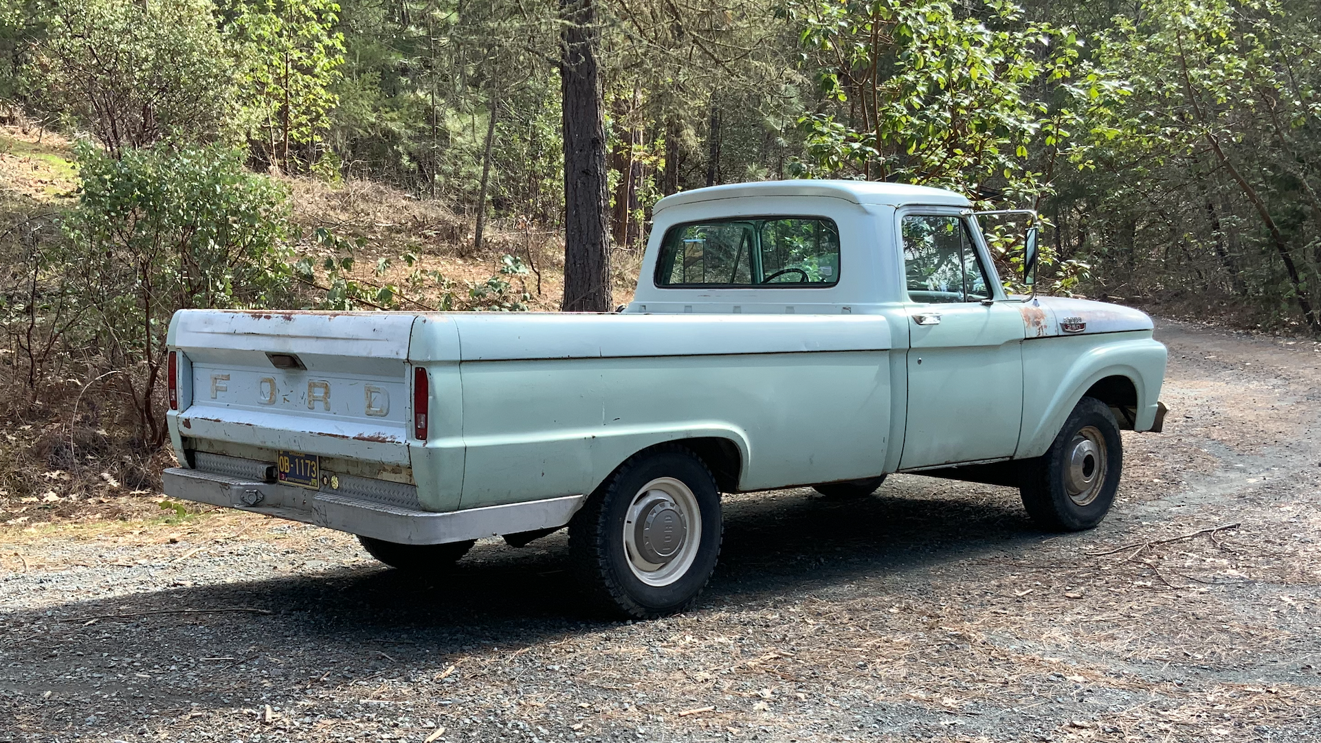

here's what's on mine and apparently someone just shoved two on that they had.
Front. Wrong. Maybe from Rolls Royce.
Rear.

Your rear tire has some dry rot cracking visible. If you are going to drive regularly and especially in rainy conditions, it might be worth investing in some new tires. Traction of hard old tires goes down dramatically. Just the other day I watched an old Mercedes with old tires get on the freeway just ahead of me in the rain, changing lanes to the second lane over he then lost control and spun back in front of me and hit a Toyota MR2 coming on the freeway behind him. Hate to see an old truck get into an avoidable accident....
You've got the good original 2-piece wheels with the inward pointing nubs to hold the original Type 1 caps like in all of the other pictures we've posted so you are set there!

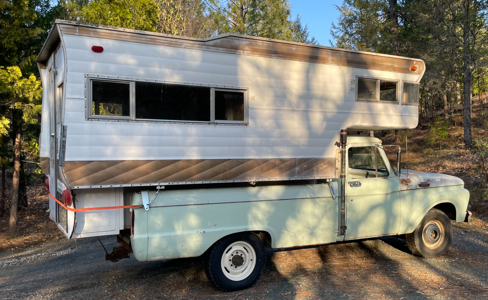

Here is my 64 F250. I picked up this camper last week and needed better traction to get to where it was stored, so I mounted up a pair of my original style one piece wheels with some new tires to go get it.... I have another 4 wheels and caps to mount soon so I can take off the Dodge wheels and International caps that are on the front now! Ha.
