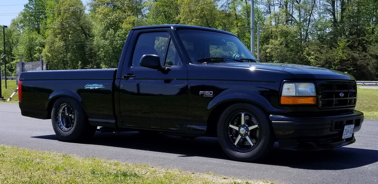

Some online research will bring up info on hard part upgrades needed. Really depends on the driver's foot and how the trans is treated for determining what's needed. I built the one I ran in my Lightning and installed just about every upgraded part I could find. My logic was if I destroy a clutch,that was easy to repair vs broken hard parts. Mine stood up to 8-900 hp just fine.

^^that is one mean lightning.

Talking about lighting there's a local vato that has an OBS lighting and that thing scoots, I don't know what he's got under the hood but by the size of the rear slick tire and him able to lift the front wheels with ease and leave you deaf on take off from the zoomies I say he's well over what my budget allows lol.
It was,long gone,sold it.
